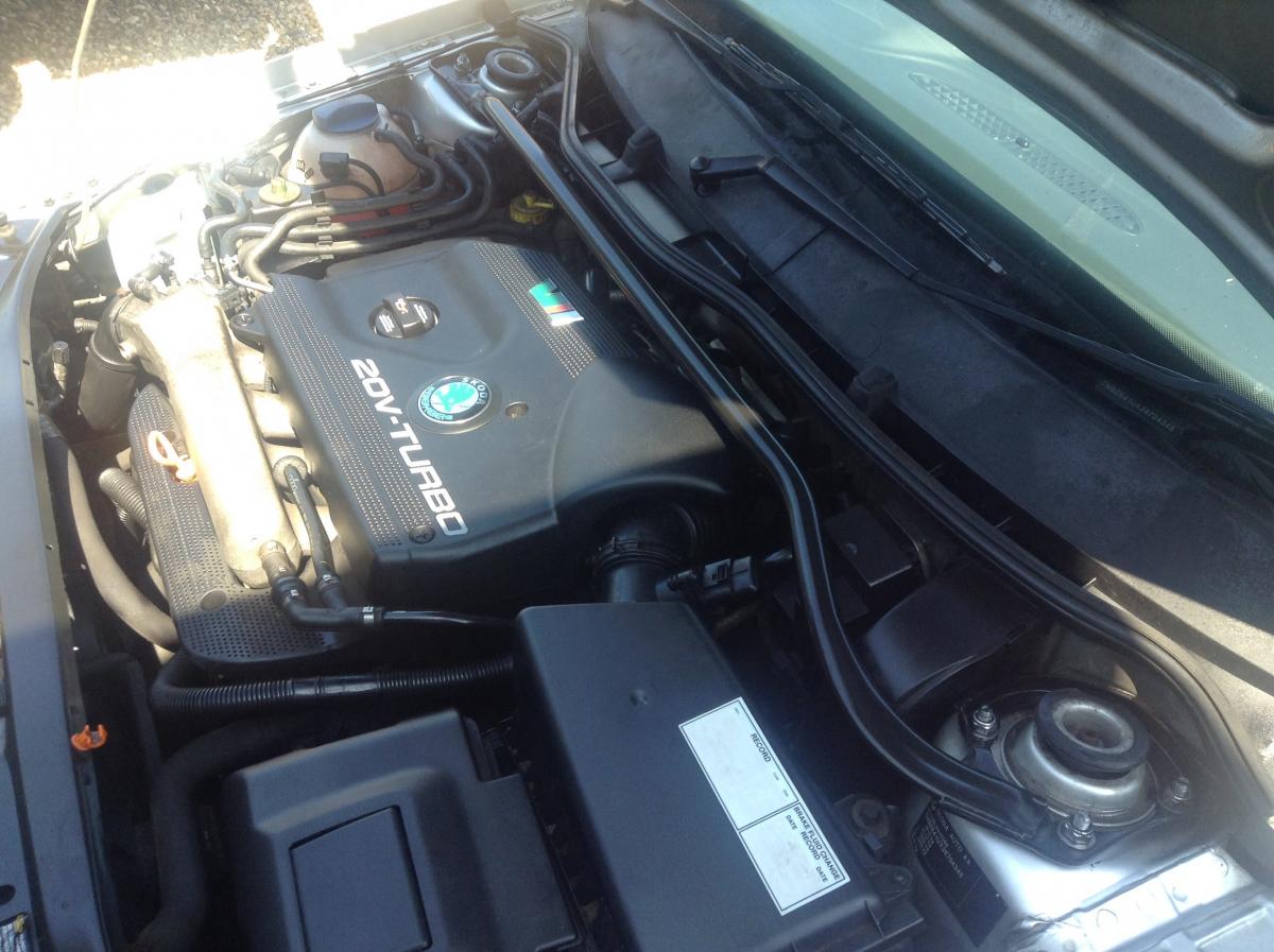

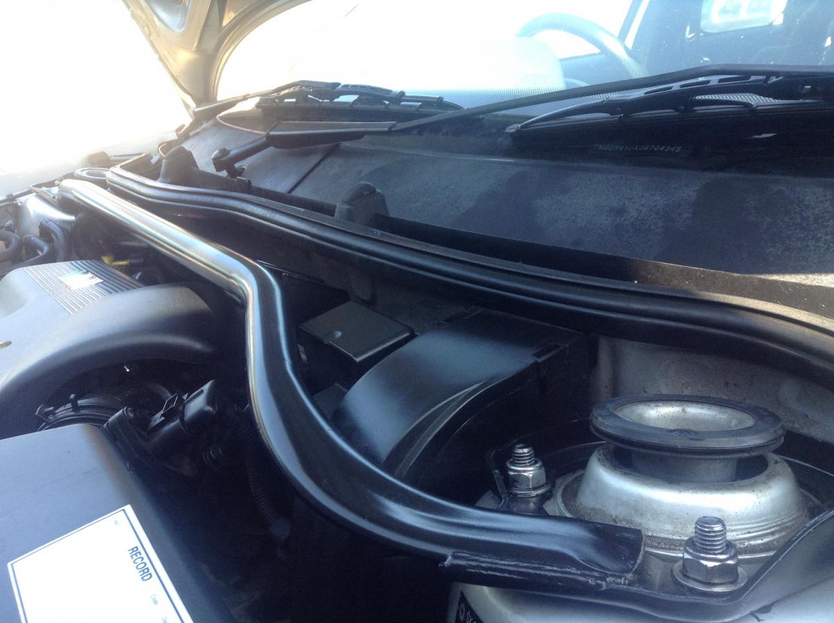

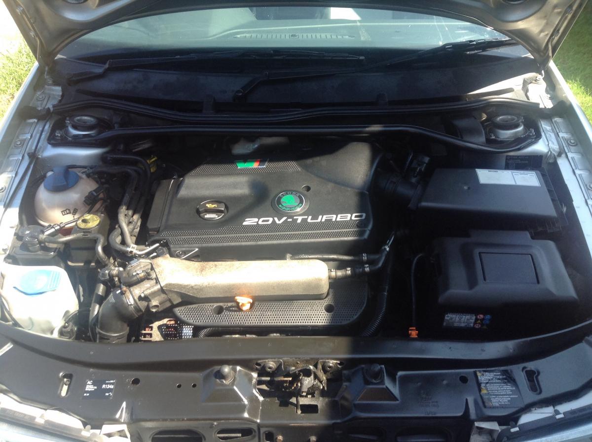

Ok so fitted the brace today, and am very pleased! All in buying the braces, nuts bolts washer new drill bit and centre punches was 37, so cant be bad. I know the guys who already have them will probably think this is boring lol. Heres some pics

I have had strut braces on all my cars and do believe they do firm up the feel of the car bud, and this has been no exception, the car certainly feels more firm steering around corners, but additional bracing such as arb and the under braces will be added for even more rigidity. For the money its worth it i think. Takes about an hour to do, the car needs jacking up each side when you are doing it but the wheels can stay on. A little hint i found is on top of the strut already there is a circle of spot welds, try and drill the fixing holes inline with the circle (not necessarily on the welds) because there is a cup with a lip beneath for the suspension. Drilling inline with the circle of welds makes sure you are within the lip. And as said previously i added paint to the exposed metal once drilled, but i popped the bolt through the hole to seal the underside and used a syringe to squirt hammerite into the hole around the bolt and then bolted her up. Happy drilling!

Cheers for the pics and write up matey? I had just ordered mine of eBay last night for £30 delivered. I'll see what condition it's in for paint but prob going to cut the tabs off and paint it anyway so it's nice and fresh.
Yours looks nice and tidy mate.

No sweat guys i left the tabs on mine as they are at the back and cant really be seen! Getting a socket on the nut below to tighten them down is a pain, but not impossible, i used a combination of extension bars and angle knuckle adaptors to get to them.
