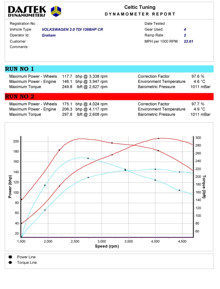

Had a look at the Celtic website...hmm, interesting!
I note that (like a lot of tuners) they quote their power increase on the basis of what a modded car achieves on their dyno vs the manufacturer's stock figures, whereas the actual gains against a stock car on their dyno are rather less.
E.g. the 170 upgrade plot here:
Skoda_Yeti_5L_20_TDI_CR_1968_cc_2009On_1
And the 140 plot here:
Where both standard cars make a bit more than the Skoda quoted figures (especially the 170!).
