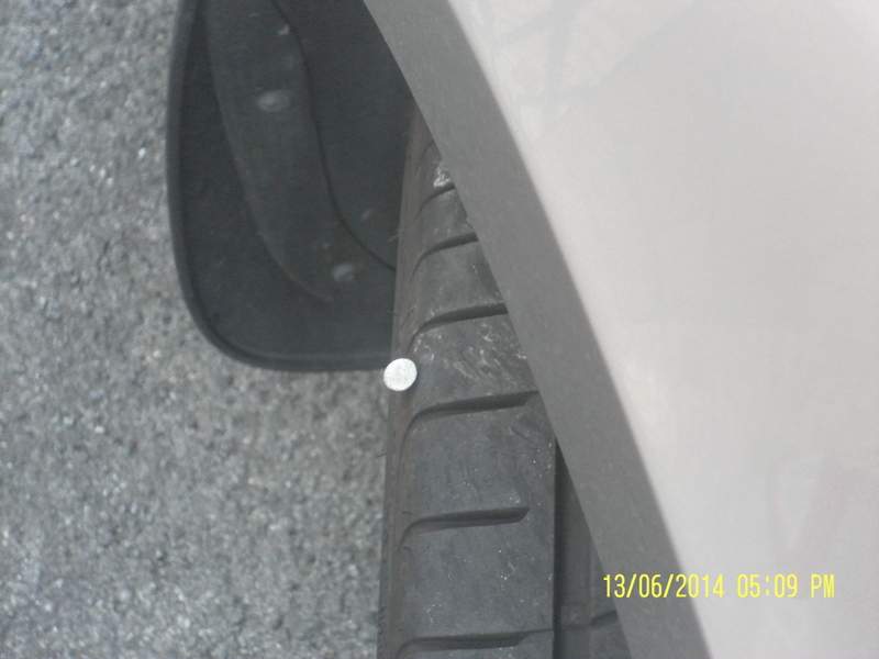

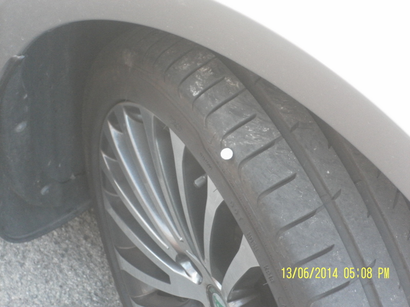

I returned from work in Abergavenny today, parked in the drive and saw this in the front offside tyre.  As it's in the sidewall, I'm sure it can't be repaired.
The front tyres were renewed only about 1,000 miles ago.  My biggest problem is that I'm going to Market Harborough in Leicestershire on Sunday and I'm not sure if I can get another Goodyear FI Eagle tyre tomorrow.
Ouch. That's not repairable unfortunately. Might be lucky and find a new tyre tomorrow
Sent from my Samsung Galaxy S5 using TapaTalk
That should not be repaired but some might.
Has it gone through i.e. is the tyre going down?
Yes, I thought it may be a small tack that hadn't gone right through the tyre, but as I started to remove it, air was coming out, so I put it back in quickly.  The local tyre depot is only a few minutes drive, so I'll ask them first when they open at 8:00 tomorrow morning.  As long as the tyre looks OK, I'll drive down slowly as it's only on backstreets.  If the tyre gets damaged, it won't matter.  Maybe I'll have to fit another make, but I don't want to if I can help it.

Hmm, with such a new tire I would ask the tire shop to plug it. Had it done many times with no issues what so ever afterwards ...
Just my 5 ... pence ...
Here in the UK they won't repair it, that'll be new tyre time I'm afraid.
Do not get that repaired it will be dangerous, it's in the most stressed area of the tyre, I currently have one about 3/4 of an inch further in the tyre myself and even that isn't really repairable,
Curve your hand as if you were holding a small beaker, then imagine a flat plug patch trying to stay stuck on around the area of your knuckles.
I've been to our local tyre depot and they can repair it!  But it's a specialised repair that has to be sent away and that'll take about 10 days before it's back.
I've bought an Avon ZZS for my journey tomorrow and Monday and I'll change back to the Goodyear when it's been repaired.  I'll keep the Avon and then buy one more when the rear tyres need changing.  I'd have preferred to keep all 4 tyres the same, but I'm not too worried so long as both axles have matching tyres.  It's like that now with replacement Goodyears on the front and the original Continentals on the back.

If they can send it away and get it repaired do that and keep it for next time assuming they don't need the wheel as well.
Yes, I asked them to send it off for repair and they'll give me a call when it's returned.  I want to put in back on the front when it's been repaired so I've got matching tyres on the front axle.

£30.00, including refitting and balancing.  I had it done first thing this morning at Ian Jones Tyres in Brecon and I'd recommend them to anyone in the area.
Not cheap, but better than throwing way an expensive tyre with only 1,000 miles of wear.  Anything much past 50% worn or a cheap tyre and it wouldn't be worth repairing.
