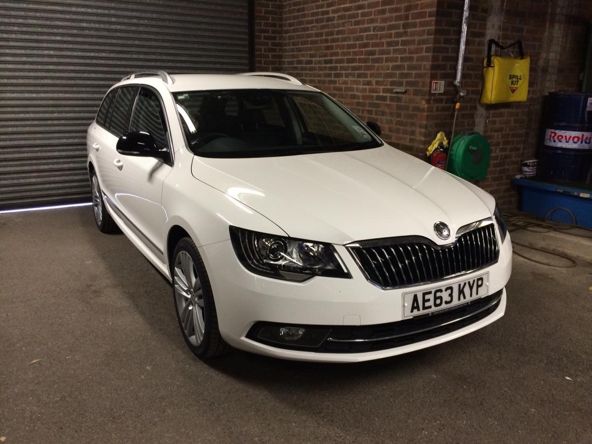

I've always hated the ride in my FL Superb. It was skittish over bumps and manhole covers and the car was prone to swaying left/right on uneven roads and during lane changes. Couldn't really find the smoking gun as there wasn't anything obviously wrong with the suspension - just a crap setup I think.
Eventually I just had enough of it and had the standard Monroe shock absorbers ripped out in favour of a full set of Bilstein B6 shockers.
I can confidently report that it has utterly changed the characteristics of the car. Lane changes are now a positive experience, the rear wheels no longer feel like they they are bouncing off the road through potholes and sunken manhole covers.
All of my passengers have commented on an improved ride as well, especially in the back.
The ride is slightly firmer now but it is still miles short of SWMBO's MkIII vRS in terms of firmness. It also no longer wallows through those large undulations you get on the motorway.
Cornering ability is massively improved and heavy loads in the boot are less noticeable.
All in all I am really pleased with the Bilsteins, I fitted them to my last 3T5 Superb with good results too.
Other than the ride issues i've had, I'm still loving the Superb immensely!

Fitted the B12 kit myself yesterday and I must say with the limited mileage that I have put on them .... i am impressed  :thumbup:
How was the ride with this kit fitted?
I want mine lowered, but its still got to be a comfortable ride for the family
Ride is much improved, no it doesn’t soak up all the potholes (will anything?) but comfort has not been compromised one bit.... even considering it is now 30mm lower.

Hi, any pic's after the 30 mm drop?
I will take some at the weekend once the wheels have come back from the refurbers.
B12’s: (-30mm)
