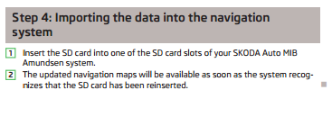

The latest Amundsen manual says it must be in slot2 to function correctly. Just shows how reliable Skoda manuals are.
Taken from the manual, page 46
