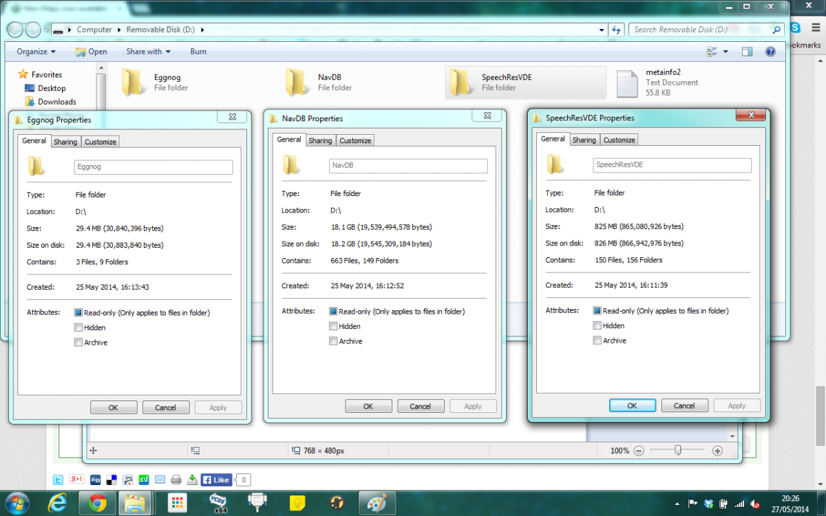

@All - could someone check their card in a PC and do right-click / properties and post up how many files and how big please ?
Thanks.
EDIT - could someone also check if their card has a volume label ? - Again TIA.

Card has no volume label, it's an 8GB card, 6.81Gb used File system FAT32
Label on card has Navigation SD card Europe (V2), 203113, 5EO 051 236C on it.
Root of card has one folder "markets" and one text file "DBInfo"
In markets is one folder "eu"
In eu  are two folders "map" and "vde"
There are loads more folders, but hopefully this should help out.

Can you post a screenshot of the folder structure on your card and also the properties of the card, similar to this screenshot which is for the Columbus.
I stopped doing that earlier, I just wanted to compare what is on my original card with others to see if something is borked.
This is what the original card looks like with the downloaded files attached and it formatted using Windows in Fat32.
