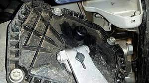

Not sure if this has been discussed, but the OAM gear box (7 speed DSG) should have a mechatronic oil change every 60K km.  Easy to do, 1.7L of fluid, sump plug below tighten to 30Nm and the oil is refilled via breather plug behind battery tray.  Takes 15 minutes.  I'd recommend that is changed.

It's more like 1 or 1.1 litres.
I changed mine a couple of years ago.
Was very dark. Still didn't prevent the body of the mechatronics from cracking and it needing to be replaced and the mechatronics being rebuilt 🫣
