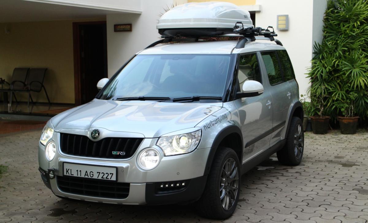

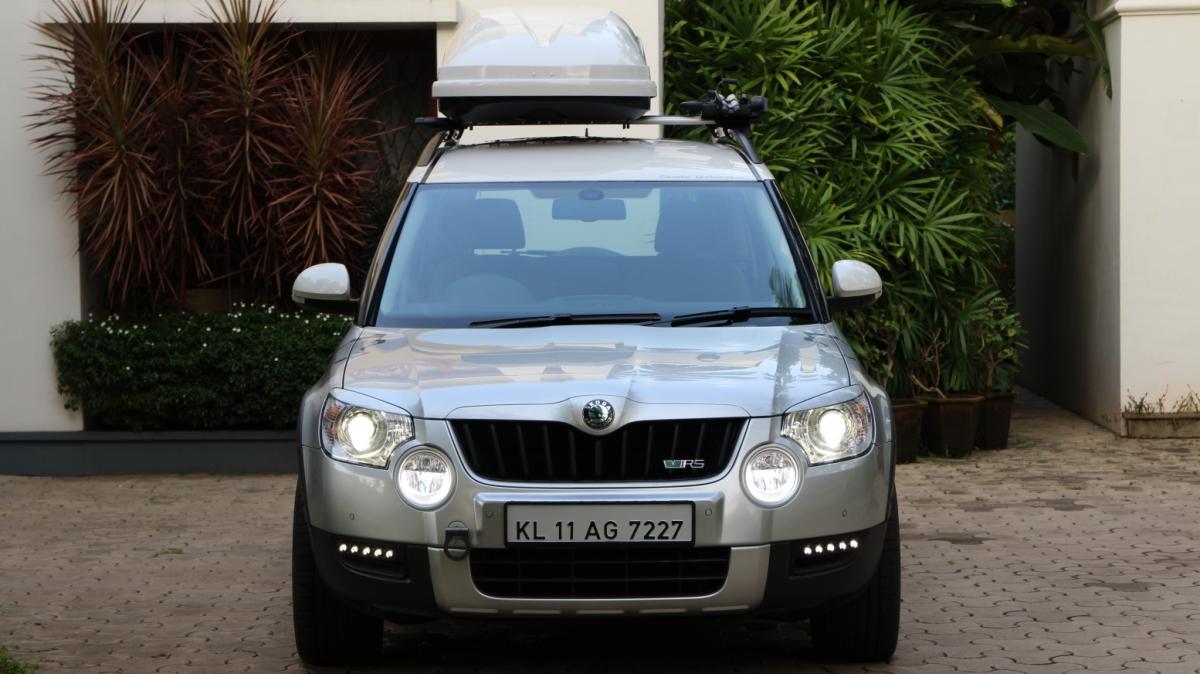

Enough typing and now lets see some pics!
%7BfileStore.core_Attachment%7D/monthly_07_2014/post-72409-0-02096000-1404566263_thumb.jpg
%7BfileStore.core_Attachment%7D/monthly_07_2014/post-72409-0-49538600-1404566305_thumb.jpg
%7BfileStore.core_Attachment%7D/monthly_07_2014/post-72409-0-65040000-1404566339_thumb.jpg
%7BfileStore.core_Attachment%7D/monthly_07_2014/post-72409-0-40184200-1404566371_thumb.jpg
An earlier pic with my bike on top
