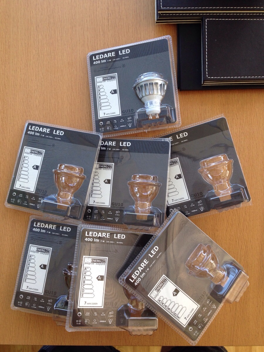

I think the house was feeling a little bit left out what with the Superb's LED bulb upgrades so....... Six 50w halogens replaced with six 7w LED spotlights. And a spare just in case. :) :) :)

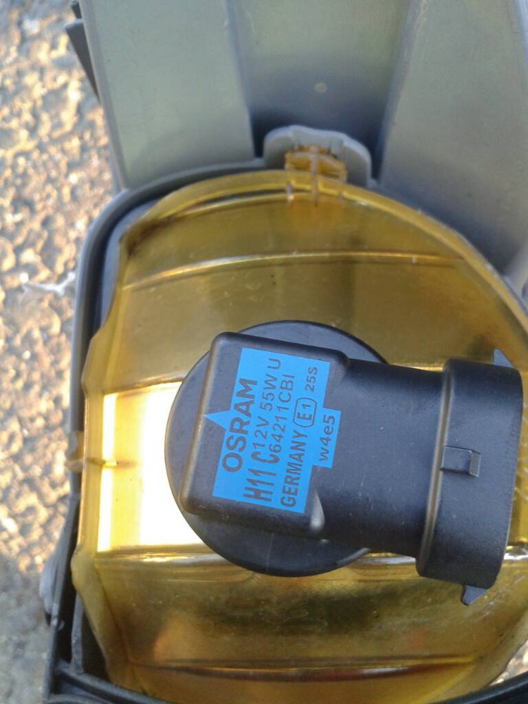

Donnt go for the Nightbreaker, take H11 CoolBlue Intense rather.
H8 is a 35W bulb, H11 is a 55W bulb, but it will fit in fog lamp housing and work very fine...
For comparison, O2 vRS FL is using in fog lights HB4 type of bulb. I fitted there also CoolBlue Intense HB4 (60W), and work 'xenon white':)

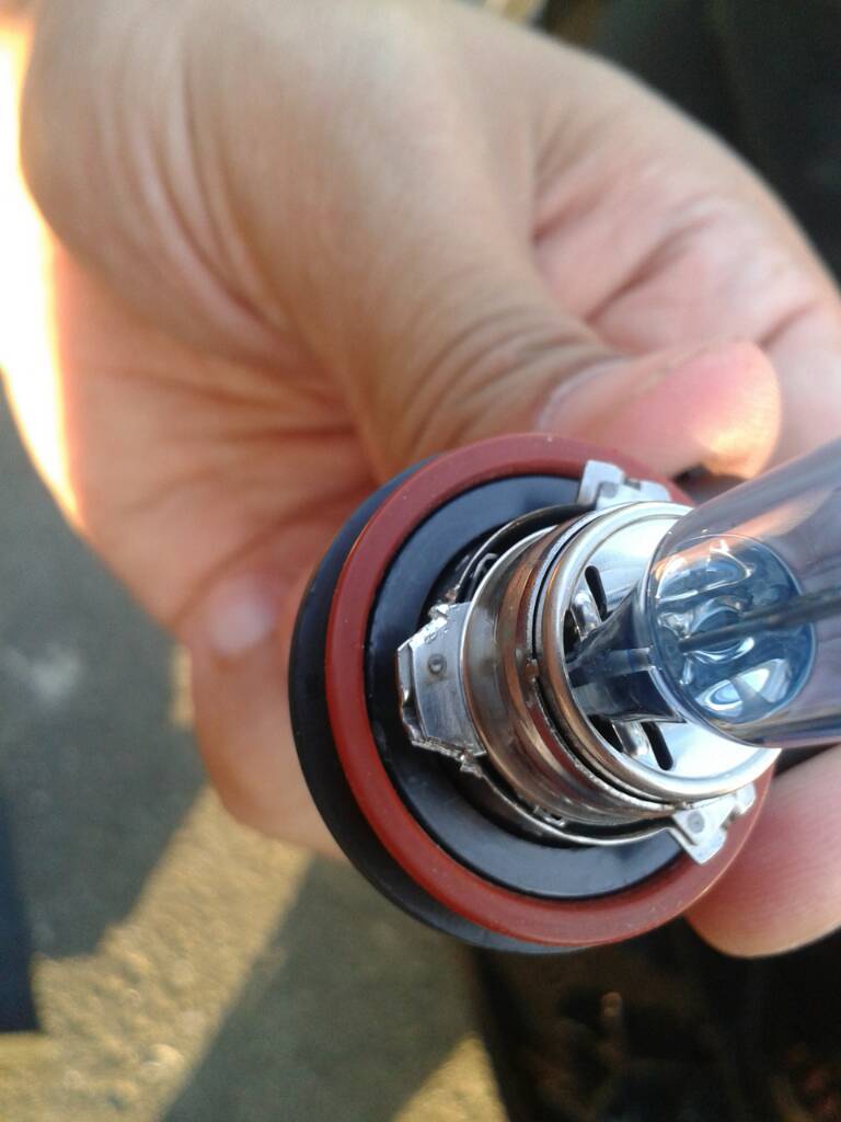

I thought you had to file the fitting down on an H11 bulb to get it to fit in an H8 housing??? That's what i've seen online before. I'll settle for the OEM bulbs i think rather than messing about filing H11s down to fit.

See here:
Cut 1mm of edge (just edge) on a bulb housing (only one of the three metal holders) with cut-pliers and you can fit it faced down, no problem about that, without damaging bulb itself or housing that could not be used sgain (or in H11 or H8 lamp housing).
