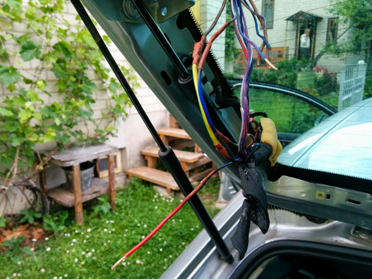

Issue solved. How it looked:
I was able to open only in sedan mode. So had to take plastic covers and take two bolts out of that twin latch mechanism, then slightly use force to open in hatch.
I fixed it in this way, all 10 cables. Used 0.5 mm and 1.5 mm wires:

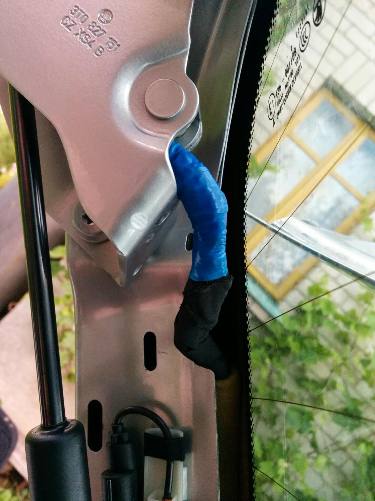

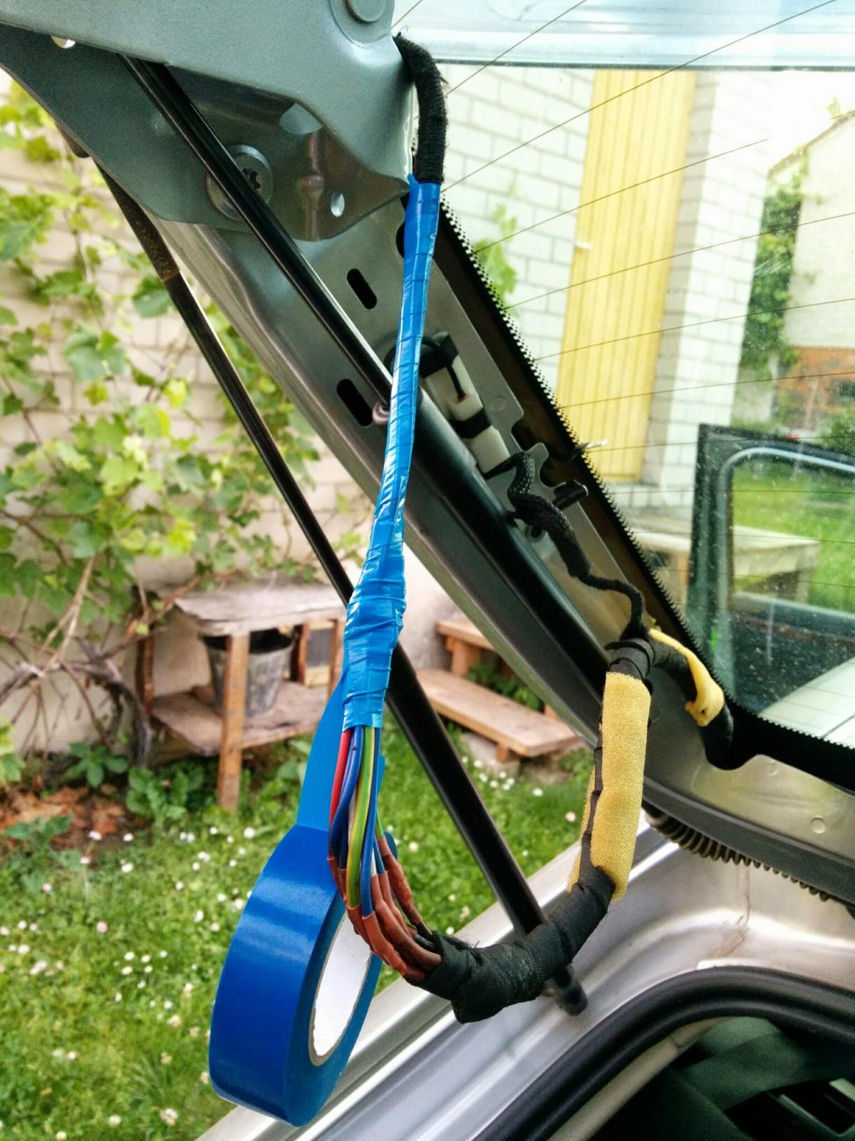

Isolated with tape:
and put it back:
I took ~2 hrs and 1 beer can. I had no more time, so fix isn't perfect. Did no soldering and no aditional protection from bending. Will see how long it takes to break again. Difficulty: easy. Money spent: 2 eur. for wires, thermal insulation and tape.
