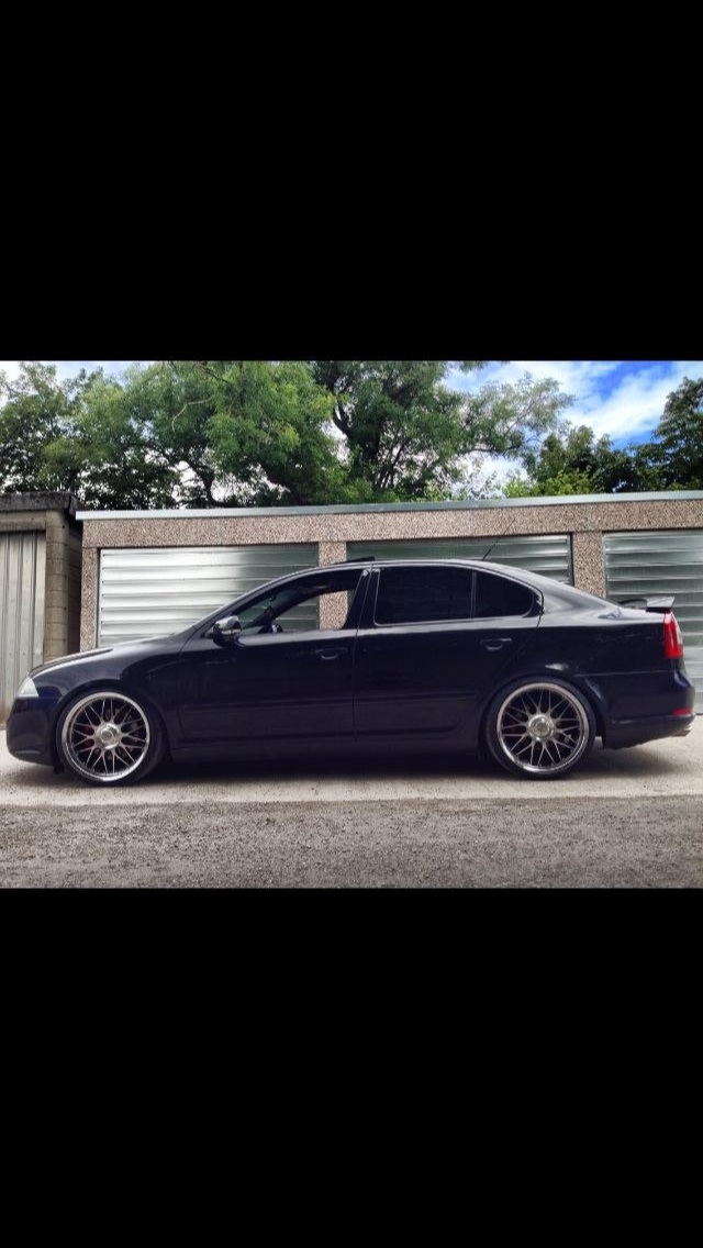

That someone was me, those Speedlines fitted on my VRS but had to roll down the arches.
I'm now running on 19's 8.5Jx19, ET35 all round with no issues. I've fitted 215/35/19 on fronts and 225/35/19 on rears.

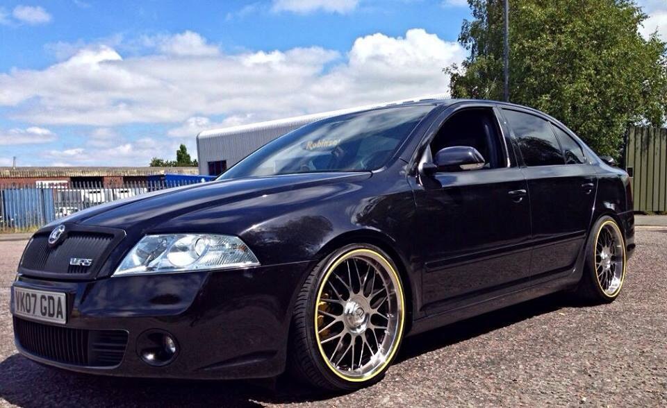

That looks horrible.  The tyres aren't even probably seated on the rims.  I'm astonished that any reputable tyre fitter would 'fit' those tyres to those rims.  You actually drive on the road with that set-up?

I know it's not to every ones liking, But yes, Driven daily.
