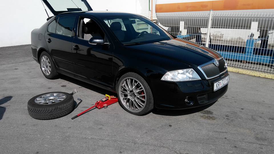

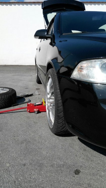

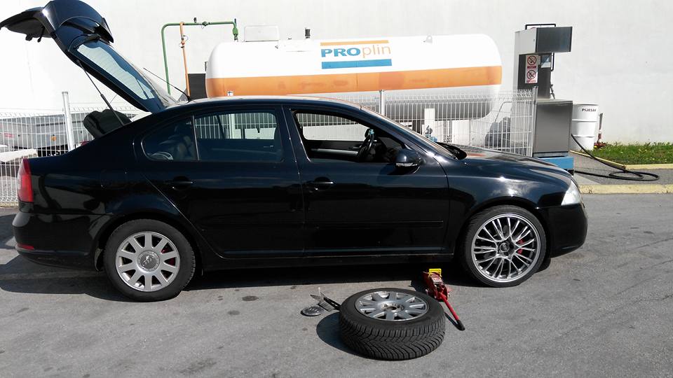

Right lads I've picked up a set of 19's which I'm refurbishing and have just test fitted. They are 19x8.5 but a low offset of 32. I'm currently running lexus alloys at an offset of 42. They are 235/45/17 and sit nice and flush with the bodywork however when buying the 19's I couldn't remember what offset the 17's were. Anyway test fitted tonight and the rear rim pokes out past body work 5mm

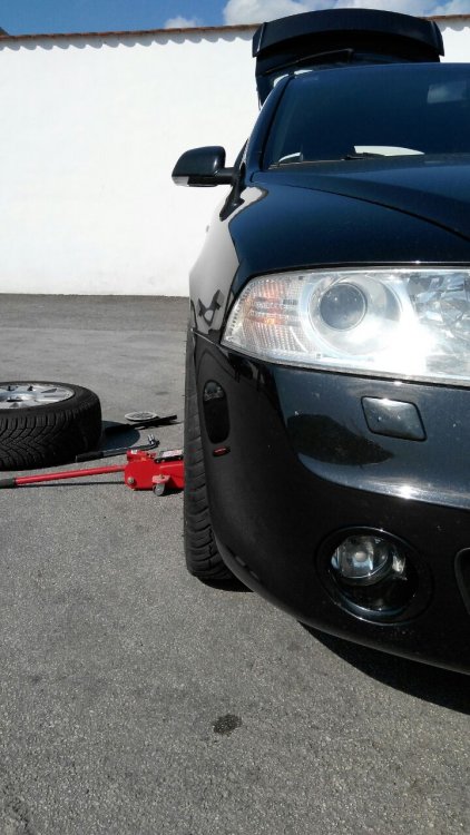

And the front pokes out about 7mm
Was thinking of putting 215/35 or 225/35 as would give a bit stretch.
I've checked on willtheyfit.com and the 225/35 will give a 3mm smaller difference on diameter but I'm worried about the rims actually poking past bodywork. I'm not really up on wheels but are these dangerous to run ? Any thoughts would be well appreciated, cheers Davey

Compared your 8,5x19" ET32 225/35R19 combination with mine 9x19" ET41 225/35R19 on willtheyfit and i suspect that on rear you will be fine by turning some camber on it. On the front you will probably catch on the uppermost screw that holds the inner fender but you can remove that screw to get rid of the problem. I don't think you need to flare the fenders in the front with that -50mm lowering kit. If you are thinking of putting 215/35R19 tyres, please bare in mind that those tyres load index is not big enough for Octavia.
