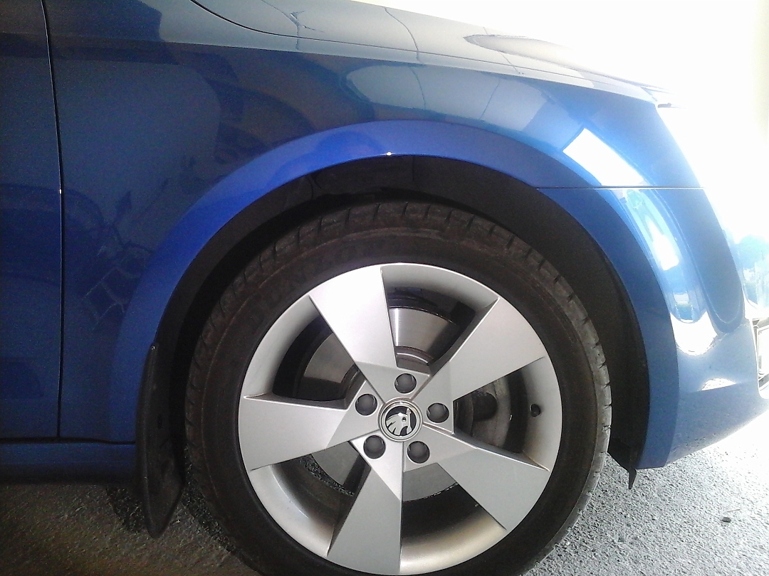

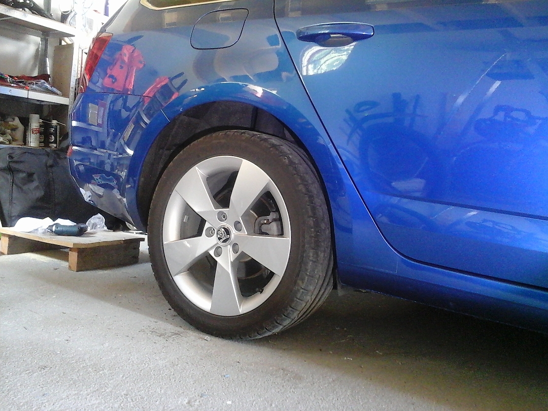

H&R offers lowering springs that will lower my 1.8 estate 4x4 by 40mm.
What do you guys think about the looks of 40mm lowering? Is it too much?

my car is ca 38 cm from the senter cup up to the weel arch. I guess the car will look and handle fine with the H&R springs.

I know for sure that it wasn't ordered with the rough road package, but it seems a bit high.
I meassured from the ground and up and it was 68,5 and 69,5 cm.post-109242-0-19009600-1406199192_thumb.jpg

Could somebody please do me a favor and meassure their 2wd from the ground up to the weel arch or from the senter cup and up so i can compare it to mine?
I have a 1.8TSI DSG FWD I can measure later. The 4x4 Ive spotted are visually higher than mine though, so I'm fairly confident that they are higher as standard. Anyways except a harsh ride from that thing if you drop it by 40mm. I have owned other cars that became very hard once you drop them that much.
