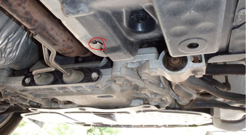

Just as I finished the job I noticed whilst cleaning up that the passenger footwell was a bit damp - bus since we'd been in the car with wet feet I didn't worry too much - plus it was getting dark.  A bit of forum browsing and I was straight out in the morning for a closer look - and it was more than just damp - if I pushed down on the carpet my hand was in a puddle of water!  The driver's side was damp too.... why oh why did I get the sunroof?
To try and keep this short I ripped the passenger foot well apart and traced the water to a blocked a/c condensate drain - and think I fixed it - but was hoping you could help confirm that its now dripping from the right place.  I've circled where it dribbles in the attached - it was expecting it to be straight from the drain pipe - but it seems to come out of a chassis drain hole - is this normal?
