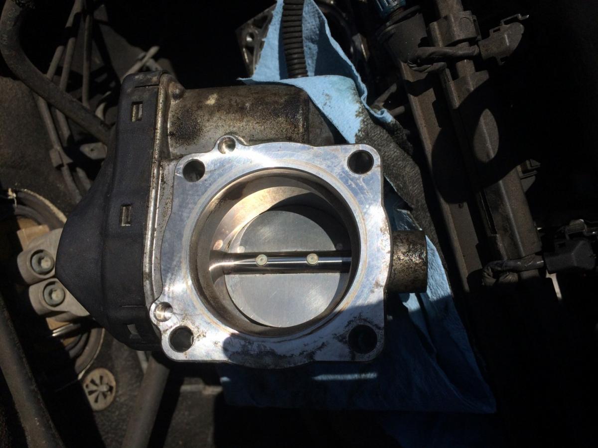

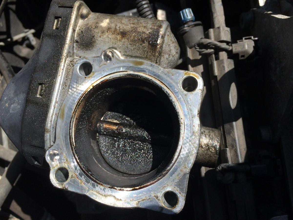

Lifted it off without unplugging. Glad I did, a clean was very much needed!
Before and after...
Good god, I've never seen one that bad! Bet your plenum is filthy inside as well as the EGR pipework, consider fitting a catch can if your engine is breathing that heavily.
