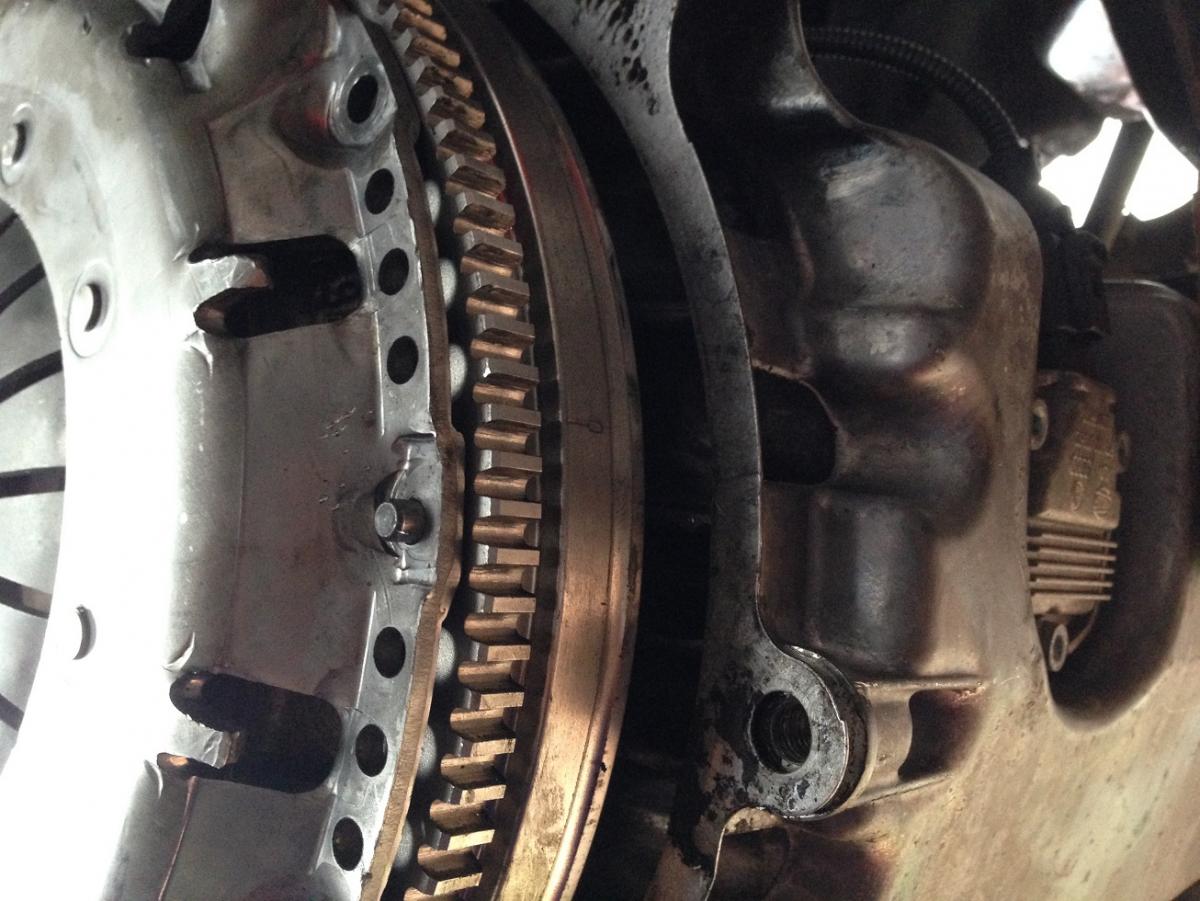

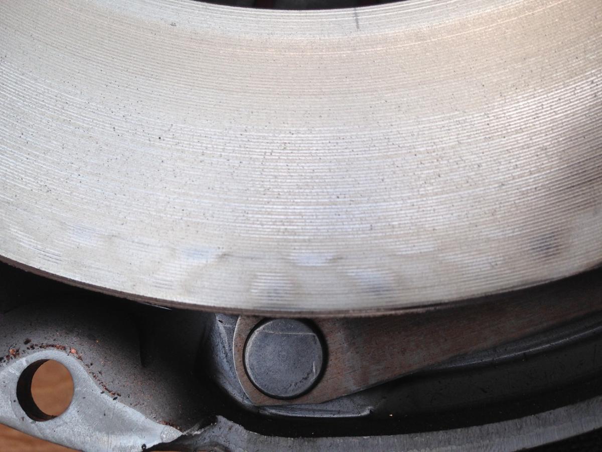

But there is no problem to put any gear in. Anyway i will have to take the gearbox out and i think i know where the problem is. When the garage called me to have look when the gearbox was out i have seen that the mark on the flywheel is not exactly in the centre ot the 2 teeths on the release plate but closer to one of the teeth. So now it is out of ballance and the clutch is kicking and shaking when engaging. Forgot to say to mechanic so will do it mi self.

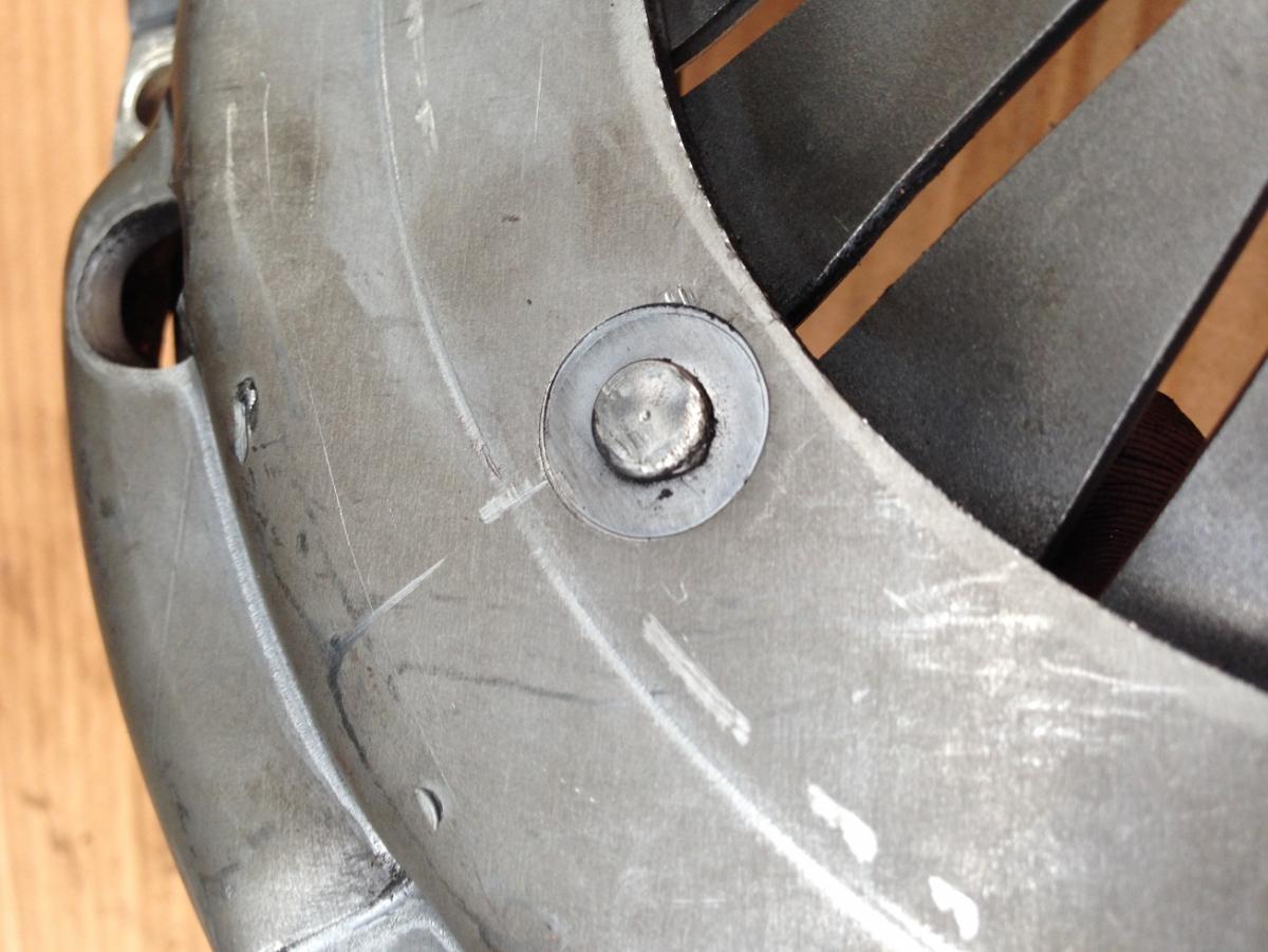

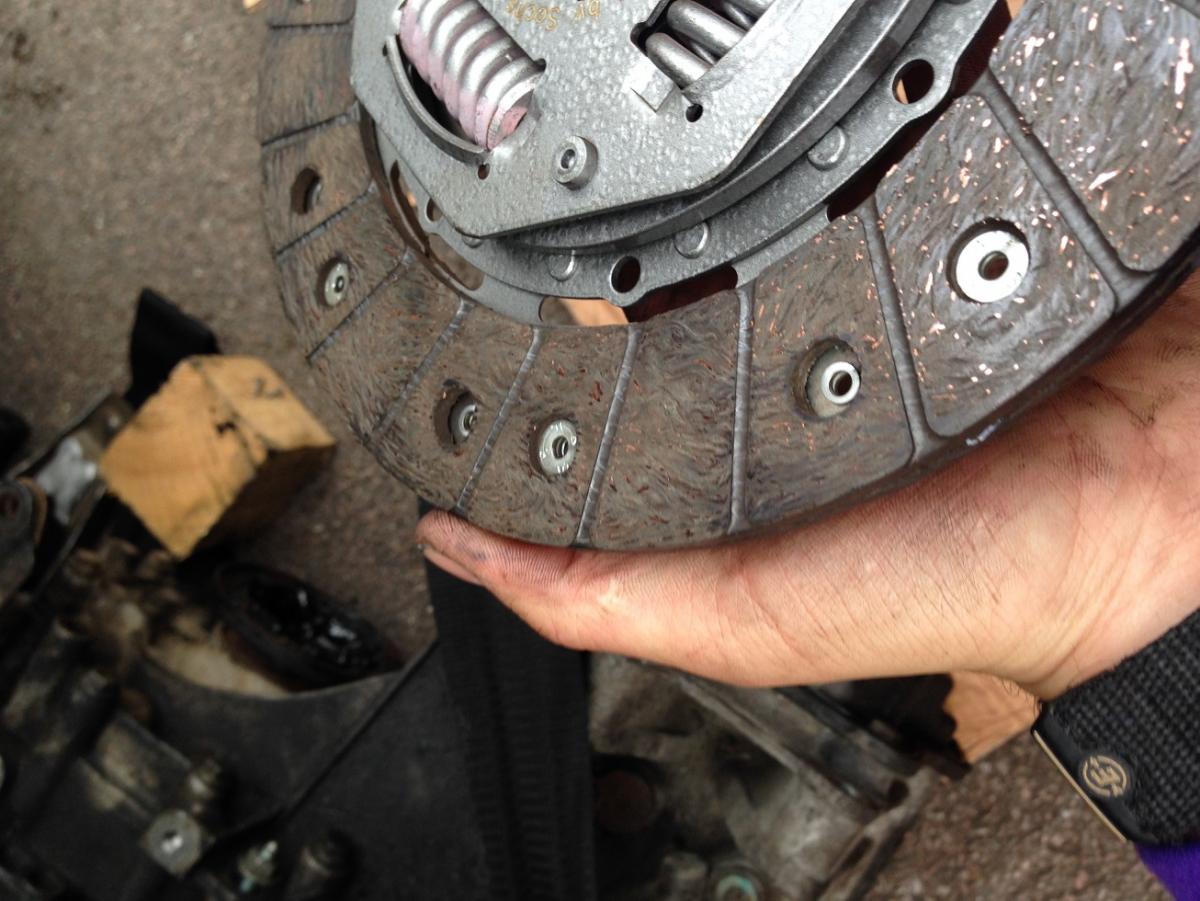

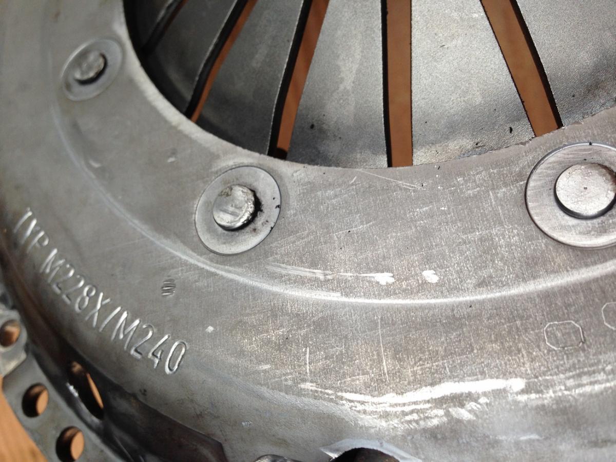

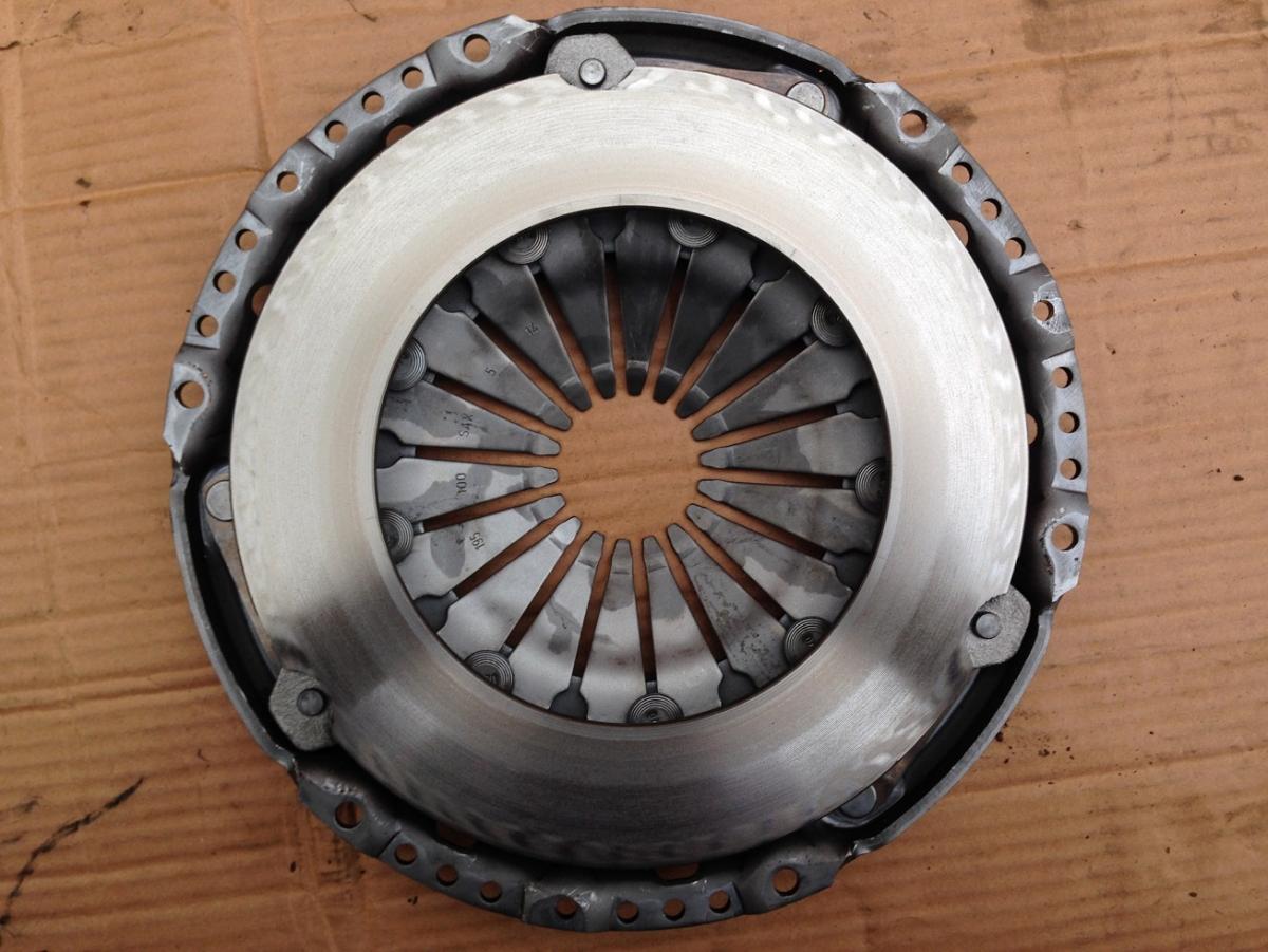

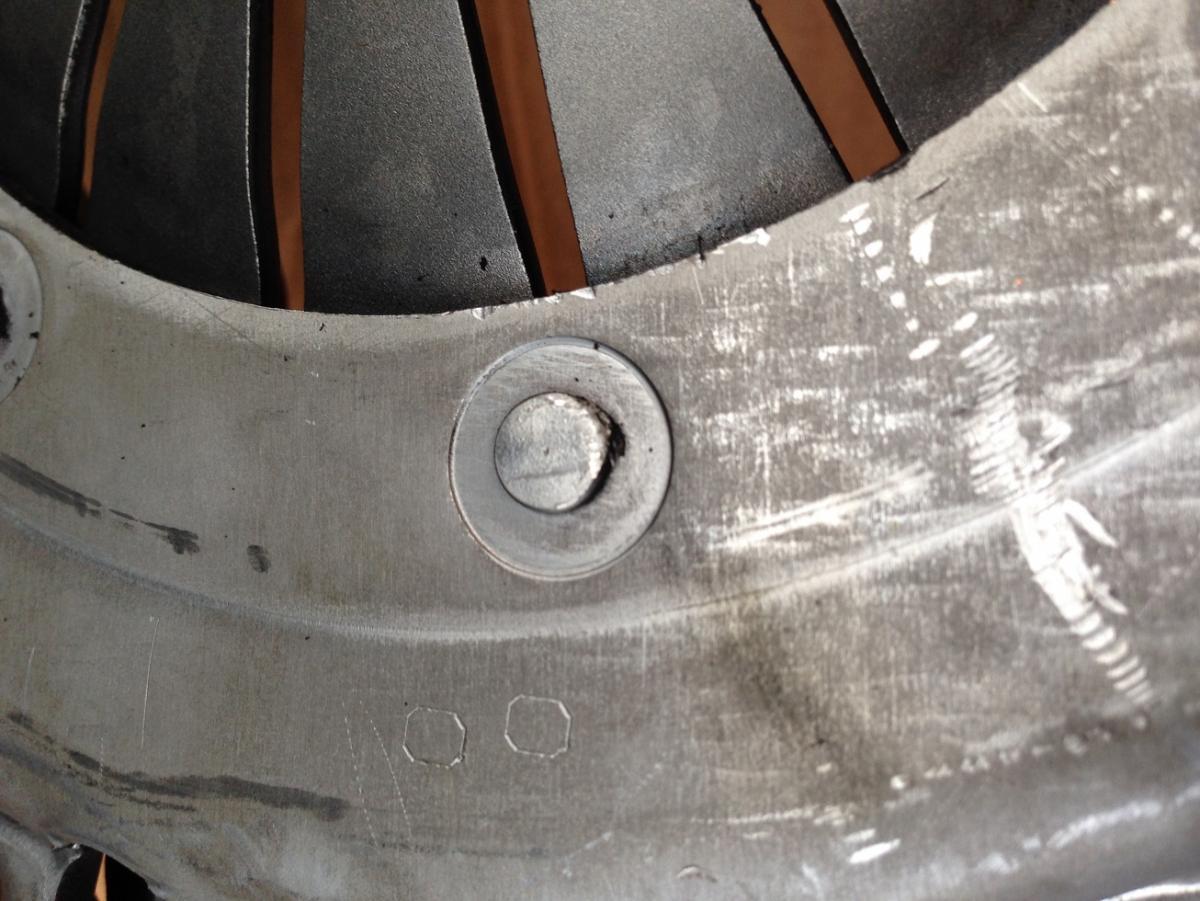

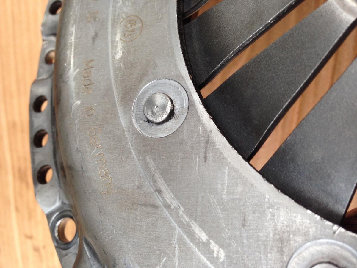

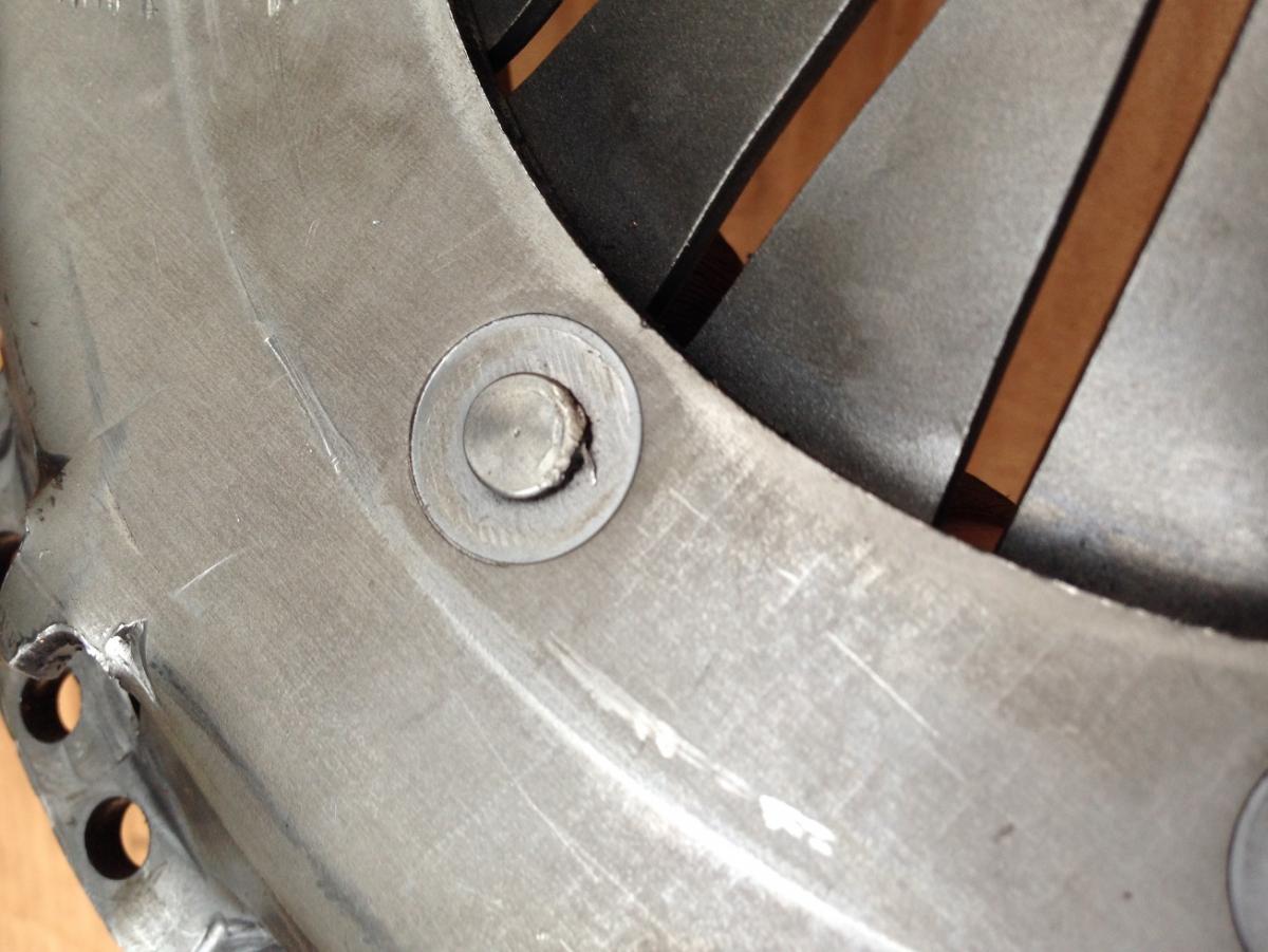

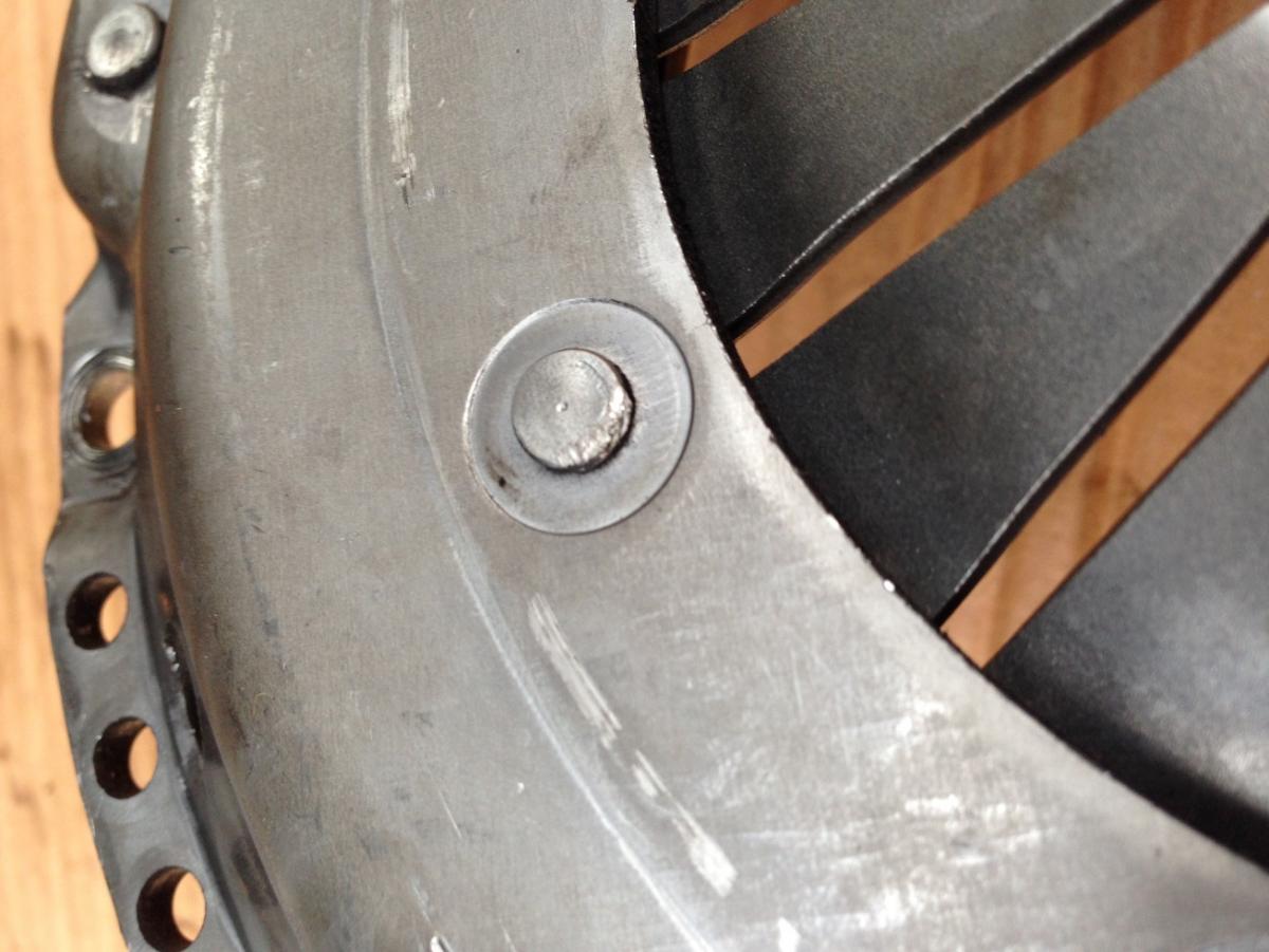

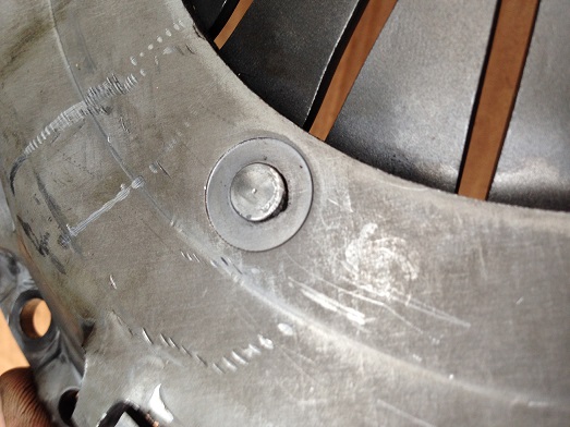

I have removed the gearbox to inspect the clutch and have seen that the mark on the flywheel is not in centre of the two  teeth on the pressure plate. I have been searching round the web and have found that it should be in the centre.Maybe it is out of balance and that  is why it kicks.  So either the flywheel is not the propper one or the pressure plate.

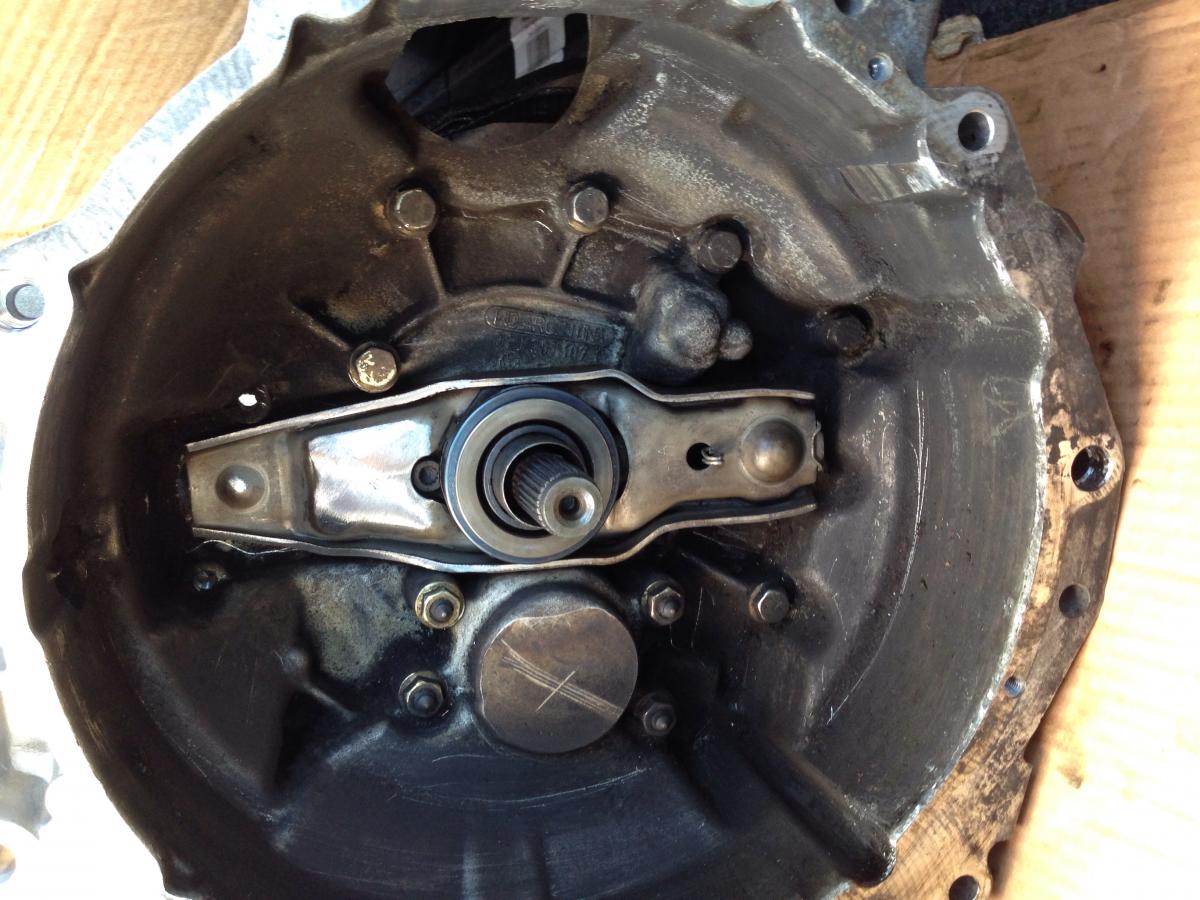

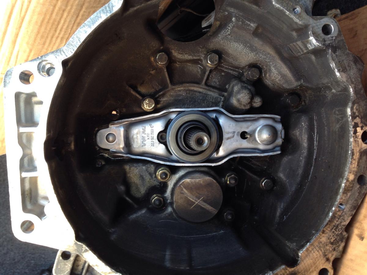

Also there is some wear on the rivets all the way round the pressure plate. I guess it should not be like that. Maybe that was making the metal scrubbing noise. The release for has catching them. I am not sure as the garage has modified (stupid i know) the release fork so it is not catching anything

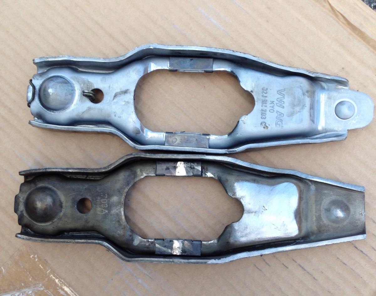

Because garage has modified the release for to stop making the scrubbing noise i was advised to get new fork, but now i dont want to put it back together to have the metal scrubbing noise so have contacted the seller  and did send him some pictures and now waiting for his reaction.

Looks like the flywheel is machined wrong so sits to far forward so the rivets on out plate are hitting inside box
Can you take a pic of the inside of the box and post it
I had the same problem ,the fork was touching thr pressure plate,but clutch wasn;t disenganging at all....put a new fork 1 year ago and still runs smooth

just put a new fork and that's it!  I guarantee it will sort it

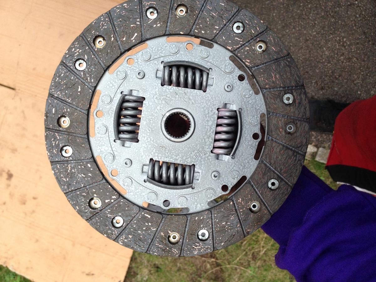

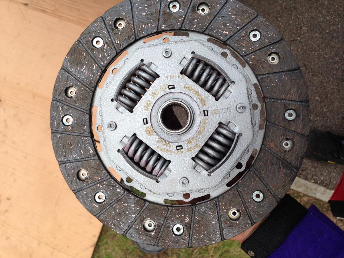

Clutch looks very good
Previously there was dual mass fly wheel and i have converted it to single mass. I have been told that the fork does not need to be replaced so i have used the old one but then there was that noise.
So now i have brand new fork but it is same as the old so i belive that that sound will come back again.
It's the flywheel is machined wrong so the clutch plate hits the inside of the box !!!
Had this a few times with techni clutch there **** would never ever fit one
As you look inside the box you will see where the rivets have hit
Once they wear a groove it will be fine as it won't hit no more
Ok that would explain that metal scrubbing noise - but it only apears when pressing the clutch pedal so it is hitting the fork. then why is all the shaking when releasing the clutch ( when starting to move with the car. And why that kick when switching the engine off (it kicks with last turn of the engine) and why lack of power.

put a pic with the fork
