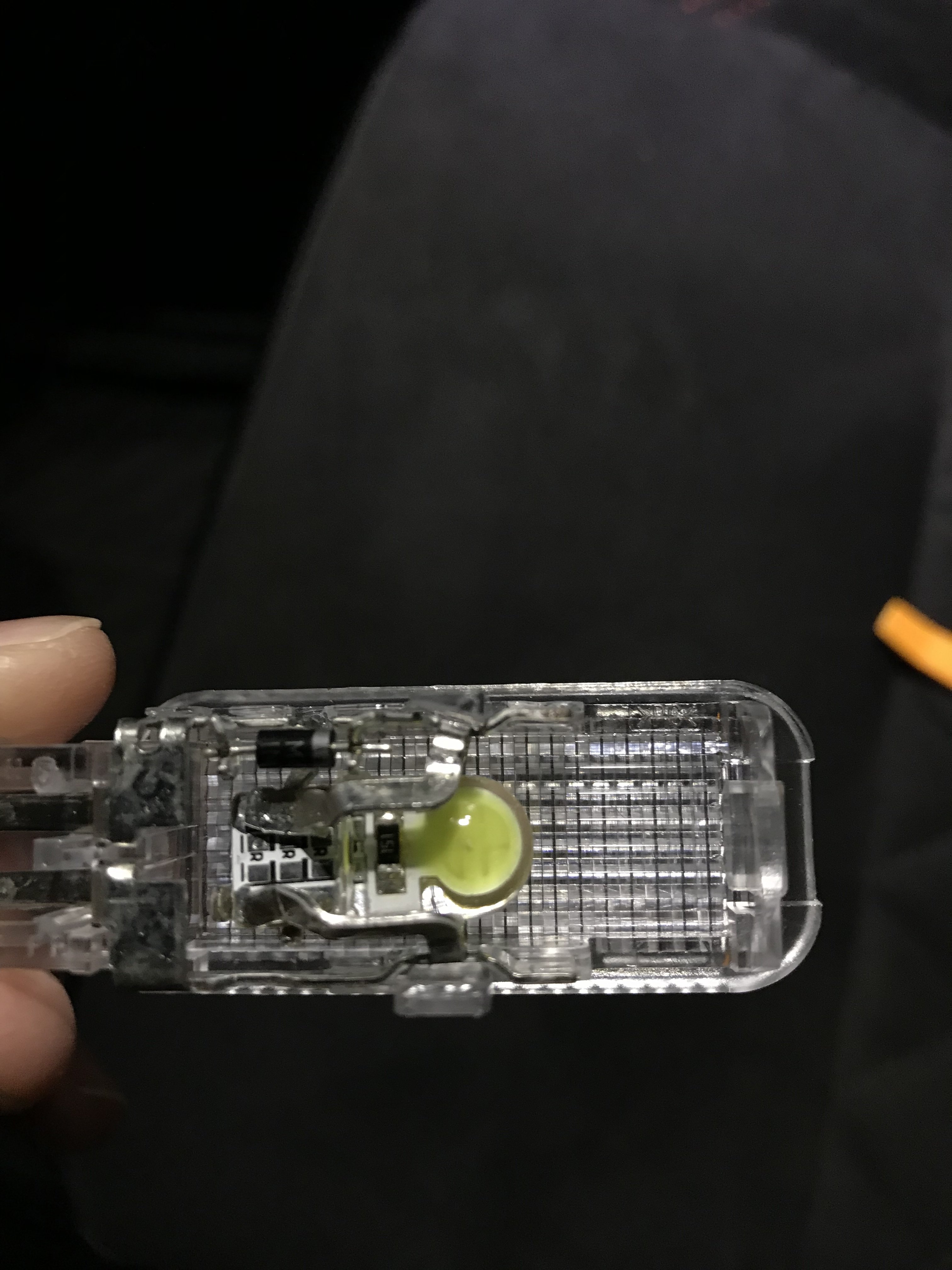

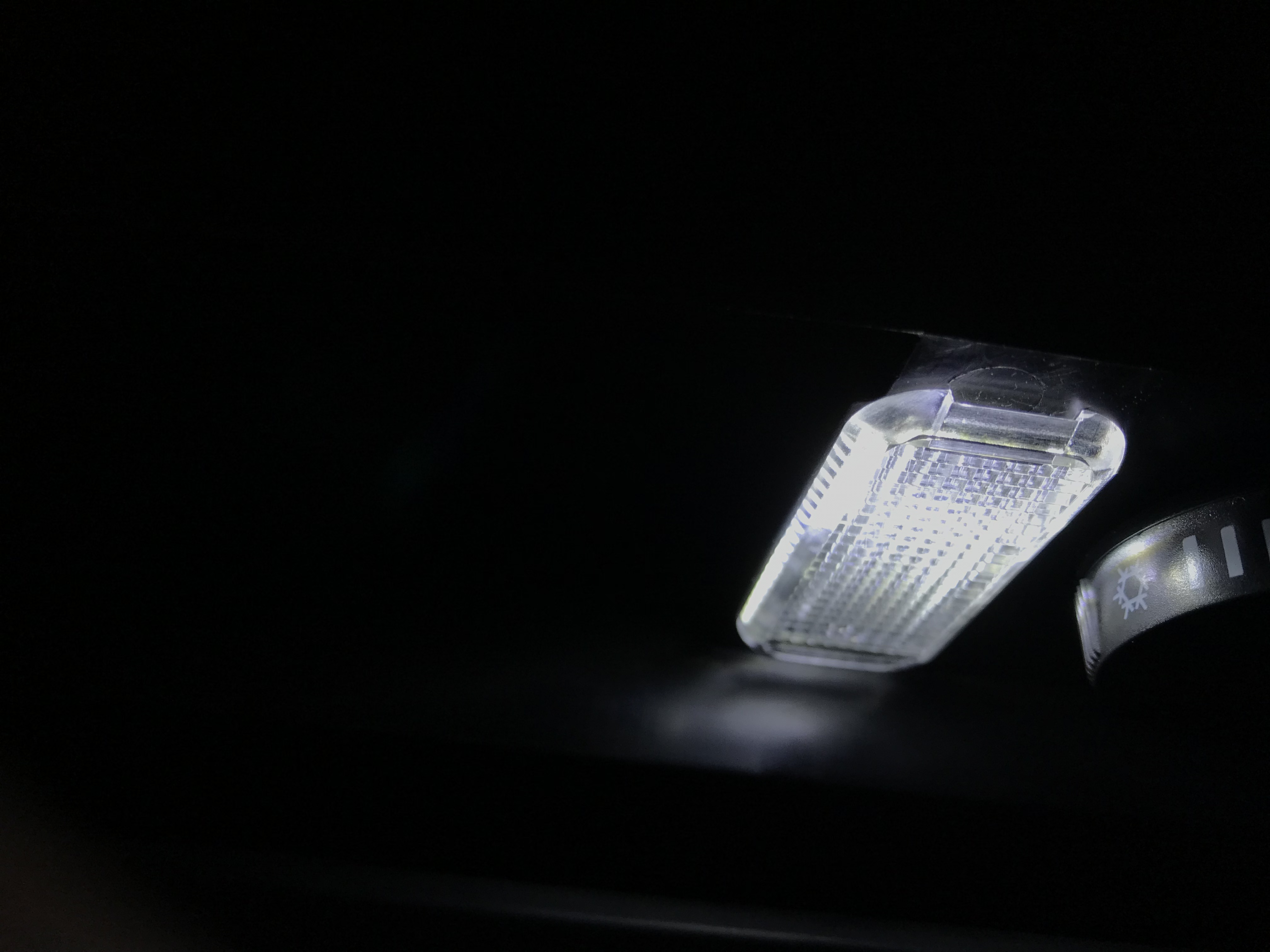

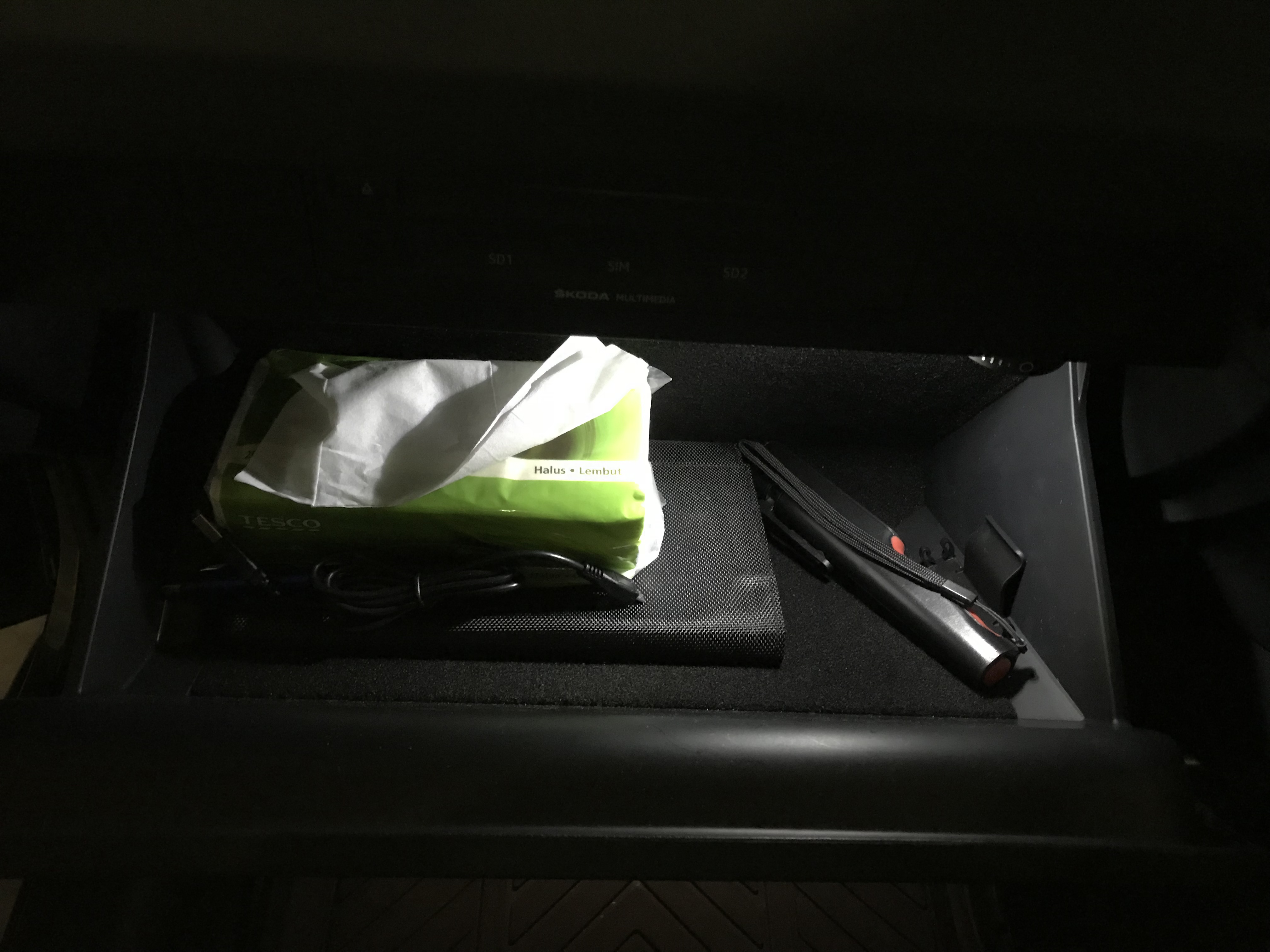

Final piece of the full LED interior completed. Here’s one for the glovebox.

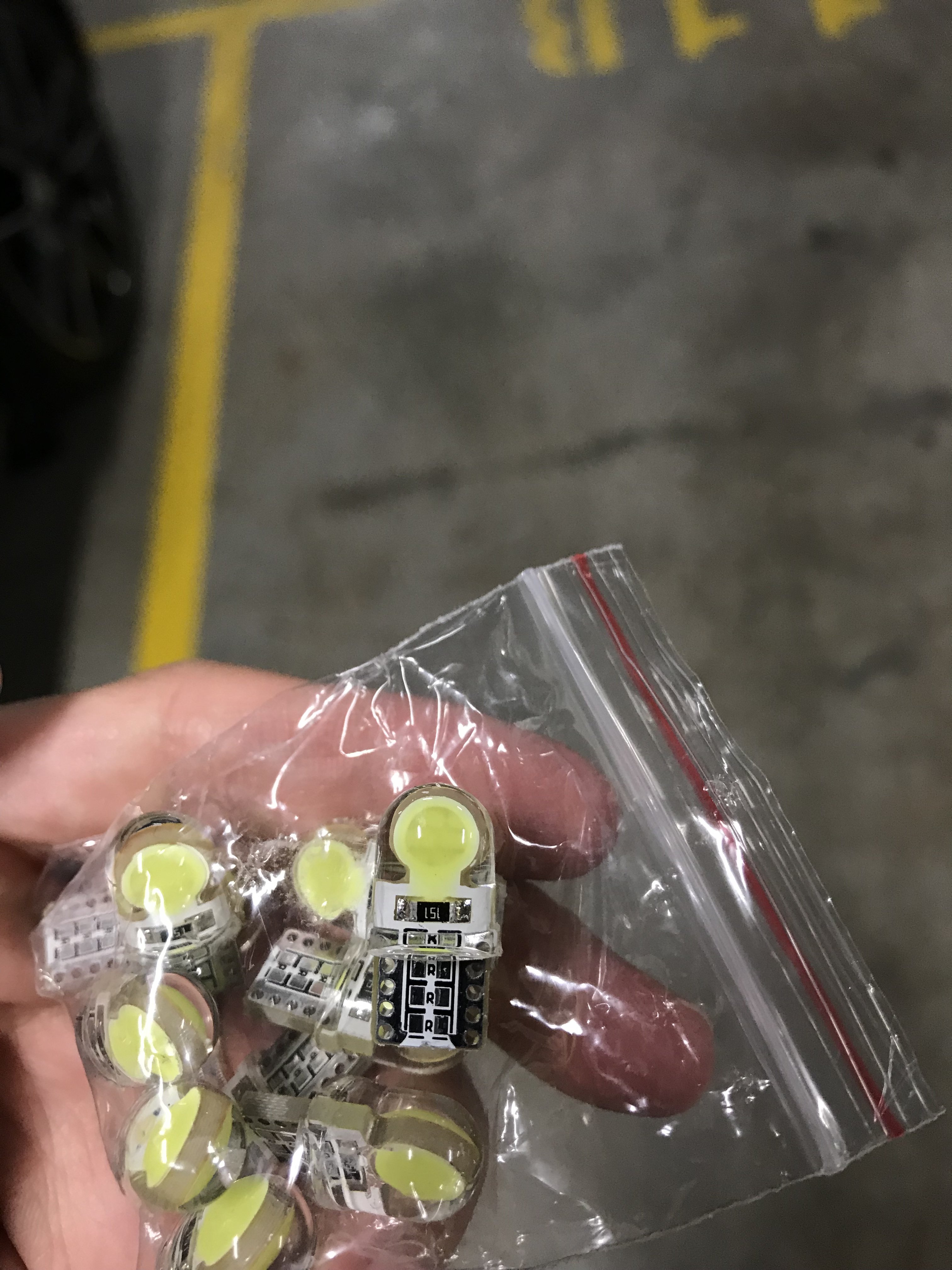

  • I've replaced all the interior lights with LED ones The front roof light is x2 501 bulbs you need screwdriver to help you get the light cover off it's clipped on The rear roof light is x3 501 bulb
  • Interior Boot lightning http://s.aliexpress.com/UNFnQjAv   Glovebox & door warning lights (red) http://s.aliexpress.com/Yfme6J32 http://s.aliexpress.com/y
4 hours ago, wingzee said:
Is there a big tub of Vaseline hiding behind that tissue box?
Err nope? It’s just a huge pack of tissue (not even a box). Lol
just kidding pal probably to geographical that joke.
the lights look boss! i have a set of interiors coming from ledperf

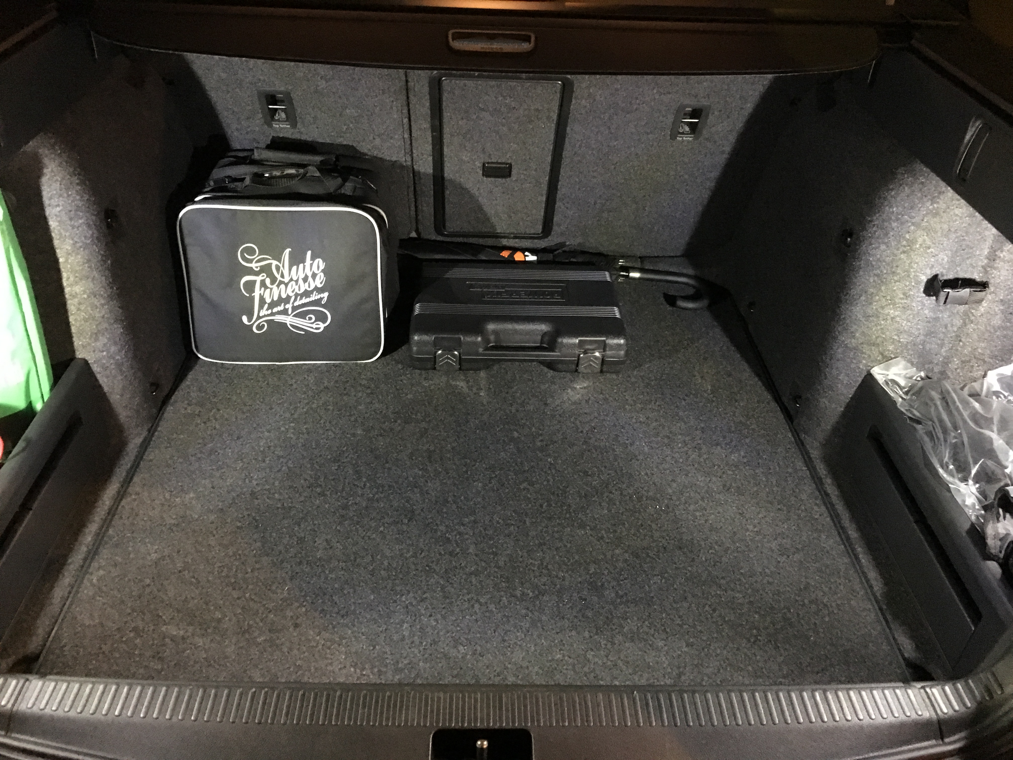

if anyone is looking for led’s for trunk, this one are great... pure white color, without any blue-ish color and also high power!
https://m.aliexpress.com/item/2036929238.html?spm=a2g0n.orderList.0.0.16fff8e4Aqupy3
Now i’m looking for something like that, but less power, for footwell and roof (ambient) lighting... Few days back i received some leds and they were a little blueish, so i put them away, now i’m waiting for other package, hope they will be pure white as i want... if anyone have sugestion i’d like to here it :)

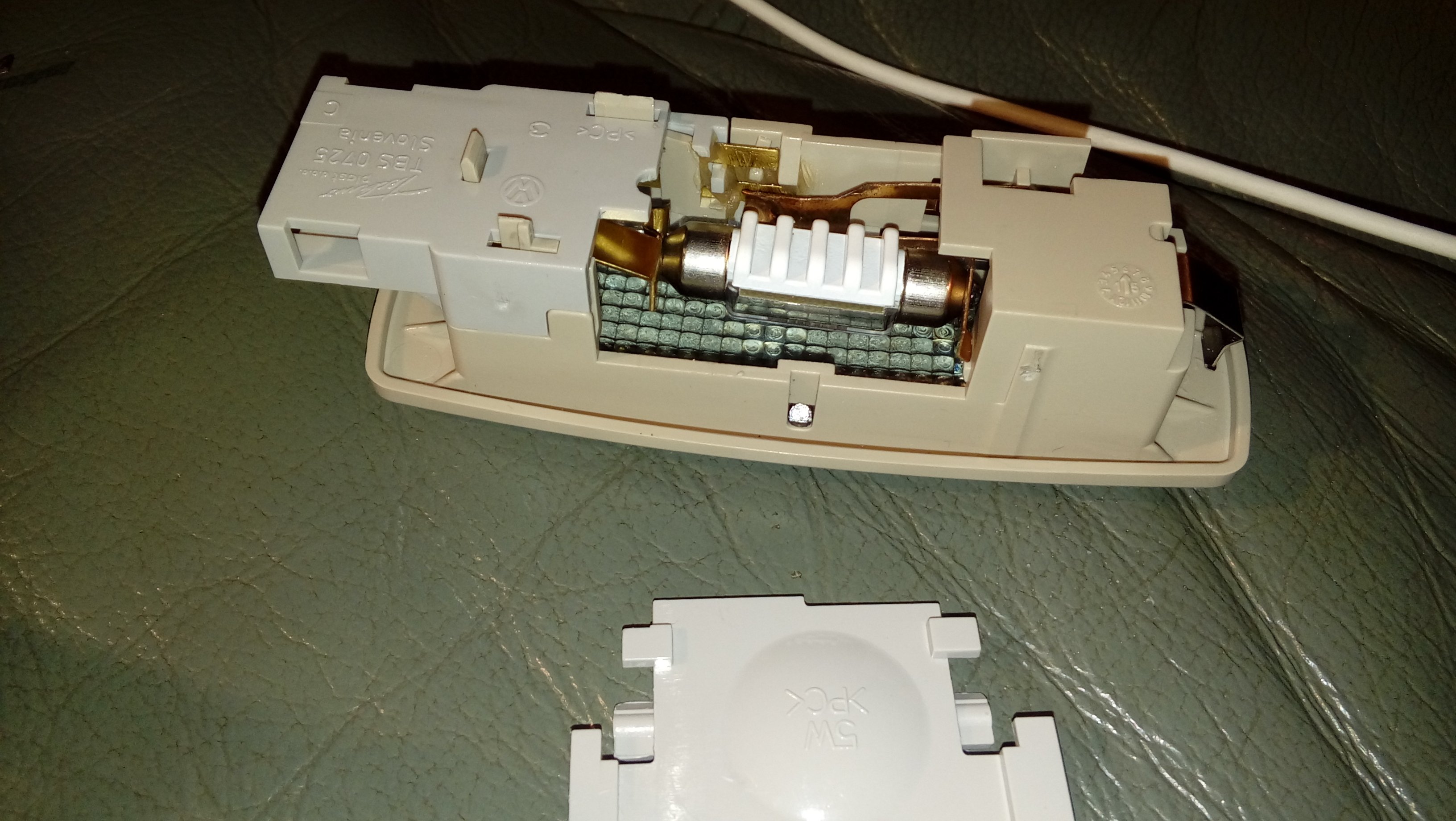

For anyone looking for information on LED replacement
Rear door overhead lights are festoon bulbs and although I measured 36.6mm , a 38mm Philips 4000k warm white fitted well.
To remove fitting use flat screwdriver or trim removal tool positioned from front to rear direction when viewing car. A spring clip retains light fixture. There is a squeeze clip electrical connector to allow you to remove fixture from cable. The back of fixture panel can be removed sideways to access bulb easily. See bottom of photo. The electrical cable is towards rear car side of light fixture.
Edited by bmbmdmb
