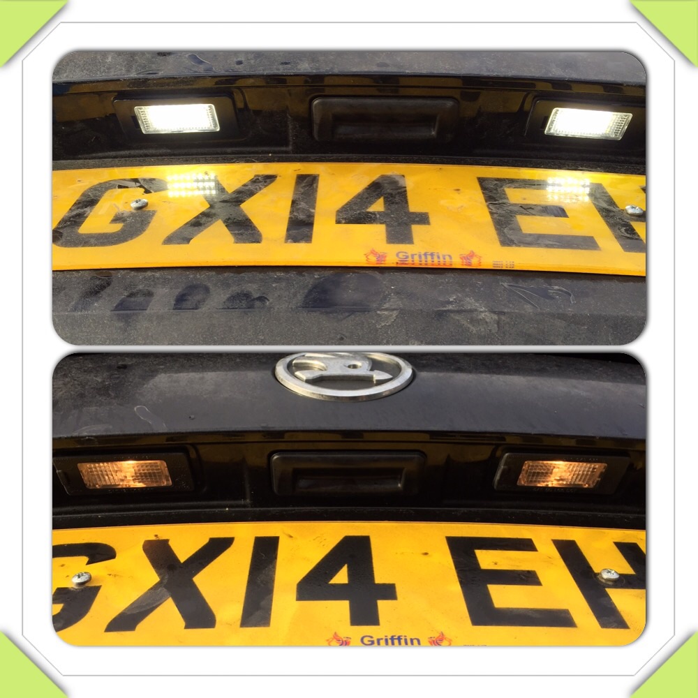

Just for reference, if it's useful to anyone not buying the ledperf set, the numberplate lights need to be canbus error free LEDs as mine's throwing an error when the ignition's on, all the internal ones seem fine with cheap normal ones though.
Cheers, my light unit is slightly different, but the same principle. Used a trim tool and it popped out easy.
That can be adjusted on vcds for LED no. Plate bulbs. Link in the vcds section.
Unfortunately I've not got access to VCDS and it's a bit of a trek to get to someone who can do it for me,  just for some numberplate lights.
Also; I've just swapped the LEDs for some canbus ones and still getting the error. So unless anyone knows a specific LED that will work without the dash error I'm going to have to swap back to yellowy bulbs I think :(
I've used the interior kit as well as the number plate lights from LEDperf all without any dash errors, although did show an error code when a full scan was done but I think this was caused when I swapped them over and not whilst being used.
Are the ledperf ones just bulbs, or the whole unit? Superskoda also do a replacement unit for around the same price. But don't think I can justify £30 including postage just for number plate lights. Might see if I can find some blue tinted bulbs for the same look.
Yes they're just the bulbs.
This one I've got from ledperf and works without errors.
I also bought the ledperf LEDs and they're working fine after a couple of months
Yeah, I think I need the massive resistor on the back to stop the errors. But £30 is just not worth it to me. I've ordered some cheapy bulbs with the blue coating to try and whiten the light. We'll see how that goes. I can replace them both 10 times before I've spent the cost of the LEDperf ones. So even if they're a bit dodgy I should be ok :)

Did you need to use VCDS to stop the error with these?
The bulbs are not "CAN-BUS friendly" so you'll need VCDS or additional resistors for license plate light or side light.
I think the other (interior) W5W bulbs are not monitored by the system - no coding required.
As the CAN-BUS cancellers (resistors) are missing the bulbs doesn't generate additional heat.
They run at lower temperature than a standard W5W.
