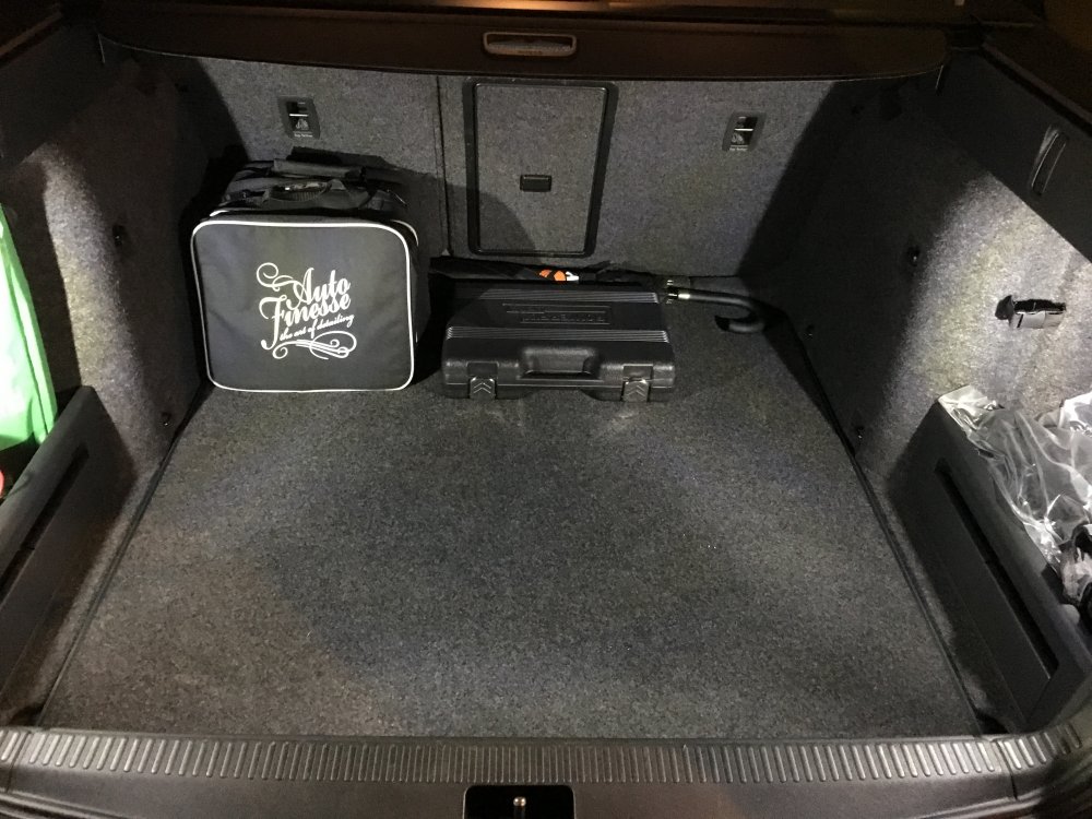

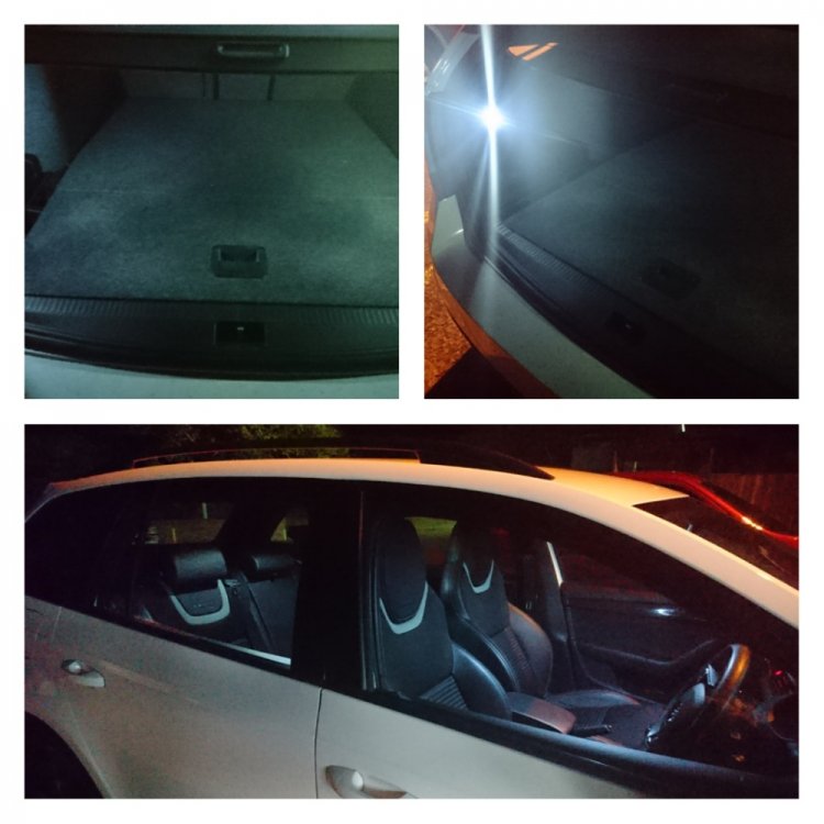

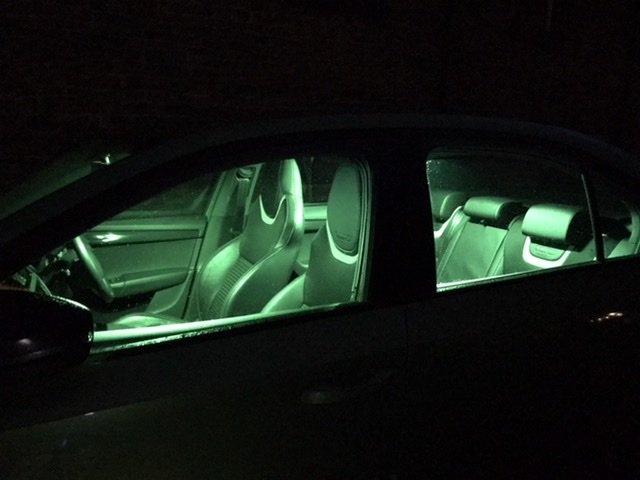

LEDs give a clean white light, much better (in my opinion) to the standard 'yellow' bulbs.
Full set available from http://www.ledperf.co.uk/pack-interior-full-led-pure-white-for-skoda-octavia-3-5e-p-4942.html with the option of selecting different colour LEDs if you so desire. They also came with fitting instructions for the reading lights, glove box, boot etc.
Also changed the rear licence plate bulbs to be LEDs - now car is fully LED/Xenon, with the exception of turn indicators. http://www.ledperf.co.uk/leds-pack-white-6000k-license-plate-for-skoda-octavia-3-5e-p-4949.html (no error codes)

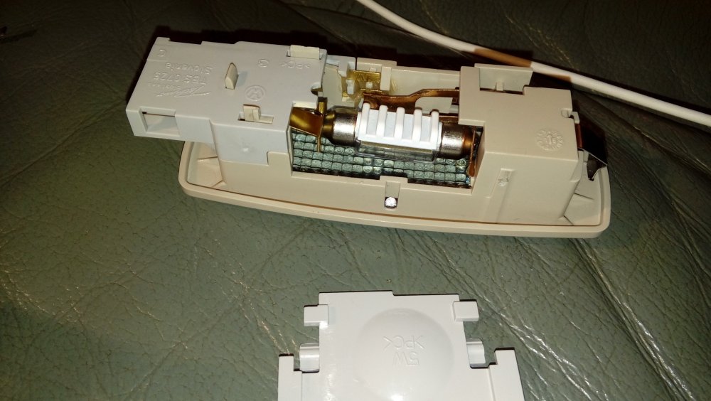

Number plate lights just slide to the left and you can then just lever them down and out, unplug to make it easier to change the bulbs. There's instructions in the manual on how to change with pictures.
I took some pictures when I change mine.
Be careful with your fingers! Its like a mousetrap and it hurts like hell!
