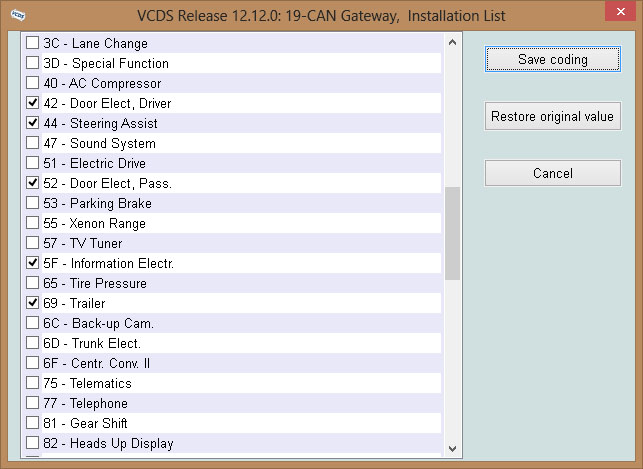

Tow bar is Westfalia fixed swan neck & reversing sensors do not see it. Electrics are 7 pin but loom from front to box in rear seem to include what is needed for 13 pin. Coding (off the top of my head)
1 CAN gateway add trailer module (69)
2 Recode BCM for trailer
3 Recode engine for trailer
4 Recode park assist for trailer
5 Adaption change to ABS to enable trailer stabalization
6 Recode trailer module as 7 pin (because no fuse fitted in supply wire used for 13 pin causes fault code)
Edited by pncarrerars

Here are some screen shots I hope:-
CAN gateway
BCM
Engine
ABS
Park Assist
Trailer
Excellent - I'll write it up later.
If anyone has a screenshot of the coding change required for the A5 Lane Assist camera can they post that as well please.
Added to the O3 VCDS Adaptations thread - I still need a screenshot of the A5 Lane Assist camera coding please.
