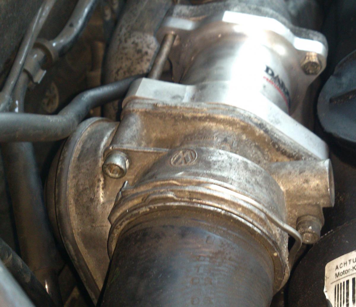

First puzzle is this, the garage didn't use the top Samco hose I'd ordered, but instead replaced with a stock VAG pipe - I've not had a chance to speak to the chap who did the work, but it appears to me that the Darkside EGR delete resulted in the ASV being twisted sideways?? Or am I (/they!) missing something??
Bit gutted to have spent £260 on a pipe I can't now appear to use!!!

Another pic...
They exactly how it should be mate? They wouldn't have been able to use a silicon bend unless you had also provided a connector to allow you to plug the pipe in to the ASV.

Cheers ash, thought that might be the case... Disappointing that neither supplier mentioned it when I ordered despite me checking specifically with them both before hand!!!
any ideas where I can pick up suitable connector/adapter? Sends a shame to waste a decent pipe!!!
Ebay or Forge Motorsport or Darkside Performance

Info all in this thread mate, this is where I made my entire top pipe up from. Think I have just told you the wrong connector sorry.
http://www.briskoda.net/forums/index.php?/topic/274533-Top-boost-pipe-replacement-DIY-:)

Have read your thread, but can't make out what I need to attach my Samco hose to the setup...Darkside said it was fitted correclty, but my ASV is clearly 90 degree different to your pic - or am I missing something?
Really appreciate your help cheers! Just noticed the top boost pipe join has blown, so need to get the Samco one on there asap...
