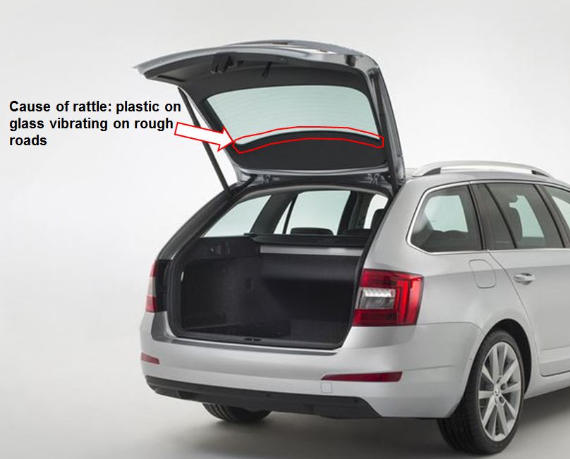

Found it.
It's the plastic lining on the inside of the boot vibrating against the glass. It felt loose and made a hollow plasticy rattle sound when I tapped it so I jammed a few bits of material underneath to test and bingo - rattle gone.  Now I just need to sort out a more permanent solution...

Found it.

If I knock on the plastic with my hand mine is rattling, too. At both top and bottom side of the glass. (Stupid solution from Skoda...)
But...!
Since I adjusted the lock and the buffers on the L/R side of the lid there's no noise..!
I had a noticeable boom (since the car was new) and finally additional rattling (started around 30k km) in the cabin on every bump.
I had to adjust (re-position) the car side of the lock (+ 5 mm inward) and the L/R buffer outward. The buffers did not touch the body...
Try to shake the lid from outside when closed. You can grab it around the number plate.
Also try to push the lid inward on L/R side.
If you can shake the lid or you can push it inward at the sides yours also need adjusting.
In my case the vibrating plastic caused the noise but as I mentioned after the lid adjusting it was disappeared.
