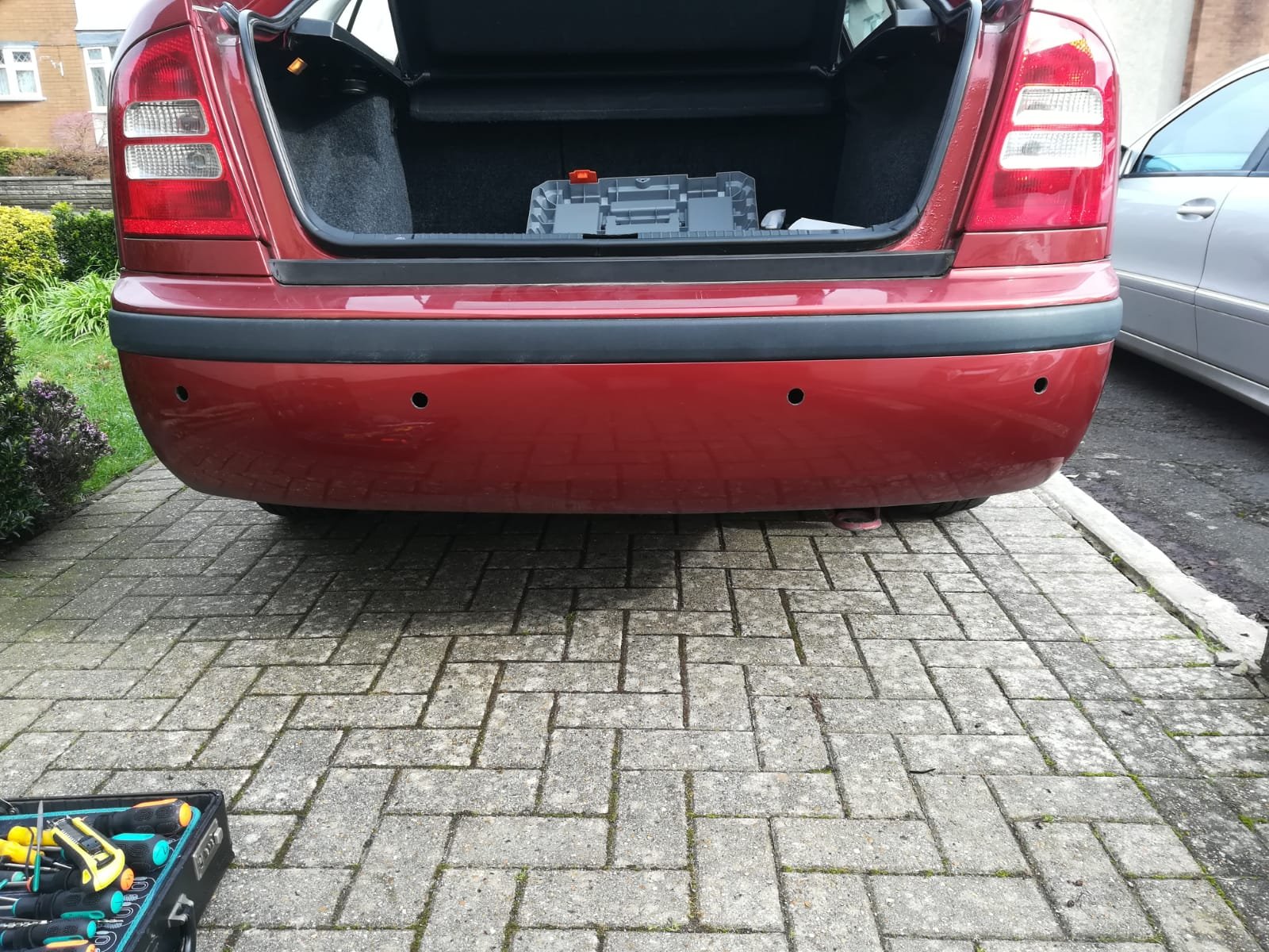

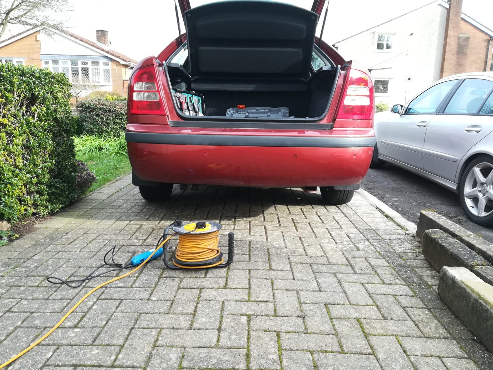

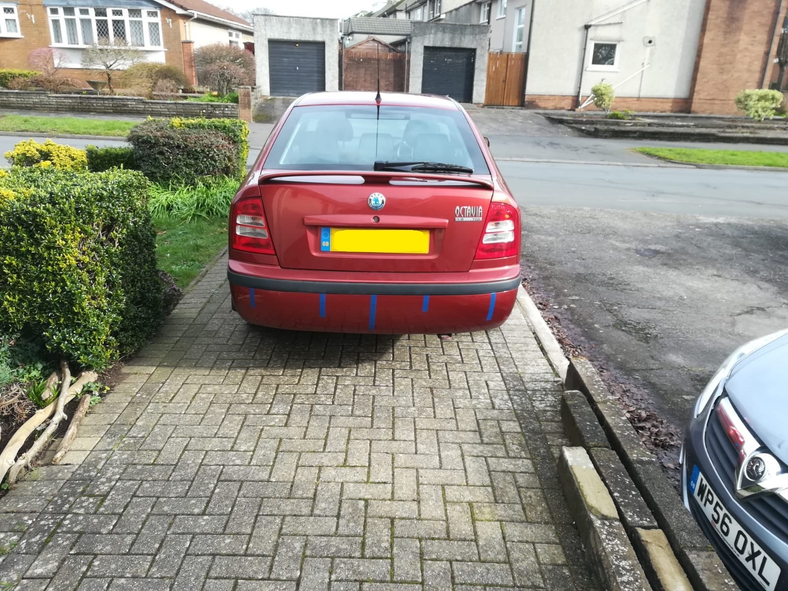

I've just done mine using your guide, thanks!
