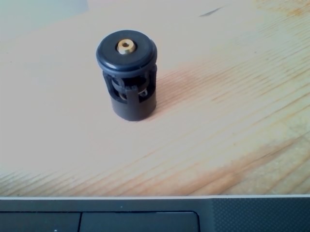

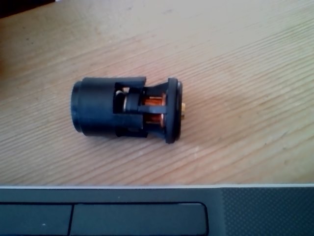

This is the thermostat they put in, that's wrong isn't it?
it doesn't look right :/

by the way, the thermostat you showed us is missing a very important part: the central plunger.
