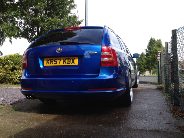

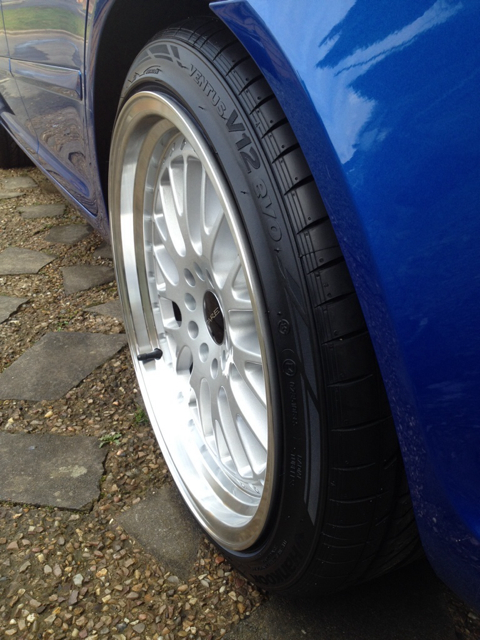

Here's them pics for you mate, not the greatest photography skills but I hope you get the idea
