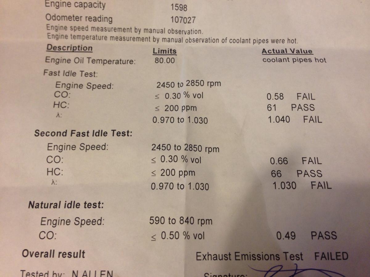

Managed to get a picture hope this helps? :)
Ok, it's running far too rich... There are a few possibilities here, although your lambda probe is new, it could be faulty, so bare that it mind, the HC (hydrocarbon) reading is a pass but I would expect that to be below 15 parts per million, high HC and co readings simultaneously indicates a rich mixture or unburnt fuel in the exhaust gas, if it was high co on it's own I would point to the cat being at fault
So it's either a faulty lambda probe, or there is an exhaust system leak before or near to the catalytic convertor which is allowing air to be drawn in and is fooling the ecu into over fueling.. Is the exhaust system noisy or sound blowy? If not try a different probe in there.

If I put the fail results up on here too, do you reckon you might be able to see if we have a really poorly fun or are perhaps being ripped off??
Yeah, what did it fail on?

Although I agree that the highish CO suggests over-richness, I am puzzled by your thumbnail of the test report which flags the second lambda of 1.03(limits 0.970 -1.03) as a FAIL. Summat wrong there! (I have before me a recent test report on a marginal Felicia, albeit generated by different software, which correctly flags a lambda of 1.03 as PASS).
In my experience, our worthy MOT test stations are not experts in calibration of their test equipment, and they are certainly not up to debugging underlying software. Do not take their results as gospel truth!
