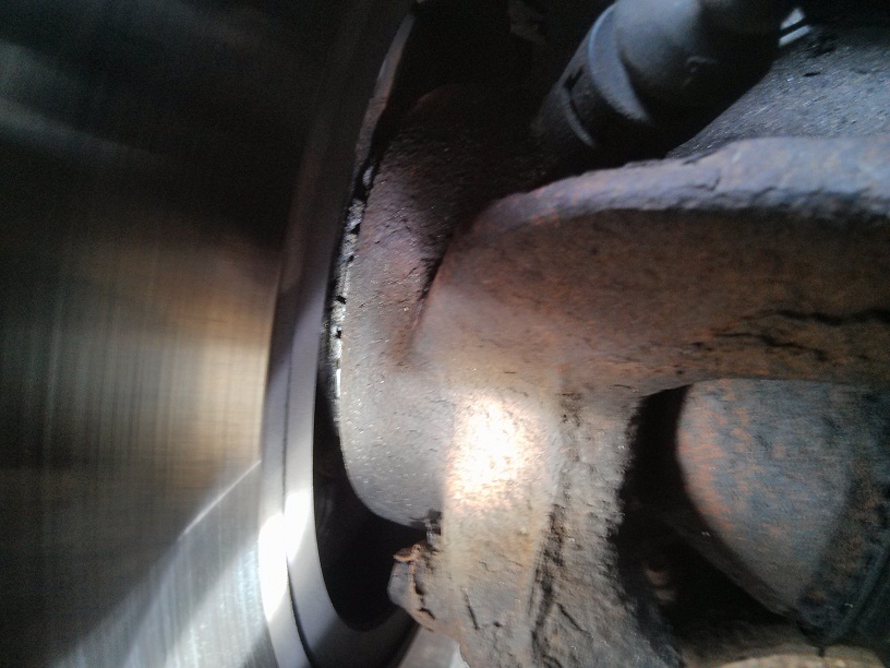

All was well for 4k and now my brakes are making the most horrendous, metal on metal grinding noise. Took the wheel off to find exactly the same problem as before, the pad shim is wedged between the caliper carrier and the disc. There just isn't enough room; the offset of the hub must be wrong again.

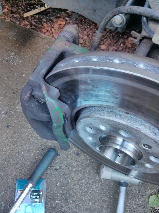

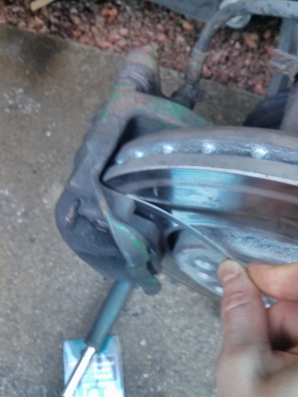

Pics are below but I don't know if the wrong hub has been supplied twice, by two different suppliers, 3rd party and genuine... the only constant is the garage.
What do you all think? Wrong hub or can it be wrongly/poorer fitted? Pictures attached of the gap plus a 0.025 feeler gauge inserted.

You were right - picture below shows its slipping out. My drive shaft boot is split too, I wonder if this is a coincidence.  :dull:
