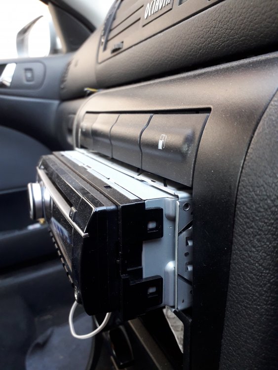

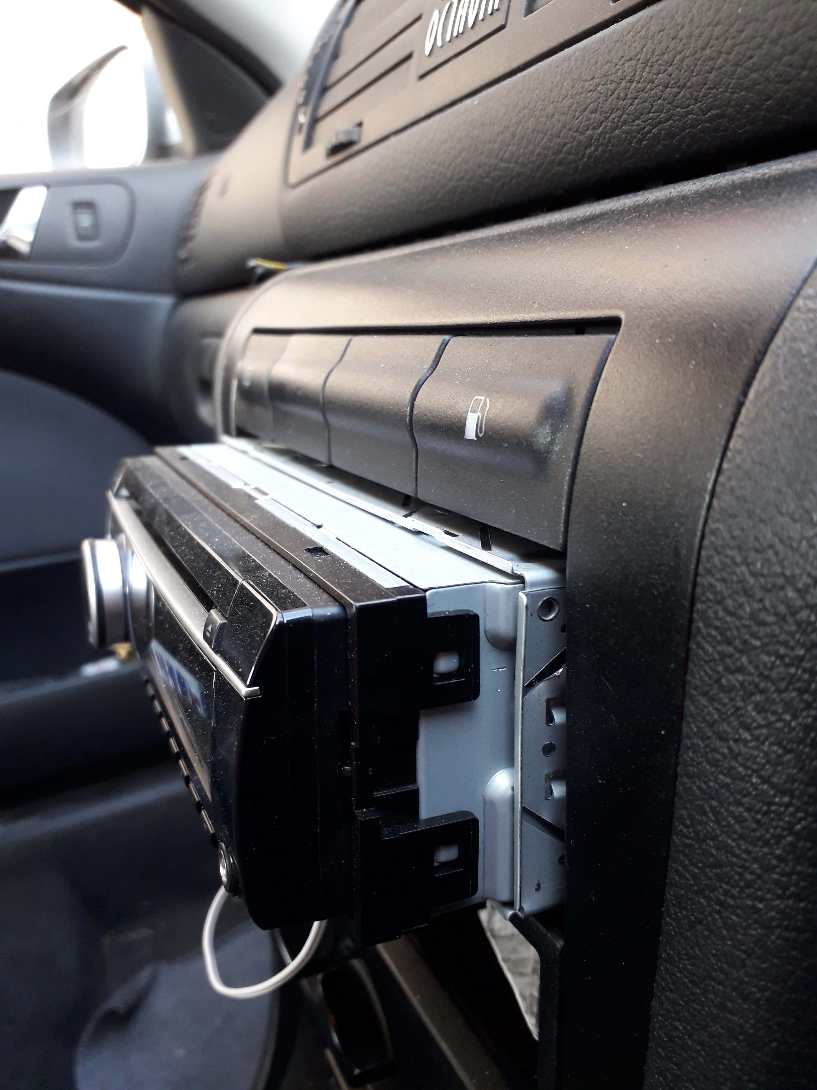

Did anyone else seem to have this issue?
That seems to be as far back as the CD player wants to go where the tape deck was.
You may have to cut away part of the original radio plastic support frame at the rear of the aperture to get the unit in. I had to do so to get my Alpine unit in. I assume your new unit is deeper than the original OEM unit?.
Also, you need to secure your radio cage to the surround a bit more securely once you have finished trial fitting, which is why I am assuming the cage is sticking out of the opening.
Edited by kentphil1
Iirc, i had hassle with mine because the looms kept gathering up behind the HU and stopping it from going all the way in. Pull out the cubby under neath and use the space to get a hand in and shove the cables out of the way.
Also,i presume you fitted an inline power booster, as the original hu has it built in, or your fm/am reception will be ****e.

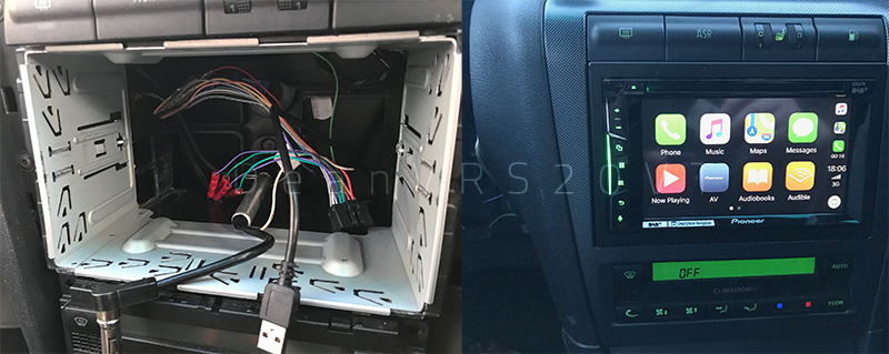

From mine as it'll give you an idea what you're looking at
