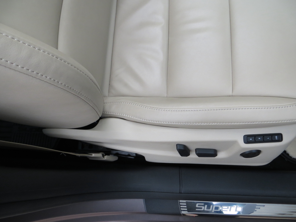

Spotted the attached the other day. The car is only 2 years old with 13,800 miles. I think this wear is quite unacceptable.
The seats have only been cleaned occasionally with a barely damp cloth, I have never used any chemicals.
Anyone else spotted this? I would be interested to know if this is common or just my bad luck before taking it up with the dealer. I have had cars with leather seats in the past,  Saab for 12 years, Discovery for 8. Neither showed any wear like this.
Your thoughts appreciated.
The first pic does look a little bit excessive alright.  Is it the shiny appearance on the second pic that is the issue?  I noticed the shiny base to a certain extent on my last Superb however after three years and 120k kms it was not quite at that level.  Remember that on the areas of the seats that normally don't make contact with the body the leather is generally more artificial i.e. on the back and sides however they should still hold up.  Having said that I have seen some BMWs with even worse wear after shot periods.  Would you jump in and out of the car a lot on short runs etc? I presume you have had the car since new - if it still under warranty it might worth a trip back to the dealer.  They will probably throw the  'normal wear and tear' clause back at you but worth arguing it all the same(especially for the part along the stitching)
The shiny appearance does not bother me as your backside will cause this effect. it is the wear along the raised edge of the seat that really annoys me. There just does not seem to be any thickness in the leather. Now I am only 10st. and quite slight so when sitting down I do not get anywhere the edge. It seems that you brush over this getting in and out. Not a very good design in my opinion.
Yes I have had the car from new, like others in the past my driving is a mix of short and long runs. The point is leather is meant to be more hard wearing than cloth seats.

Have to agree Zee, that is completely unacceptable on a car in this price range (or any price range come to think of it), age and mileage. Trip to the dealers required but be prepared; if you don't get a satisfactory result when they come back in from looking at it DO NOT take the key back! Especially effective near closing time. Stay calm and restate that you find this unacceptable when they repeat that this is normal wear and tear etc. after a few of times stating it's unacceptable SAY NOTHING and don't take the key back. By offering no movement towards the car or further dialogue all movement will have to come from the other party to diffuse the situation, which should hopefully get things moving towards settling your issue. Hope this helps.
Tricky ! Looks like external influence.
What other influence is there going to be!?
Seats get sat on, that sort of wear on a car as new as the OP's is clearly a manufacturing defect.
Blue staining, denim.
Scratches, rips - zips, studs, things sticking out of pockets etc.
5+ years, high mileage, overweight, poor mobility.
All fair wear and tear.
What I see in the first picture is consistent wear but obviously accelerated due to the poor quality of the material.

It does look like entrance / exit wear from clothing. The wear is more pronounced at the centre of the bolster, which depreciates to the rear (to the left in the picture) and at the inner edge (top) of the piping. What is odd is the spacing between each of the pieces of damage.
Nevertheless, a good dealer should try to get the seat cover replaced under warranty because of the age of the car, its low mileage and of course, goodwill too.
However, if they do say its normal wear and tear and no-can-do on warranty, Gliptone Scuff Master will cover the damage and lasts really well. I know this as a fact as I use it with great success on my MKI (with 120k+ of wear on the driver seat!). Gliptone already have Skoda Ivory available in their colour bank from my original order. Although this is shown as 2006, the Ivory colour has not been revised from the MKI to the MKII. I think a kit is about £14, and I’ve used it in anger once and it’s had a few “top-ups” since then, and I estimate I’ve used less than 10% of the bottle – I suspect it’ll probably out-last the car!

Yeah, I agree Supurbia; the leather finish is better, the facings are more "supple" and have a better "feel" on our MKI, than those on our MKII. That being said, although very slightly too narrow in the area of ones Derriere in my case, they are more supportive, have better adjustment for overall comfort.
SUK response - wear and tear, cannot help.
Still don't think this is good on such a new car.
