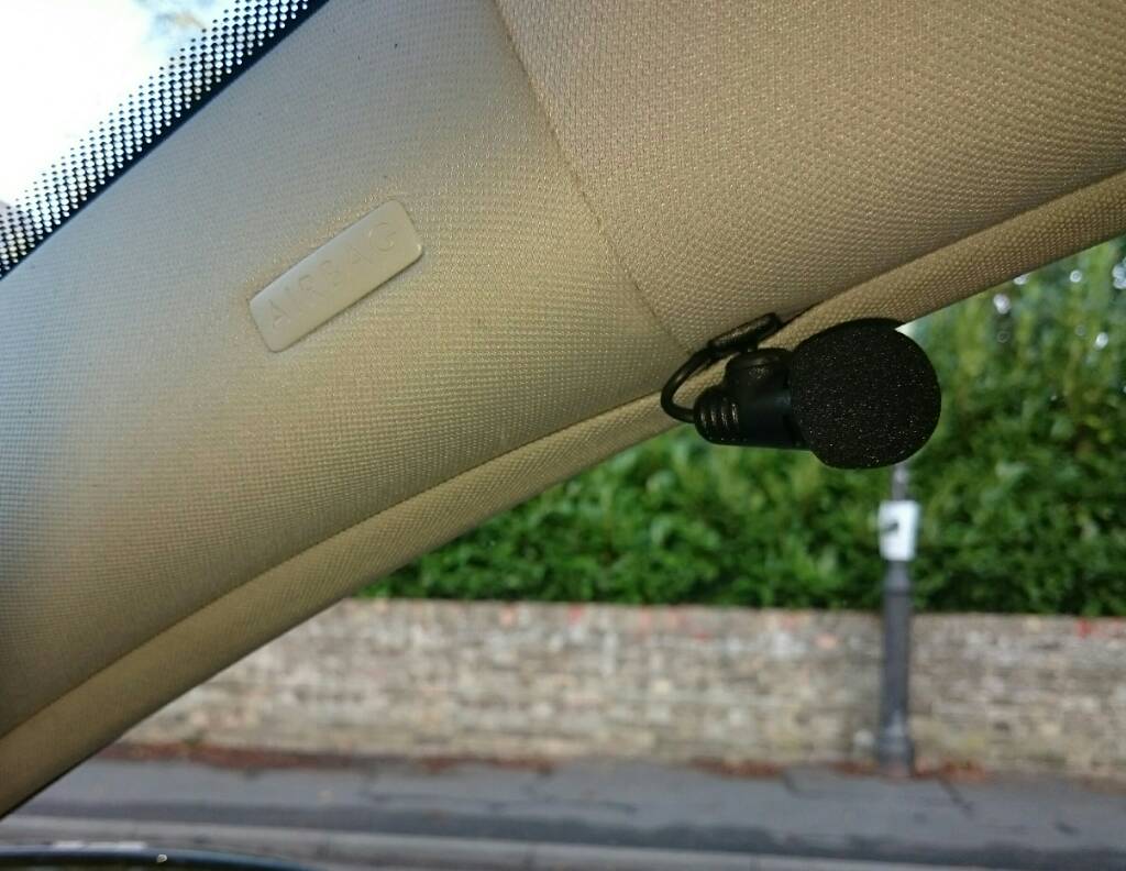

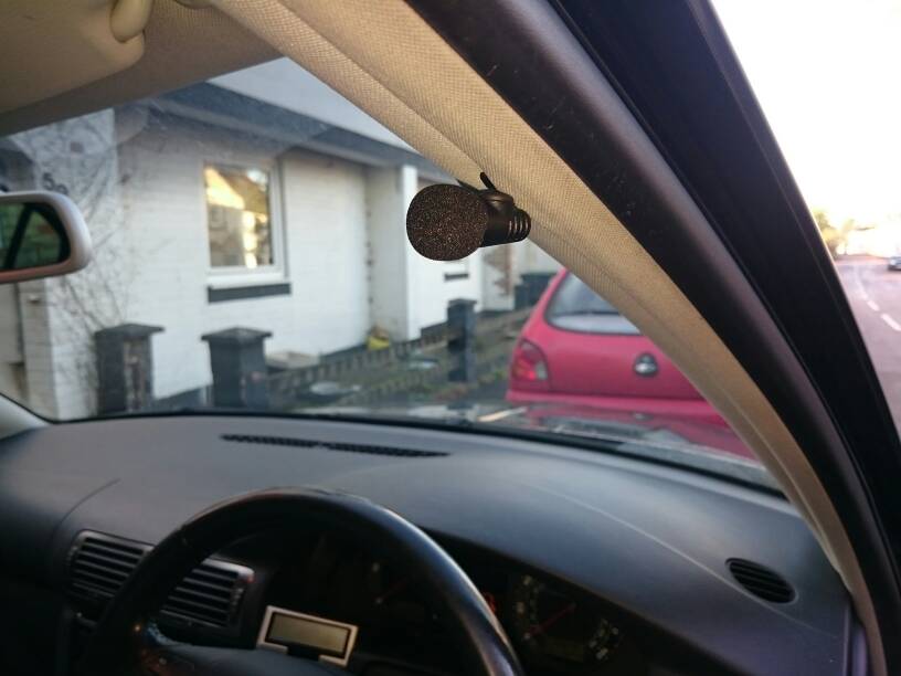

I get excellent call quality with the mic tucked in at the area where the headlining meets the airbag cover on my Superb.
post-78853-1412925292547_thumb.jpgpost-78853-14129253013307_thumb.jpgpost-78853-14129253079461_thumb.jpg

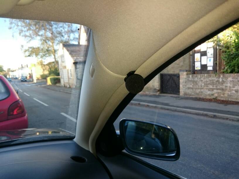

I know people like to hide them away as much as possible - but I think of it like this:  I have the BT kit to be able to make safe calls.  If I'm worry and faffing around / getting stressed because the other party can't hear me well, that defeats the object.  You really want a direct line of sight between the mic element and your mouth, and for it to be as close as possible to your mouth.  The location at the door is much closer than the mirror and completely unobstructed.  People I speak with regularly tell me they can't tell it is a hands free, the calls are that good.
My kit just arrived and the mic is huge, I will try it hidden as I kept knocking the old one on the a pillar but if I have to I'll move it.

Here is where the mic is and even though it is huge, it sits neatly out of the way and works
