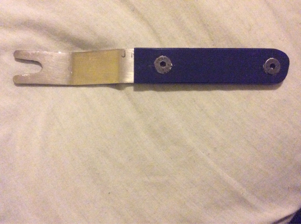

Coilpack puller made from a couple of bits of scrap material:
For those awkward trim clips :P
For those awkward trim clips :p
