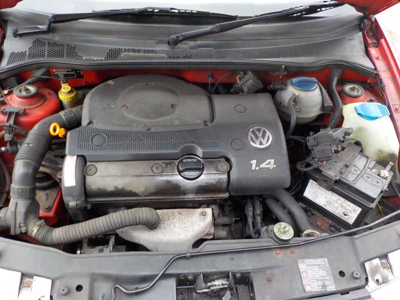

i think i have found a polo 1.4 for my fun conversion
any idea how i can tell if its the 100bhp model
its a s reg
1.4 open air thats all i know might b able to get the engine code but not sure yet

If it's an s reg 1998, the only 100bhp model is the AFH engine code.
is there a way of telling without the engine code as its on a local salvage site i use

Picture?
of the engine ?
thats engine
That's an 8v one, probably an AEX engine code which is 60bhp

Actually scrub the last... Just noticed the 3 screws on the air filter housing, that's a single point injector version so it's not an AEX, either way it's not what yo are looking for anyway.
need a afh i beliveve
Afh is the one I still on the look out for one but can't stick In my fun as its now got air con but do have a nice gokart hatch to stick one tho :-) in.
