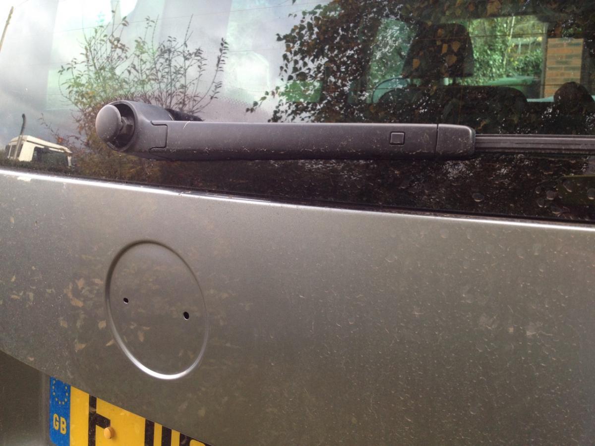

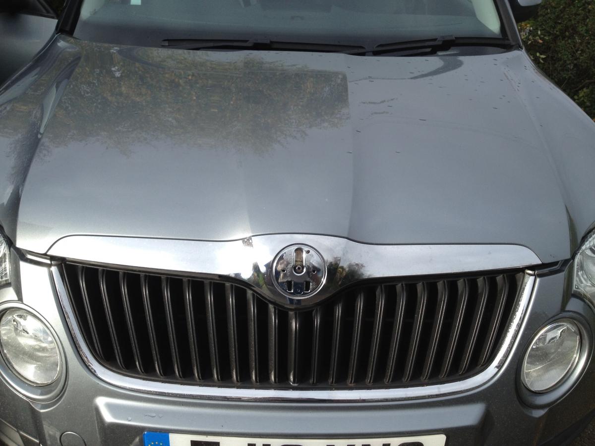

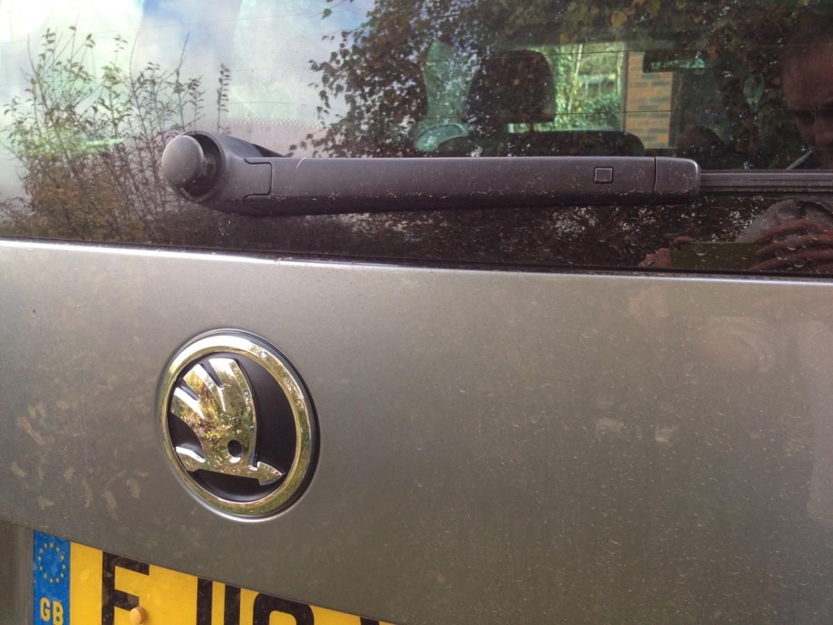

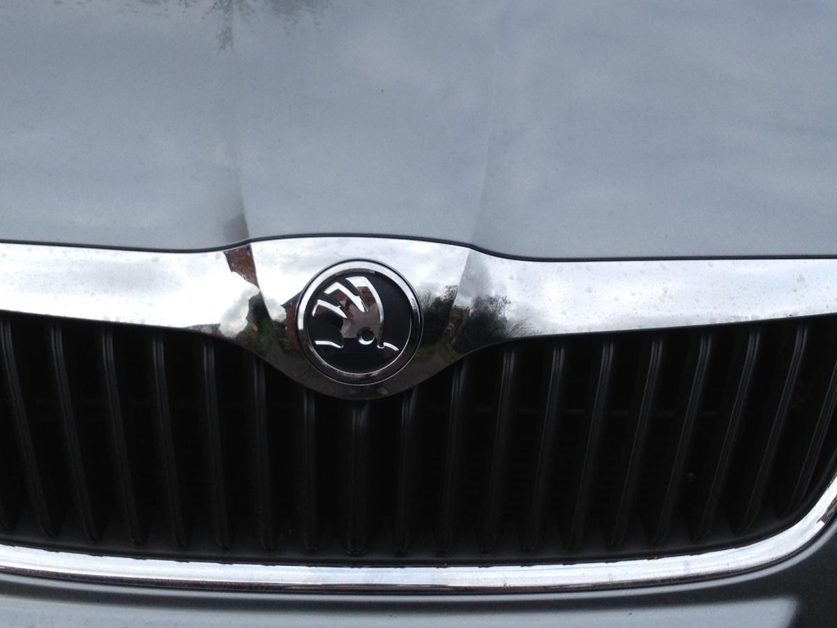

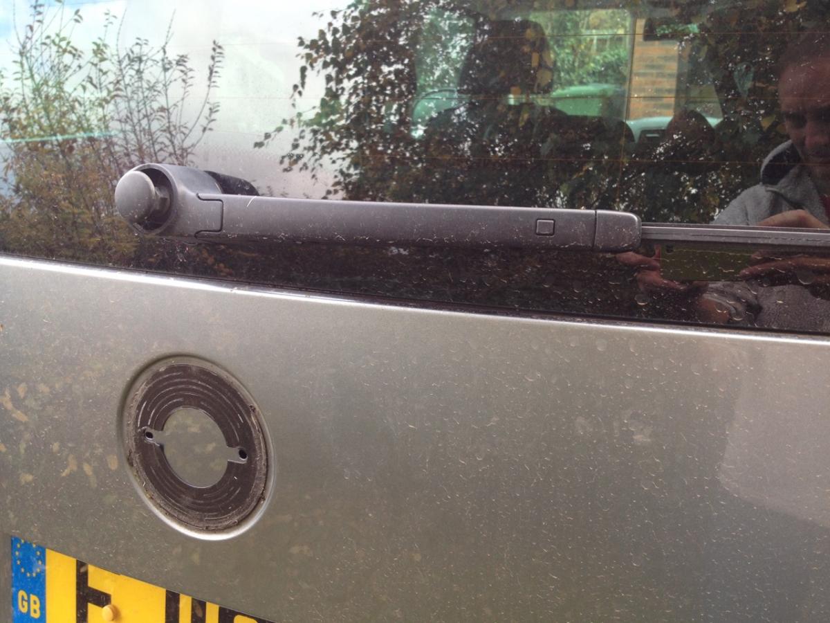

Managed to grab an hour or so to change the front & rear badges. Both the original green ones had white worm and I factored replacements into the discount from the asking price of the car.
Thanks to Silbury Skoda (via eBay) for posting them out within about an hour of my ordering them! Great service.
Here's the front looking naked!
And resplendent in new livery:
Part number: 5J0853621AUL
The secret seems to be sufficient heat from a hairdryer and Tardis / WD40 to remove the glue. I used a broad plastic trim removal tool with plenty of tape padding on the chrome trim to ensure no damage.
The back was easier initially as the badge has very little contact with the sticky pad (look at the rings on the black pad to see where it makes contact). Getting the pad off was fairly painless with some heat. The remaining glue came off very easily with Tardis.
