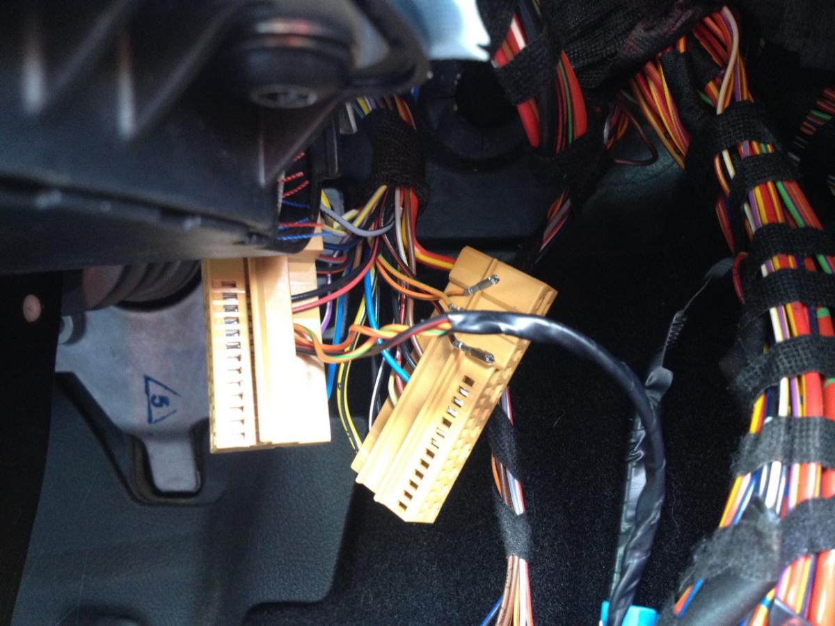

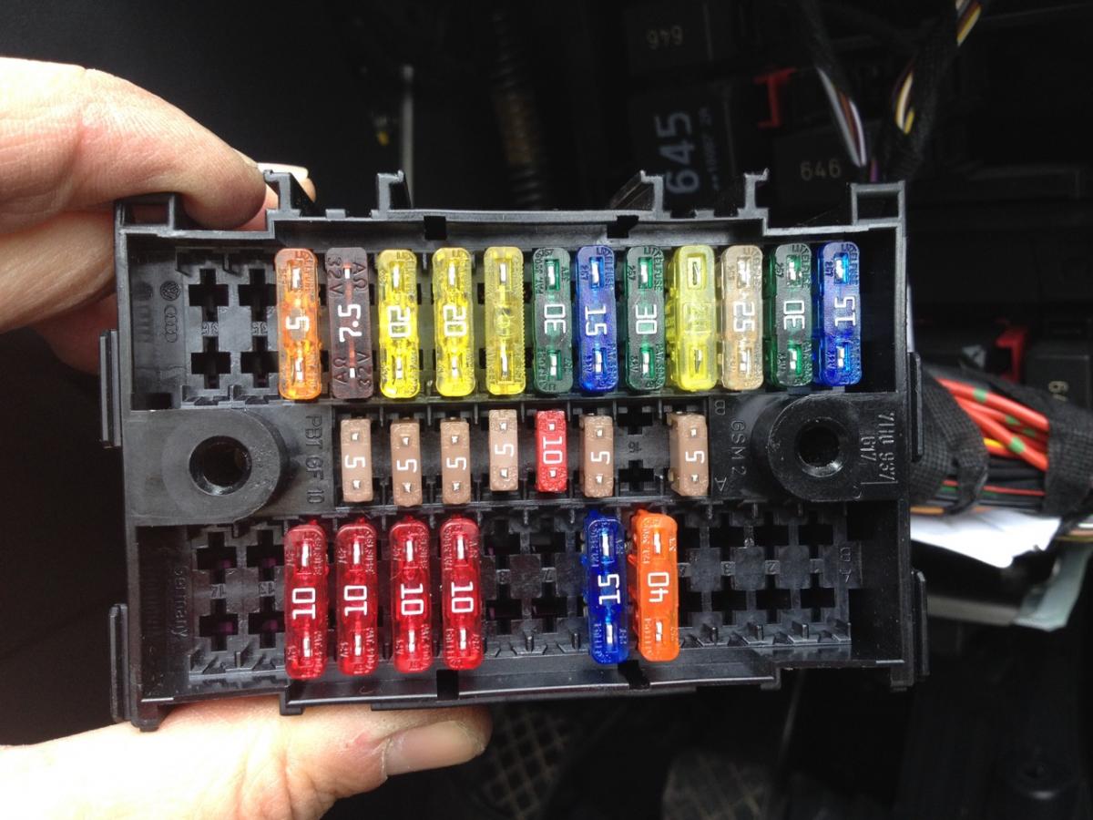

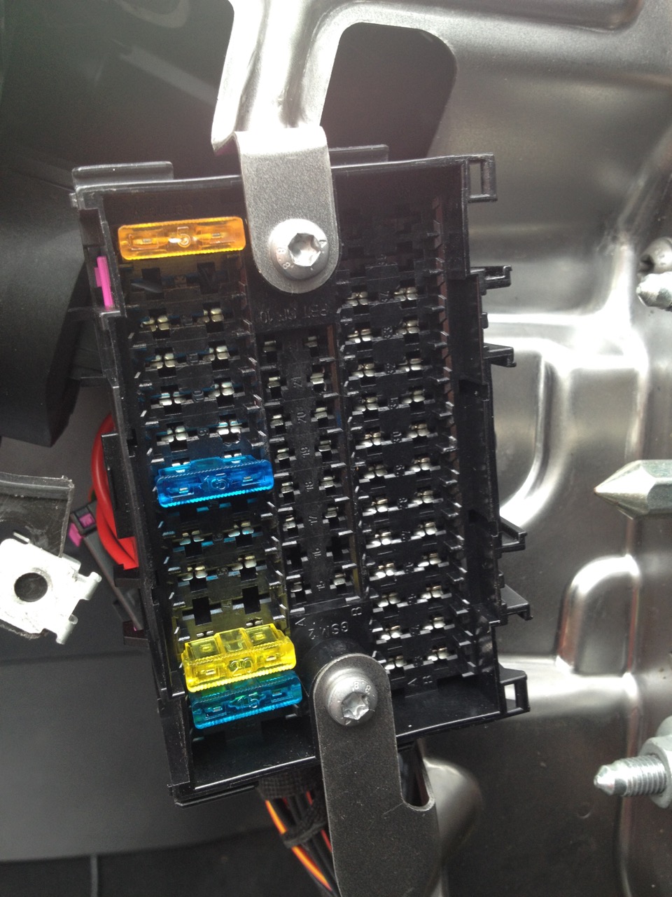

Photograph the fuse board before removing as you'll want to know which ones go where when you put them all back. You will need to remove them as you'll not be able to undo the pink retaining clip on the back to allow the terminals to be removed or new ones added.
Undo the two torx screws holding the fuse board in place and drop the board into the cabin.

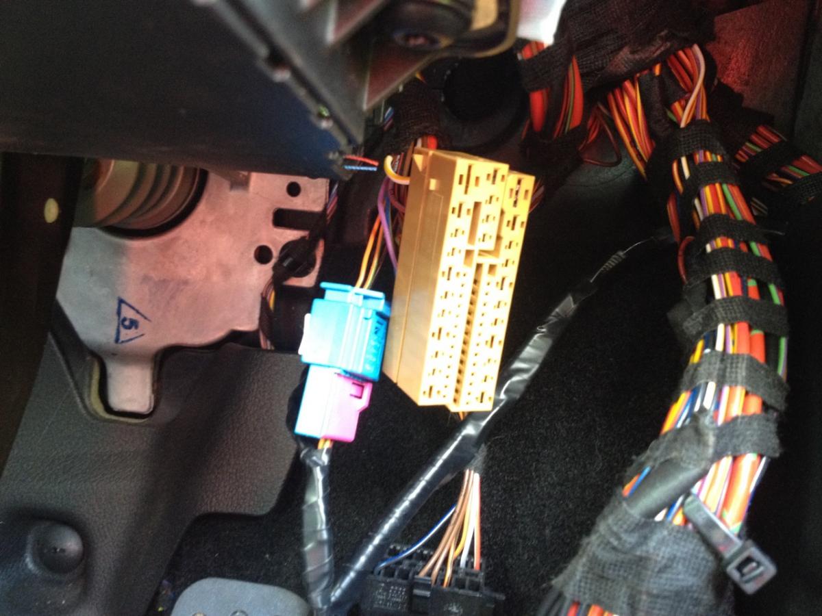

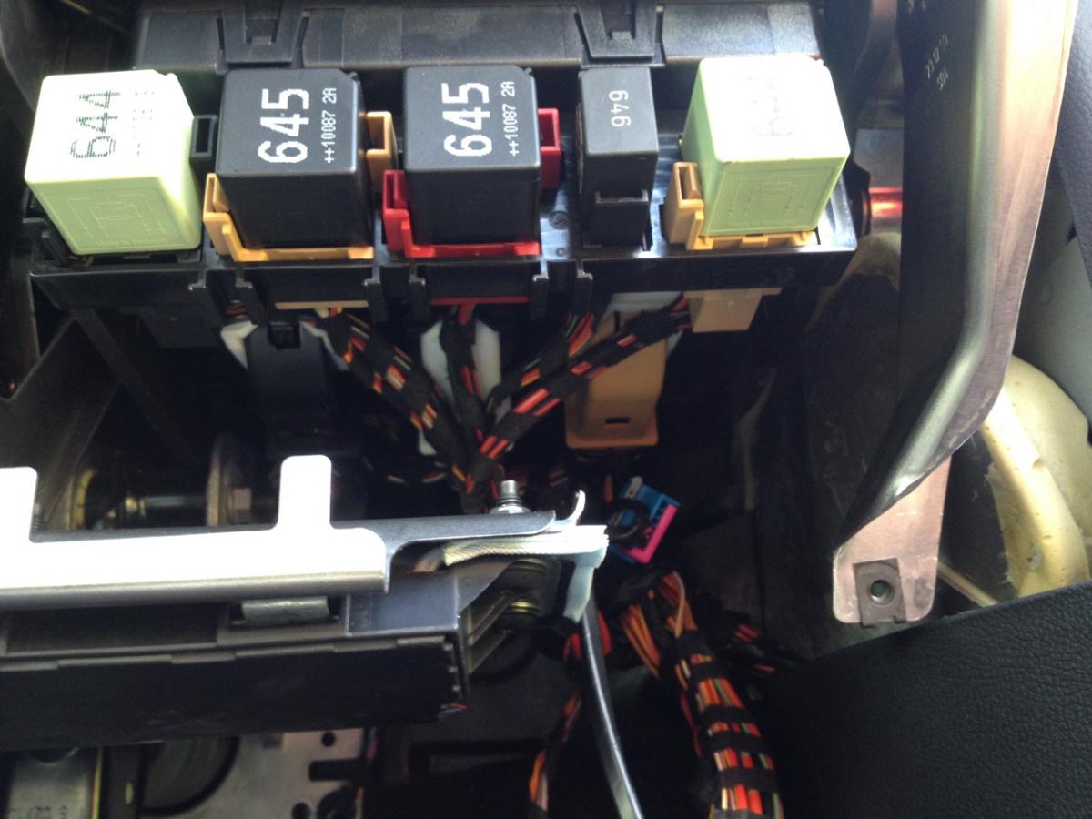

Locate the BCM (Body Control Module) which is behind the relays. You do not need to remove this, just unplug the brown connector on the right. It is labelled 'C' on the BCM, but I doubt you'll be able to see that. There is a little push tab on the end and then lever the white arm down. This also pushes the connector out of the BCM.

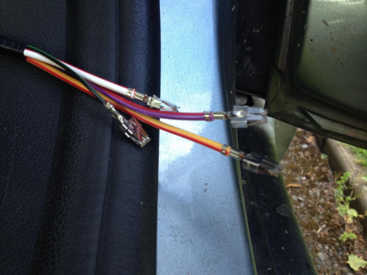

Cut off the cable tie and slide the terminal connector out of the cover / sleeve. Then separate the two parts to give you this:
Refer to the instruction manual very carefully to ensure that your remove the correct terminals from the block (15, 16 & 17). It is at this point that I had to resort to Google Translate as the colours are labelled as 15: or/gn, 16 or/br and 17 sw/ro. or = orange, gn = green but sw = black (schwarz in German) and ro = red (rot in German).
With the three terminal removed, insert the appropriate three cables from the new loom into their places and the three removed wires into the supplied new terminal block. Easy really.
You will need a tool to remove the terminals. I used a Laser Terminal Tool 3932 which worked well with the exception of the fuse board, but that is not done to the tool... In order to remove terminals from the fuse board you need to remove the fuses and also release the pink cage on the back. There are two triangular clips that stop it form sliding. these need to be released by prising the black plastic outwards and sliding the whole pink cage forwards. I really struggled with this and found that I could not move the cage forwards enough to keep the clips out the way of the terminals. Got there eventually, but there is obviously a knack that I didn't have.

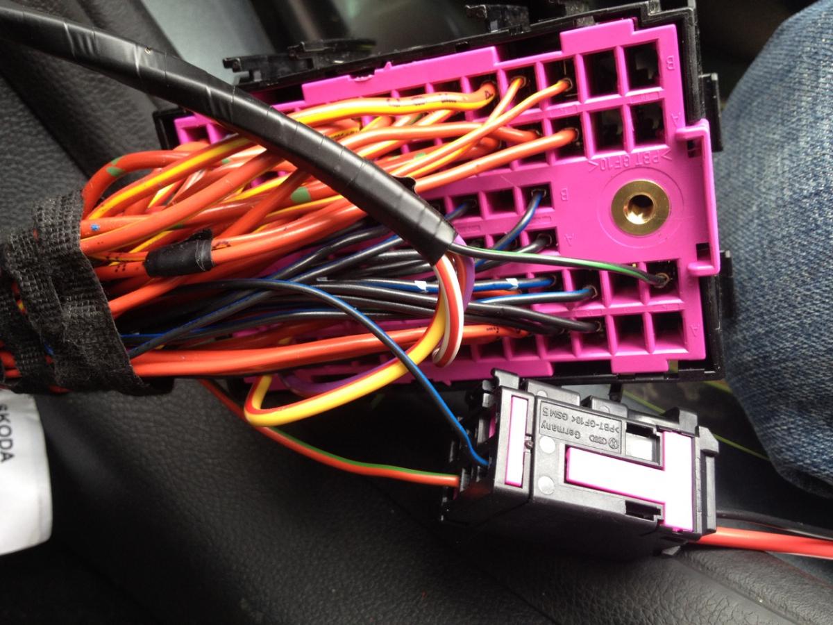

You'll now have four terminal from the loom to add to the fuse board and an extra mini-loom to connect terminals 21 and 9 into before connecting the other ends into the fuse board:

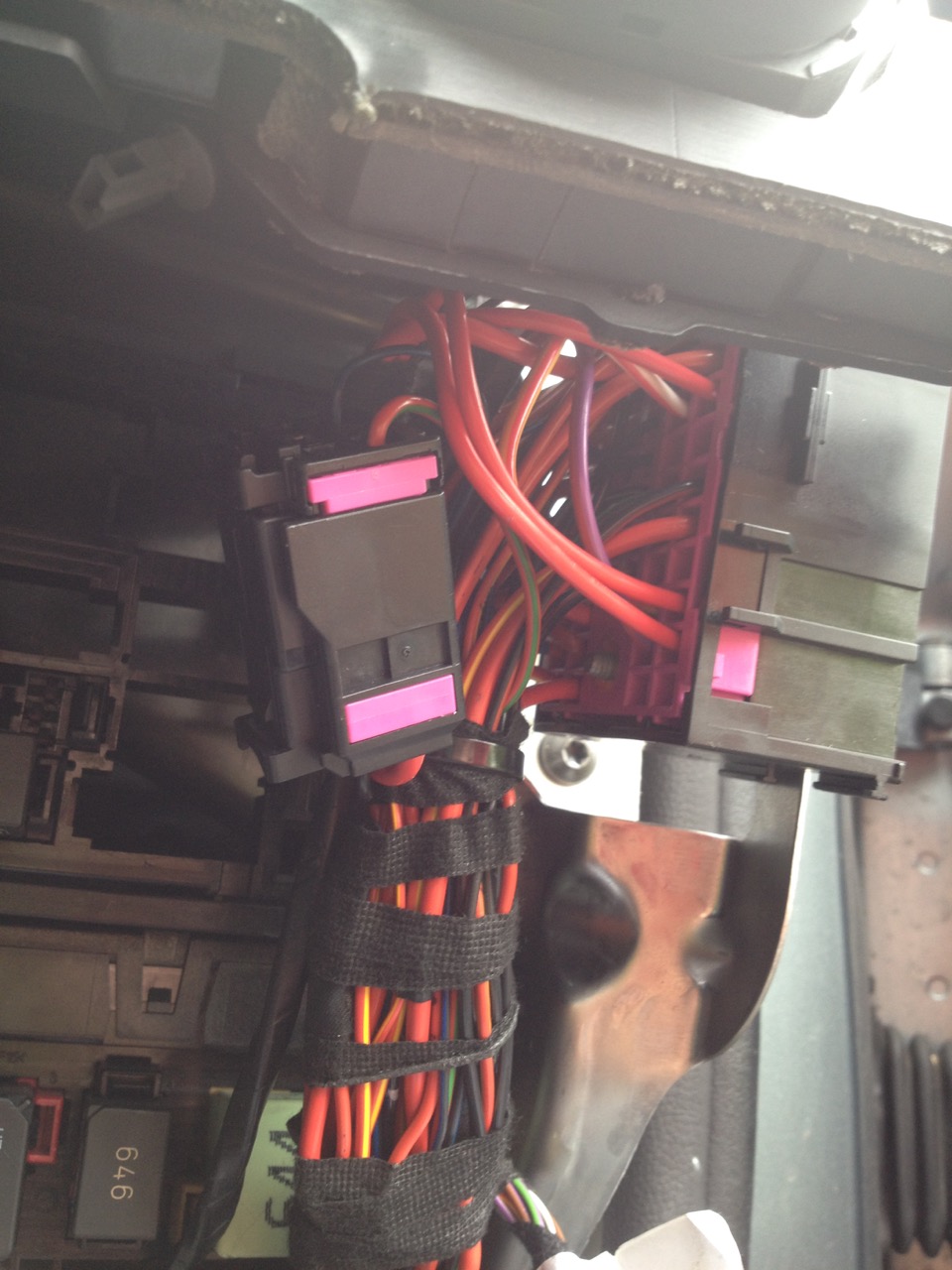

post-59543-0-24188800-1432811920_thumb.jpg  post-59543-0-48582400-1432811978_thumb.jpg
All wires inplace on the back of the fuse board. Do look very closely at the manual as this is reasonably clear. Although the diagram shows the back of the fuse board which confused me for a while.
I had a minor panic at one point as the wires are labelled SC2 li/ro and SC3 ge/ro. Again Google Translate to the rescue  and in German 'ro' is red, 'li' is lila or purple and 'ge' is gelb or yellow. Finally getting pins 2 & 3 the right way round and it was now going very well.
Here's the offending page in the manual:
The fuse board with just the extra fuses in place:
This brings me to my only criticism of the whole Skoda kit: the size of the connector to use at this point. For just two pins, the block can house 6. And is a large one. It all fits no problem (see second picture) but it seems excessive considering how good the rest of the kit is.

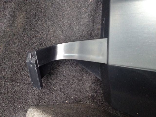

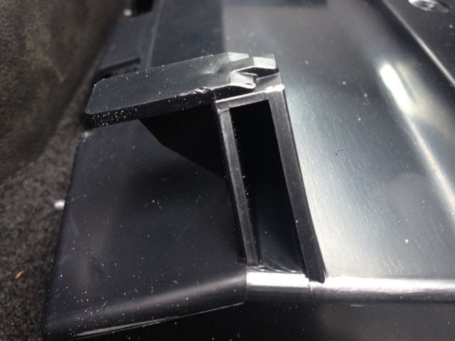

Carefully put all the trim back together ensuring the lower B-pillar is slid in from the front to the back - look carefully at the pins and you'll see what I mean. Put the fuses back and reconnect the battery.
You will need to reset the one touch windows (wind window down and press button again. Wind up and lift lever again. Repeat for all windows) and also the steering angle sensor fault (drive in a straight line for a boy 20 meters) and also need to recode the car using VCDS. As different controllers are slightly different I'll not give full details of mine, just check yours carefully on the instructions on the Ross Tech Wiki.

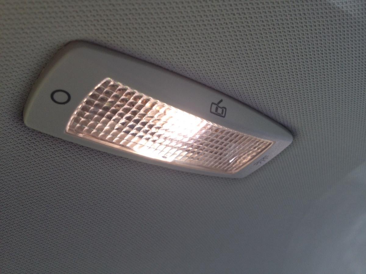

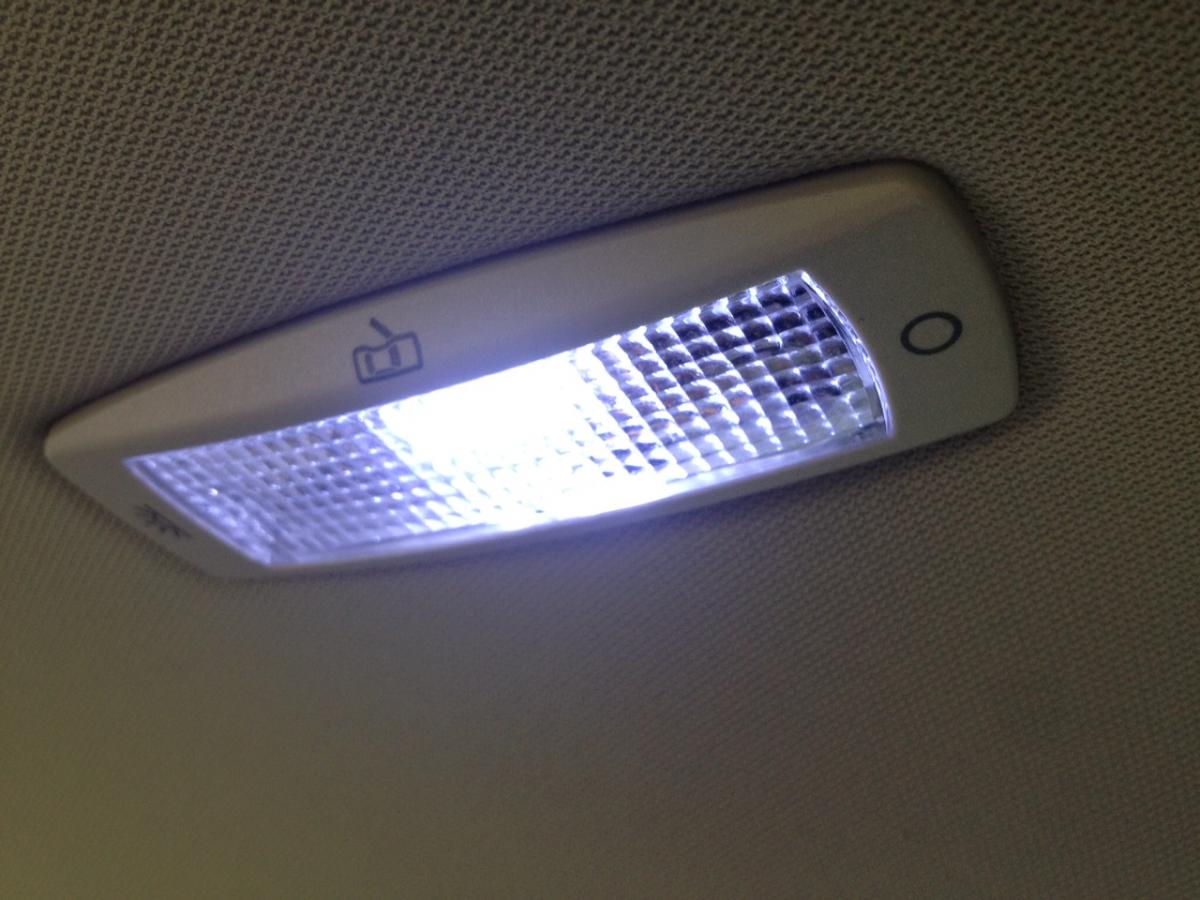

As if by coincidence, the next set of upgrades arrived in the post today after much deliberation and trial runs with inferior LED bulbs:
Ordered from PowerBulbs (a forum sponsor with our discount code) on Tuesday evening. Not cheap, but much better than the cheap ones I've used so far. And with free W5W sidelight bulbs (worth £14.99???)
Fitting is straight forward.
Osram Warm White 4000k 38mm festoon:
6400k cheap SMB LED 39mm:
And in the front (matching Osram 4000k W5W on the left, cheap 6400k SMB LED on the right):
I'll see what it is like after dark, but they are brighter than standard bulbs but possibly not as bright as the cheap ones in the rear, but the fronts look brighter (more directed light possibly?). However the colour is much warmer (naturally) and more pleasant to my eye than the harsh white (blue?) LED ones I had previously.
The 38 mm Osram bulbs fit without issue in the Yeti rear interior lights, the 39 mm LEDs needed one of the metal prongs to be bent slightly to accommodate it and even then it was tight.

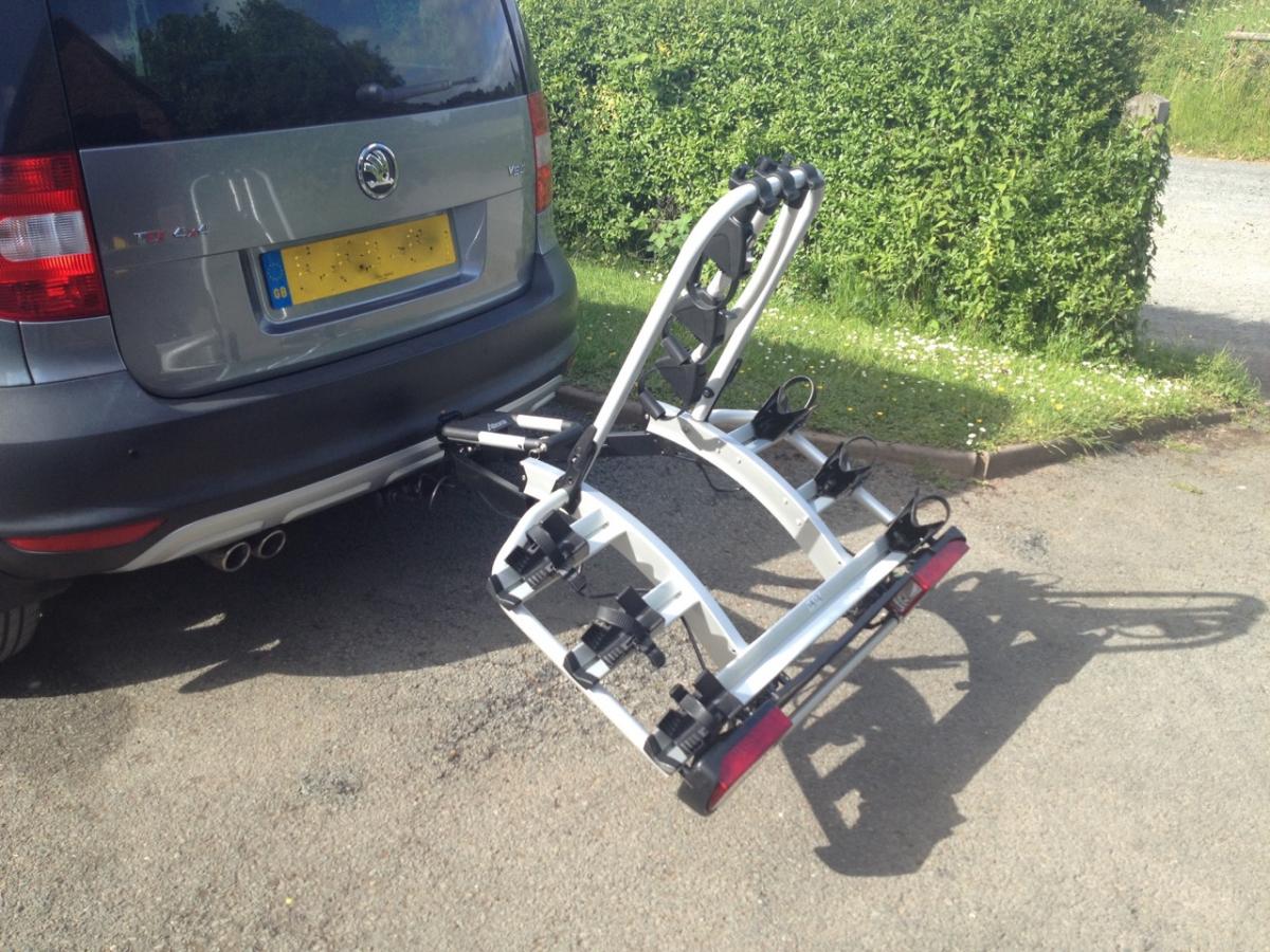

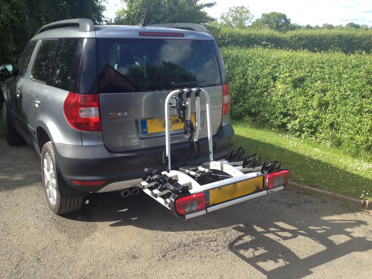

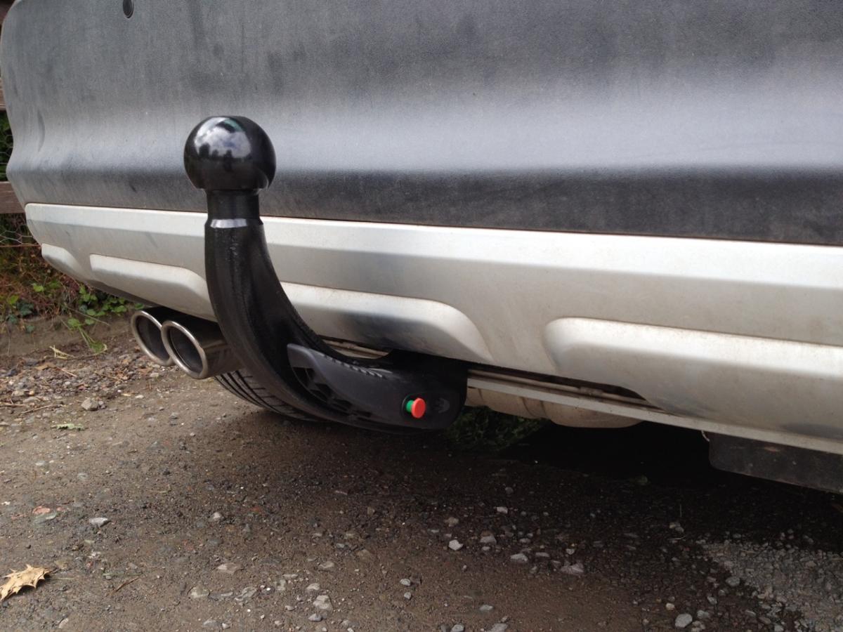

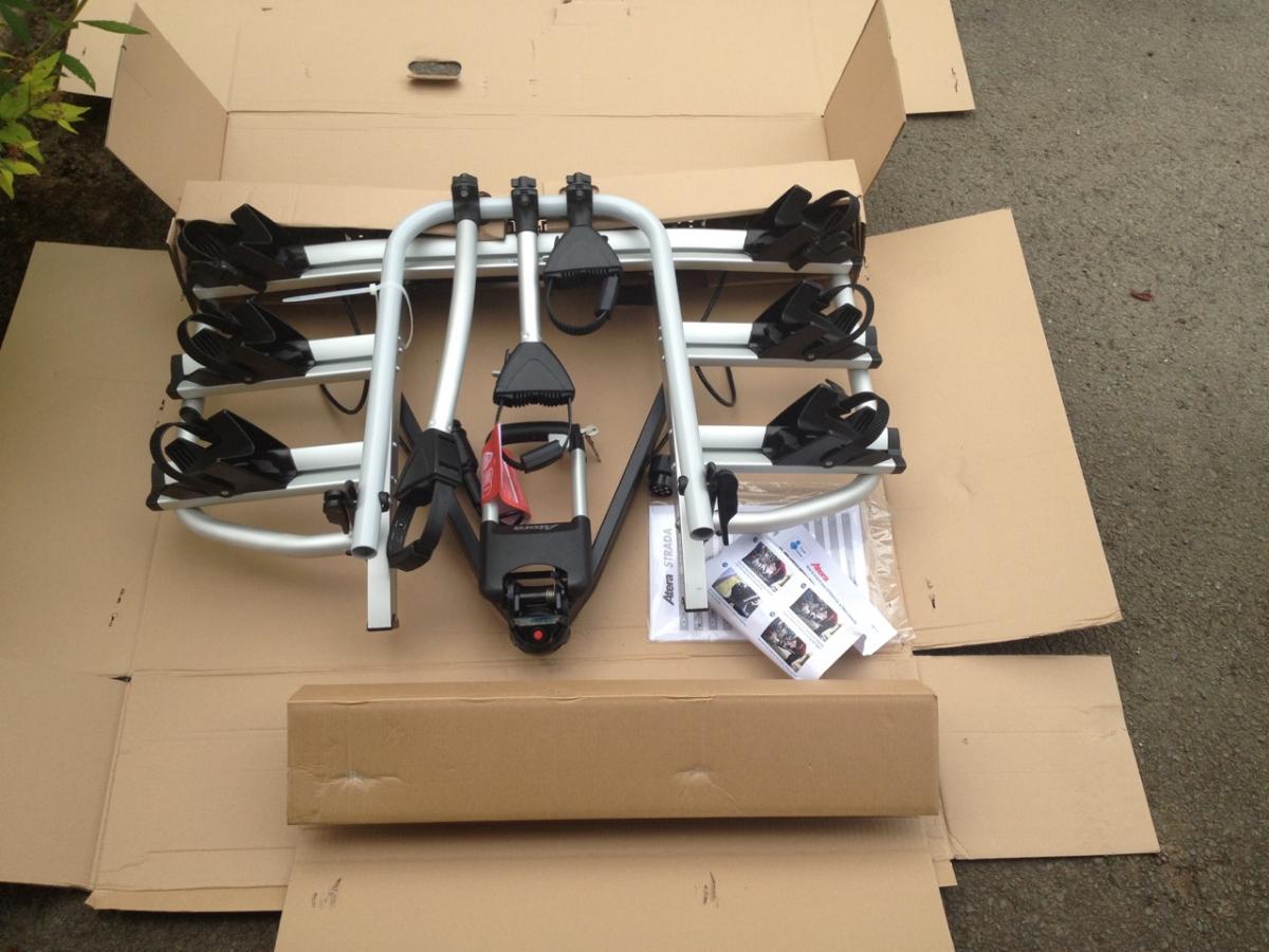

Finally made the decision between a small trailer with roof bars and four individual bike racks on top and a tow bar bike rack - and went for the rack: an Atera Strada DL3 with the fourth bike attachment (which I have yet to fit).

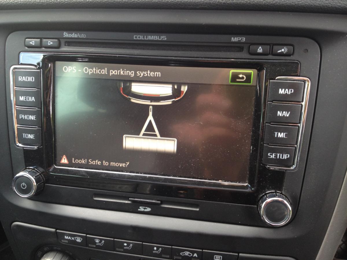

I fitted it today and tested the electrics:
  • The electrics did not go bang;
  • The lights all worked (including twin fog lights and reversing lights);
  • The OPS showed a trailer attached;
  • The parking sensors did not activate.
So I think that I did it right and am quite happy with the set up.
post-59543-0-83645800-1433524297_thumb.jpg  post-59543-0-71926900-1433524280_thumb.jpg
Let's hope the summer continues and I can get out biking with the family to justify the cost of the towbar and the rack.

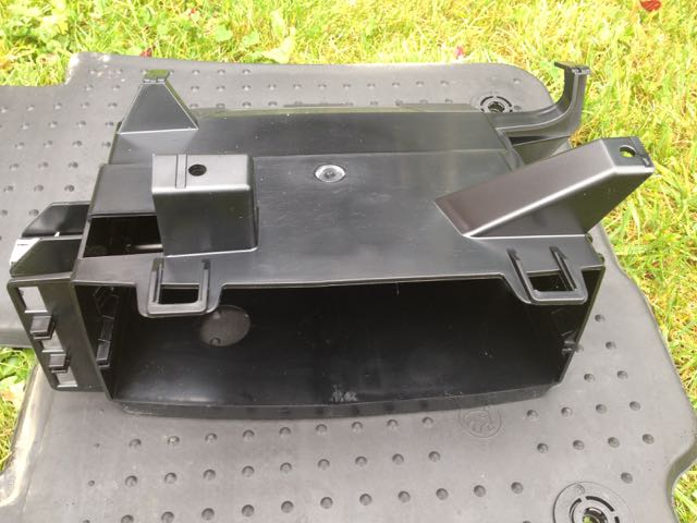

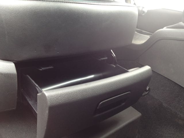

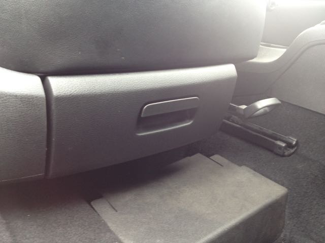

Latest addition is an under seat drawer on the driver's side. And what a pain that turned out to be!
Initially the dealer ordered the parts for the passenger side despite me making it quite clear that it was for the passenger side of a LHD Yeti.
That was a pain to fit and then I discovered that the extra parts I was told I would need (rubber stops and drawers slides) were actually fitted already to either the drawer itself or the frame! Wasted money there.
To make it worse, I had to go back to order two speed nuts as these were not fitted to the seat base and an additional hex nut as they had supplied two but three were needed. And the speed nuts were slightly too wide to fit in the paces on the seat base so I have had to bodge it, broke one and could not get the hex nut into the second.
Not the first time my local dealer has not been able to supply the correct parts even with their electronic parts catalogue...
Would I do this one again? Probably not; but if I did then at least I know what to look for in the future!
Under seat frame (5N0 882 600):
Both slides (5N0 881 203) were already fitted to the frame:
post-59543-0-21697400-1445248834_thumb.jpg   post-59543-0-14400100-1445248845_thumb.jpg
The rubber bump stops (6Q0 882 331) were already fitted to the drawer. While the catalogue says that four are required, I could only see where two were and there was no where else to fit anymore.

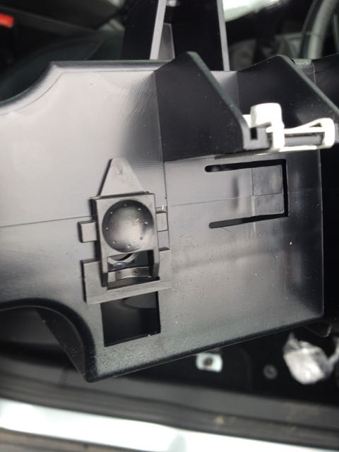

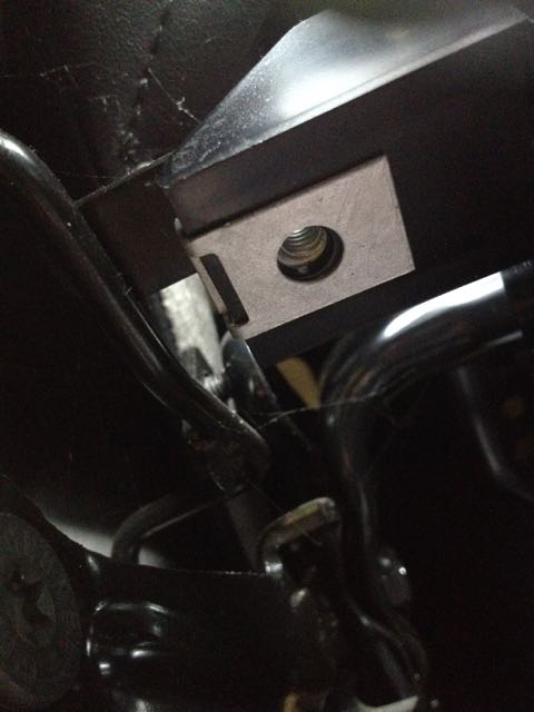

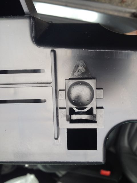

Fit the speed nuts into the seat base at this point. The ones I had were too wide to fit in the cutouts correctly hence why I ended up bending one and later discovered that the bit in the seat base had detached itself from the bit outside and was spinning. Fortunately, I had got the nut down up reasonably tight before this became apparent.
The frame needs to slide into these two guides on the seat base:
This one post-59543-0-03487100-1445249050_thumb.jpg goes here post-59543-0-13636200-1445248999_thumb.jpg
And this one post-59543-0-01754900-1445249514_thumb.jpg goes here post-59543-0-15856000-1445249006_thumb.jpg
I removed the seat and tilted it backwards in the car to gain better access.
One speed nut was already in place near the seat height adjuster:
The plastic side panel on the seat does get in the way and can be moved out if the nut near the speed nut is first removed. It is not quite visible in the picture below, but it joins the metal rounded bar to the plastic mount just above the speed nut.
Here's the finished article. Even though it only has two of the nuts fitted (the outer two), it seems very secure.

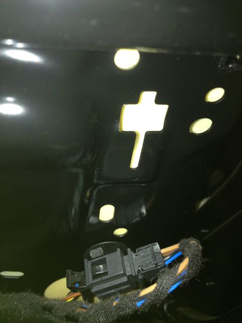

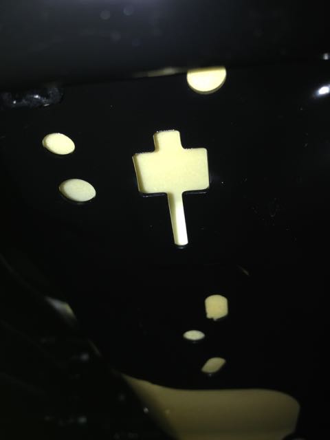

Finally managed to change the boot screen on the Columbus to the new logo.
Only the steering wheel badge to go... I have a Plan B (Plan A didn't work and Plan C is too expensive).
Pictures and info to come...

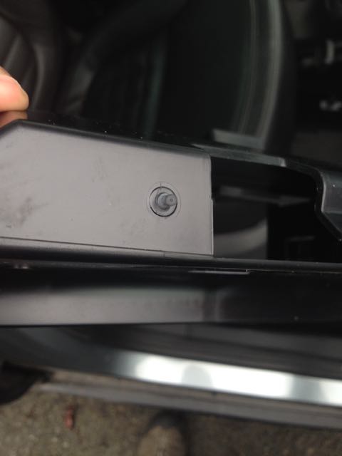

My crash bar was held in with three T45 Torx screws on the near side and four on the off side. All were quite easy to undo and the crash bar quite easy to remove in comparison to my Octavia estate which had lots of 'gunk' holding it in and blocking the Torx heads.
post-59543-0-79889200-1432759038_thumb.jpg  post-59543-0-19899200-1432759061_thumb.jpg
After cleaning up the area where the crash bar was and putting the bolts back in the holes I would definitely spray it with Waxoyl (£8.99 for 800ml from Halfords). I did this later and found it awkward to cover the area evenly working around the fitted towbar.
