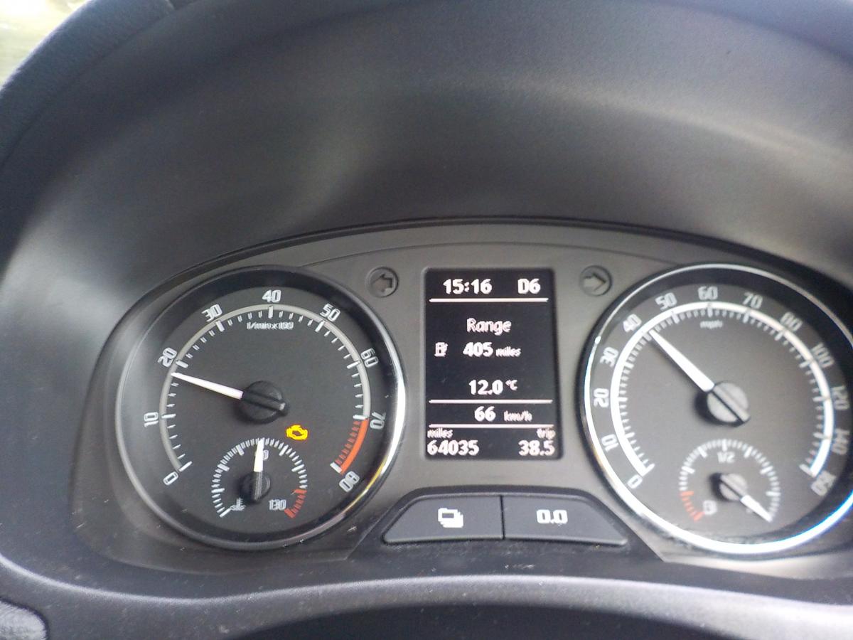

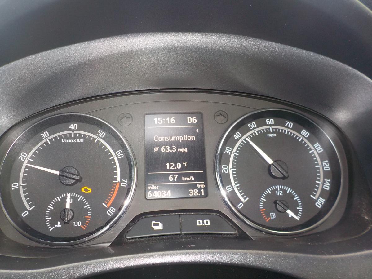

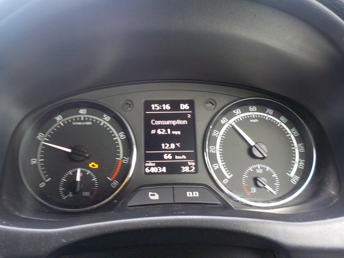

So i have my old car back to get in fixed in the 3 weeks before it is needed again.
The best MPG you can probably get is with one in limp mode with the Turbo Inhibited.
I had to take it into the Skoda Dealership to speak to the Master Tech and book it in for the £85 Diagnostic (& thats just the start of the cost to repair obviously.)
So Fault Code P10ADA
Magnetic Clutch Active for mechanical charger-open circuit.
Runs just fine only there is no Turbo.
So a 50 Mile round trip with it brimmed before i went and i was just keeping it to under 2,4000 rpm and it was showing low 60's mpg which is just what is in the dash,
so i went and put petrol in to brim it again when i got and could only get 4 litres in.
If it was not for the need of a Turbo and the need for speed occasionally i think i would run one in Limp Mode as a daily driver.
