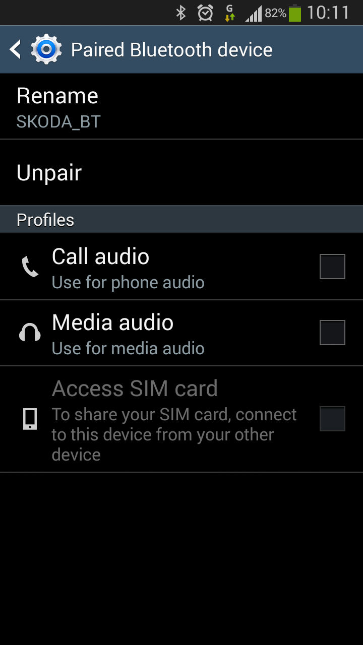

Checking this morning, when connected to the car the following options are checked from the bluetooth menu of the phone..
"Media audio"
"Access SIM card" - As it is connected via Bluetooth Premium/rSap I expected this to be ticked ..
The Phone audio is unchecked and will not allow me to tick the box... but the phone works OK for calls in and out ..... maybe because it connects using rSap?
I have now unchecked the "media audio" setting to see if makes any difference to the disconnects, as I do not use music streaming anyway
Anyone had issues with having media audio ticked? I am sure I have read that having the "media audio" checked can cause issues...
Will see how it goes today  all I have ticked now is "Access SIM card"  :)
I did try the phone after un-checking and it still makes calls OK :)
