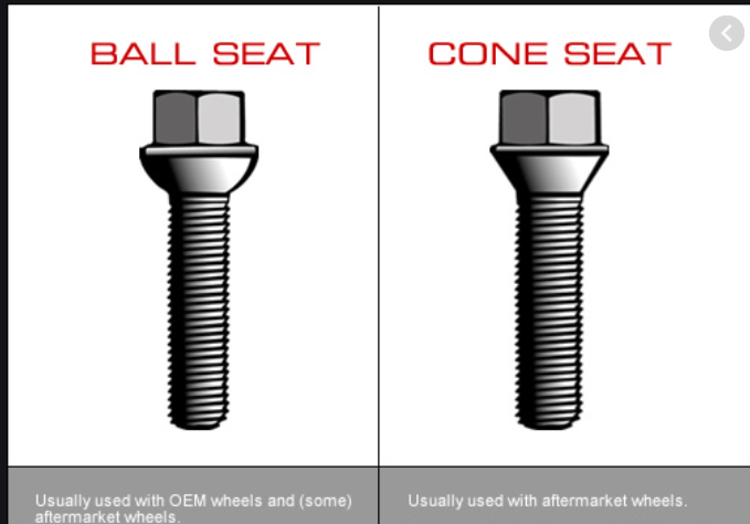

Look closely at the bolt hole seats on the wheels to see which of these two types of bolts will fit the seats correctly. If you can't tell, take a good close up photo and post it here.
Standard VW group bolts are radius/ball seat.

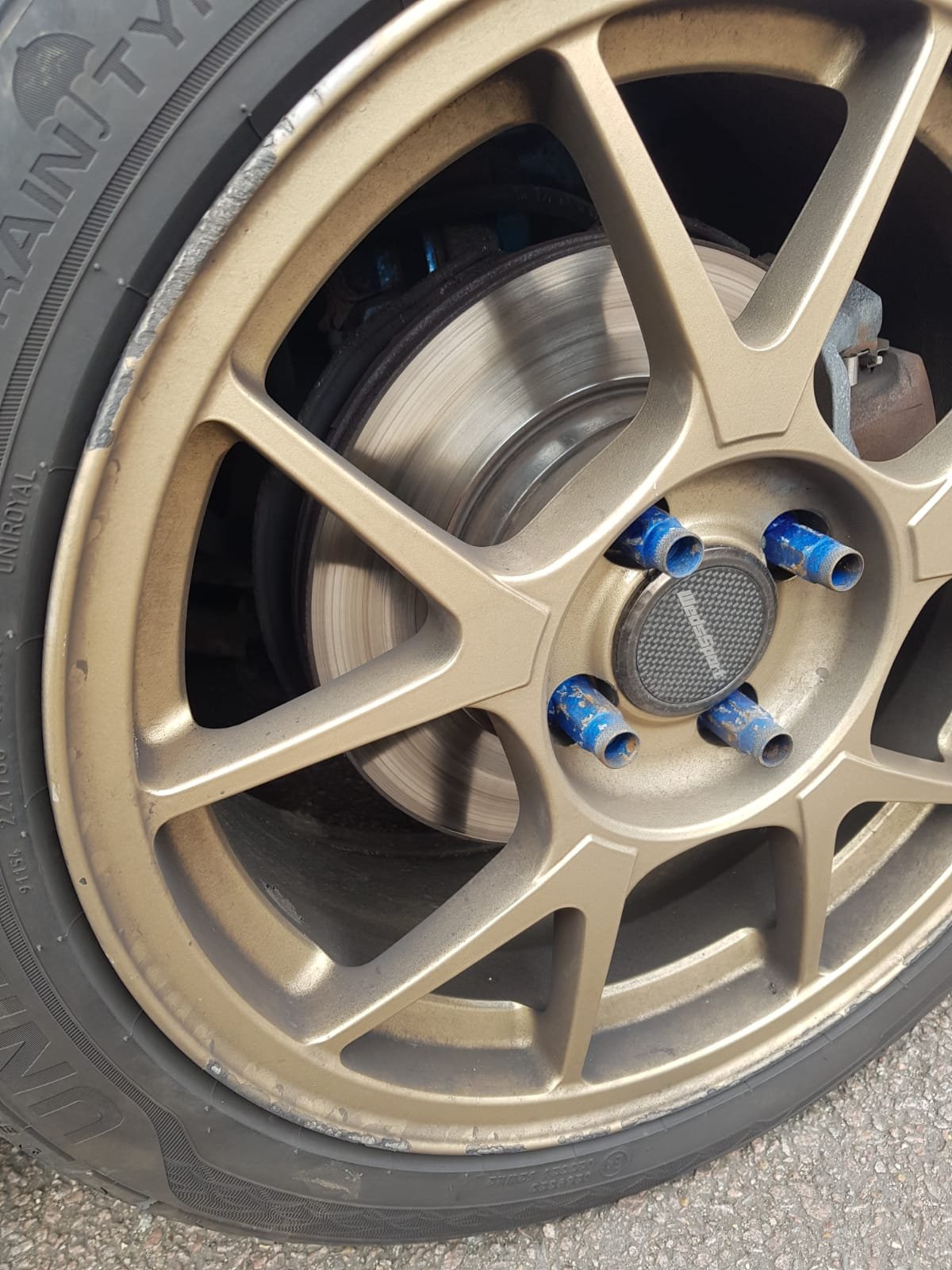

Old pic, not sure if it shows?

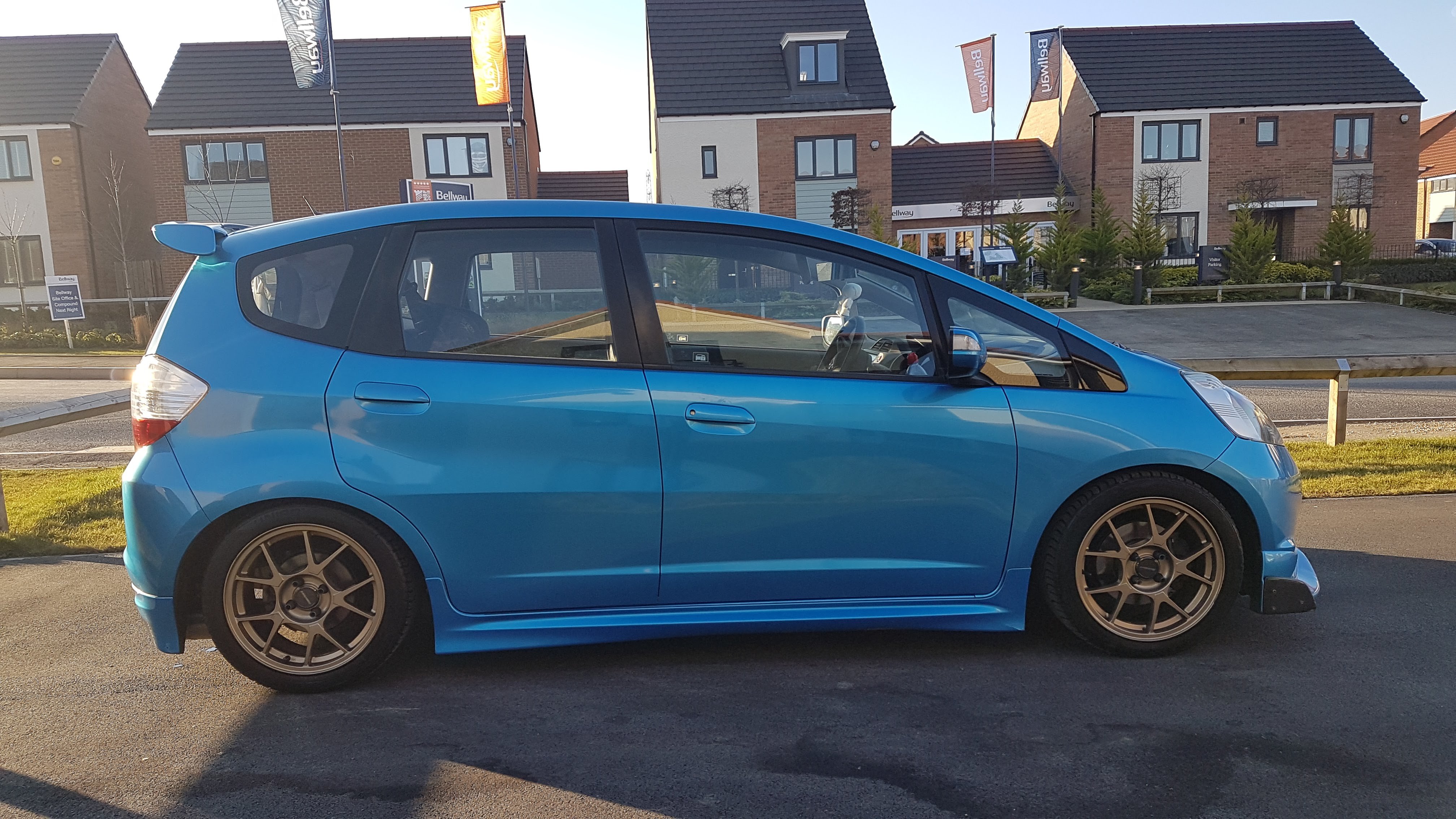

16" 4 x 100 ET 35 so i believe they will fit the Go
Hint - The bolt holes are full of bolt.
Honda Jazz uses 56.1mm centre bore, Skoda Citigo uses 57.1mm centre bore. So 1mm too small and won't fit.
These Alcar 6795 (5Jx14 ET35 4/100 57.1) will fit:
Full of Nuts.
8 hours ago, Garyman said:
In previous cars i've had, they had been wheel NUTS
Do you have a photo of the wheel nuts and the wheel nut hole with nothing in it?

  with what size of tyres on?
Rainsport 205/55/16

11 minutes ago, Garyman said:
Rainsport 205/55/16
The photo doesn't look like 205/55R16 (the sidewalls are far too low), more like 205/45R16.
