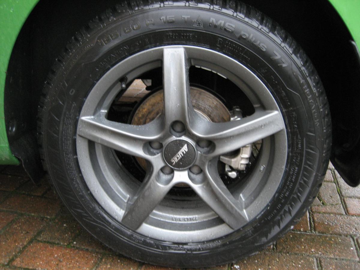

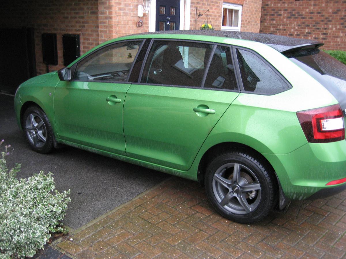

Not the best photos, weathers rubbish as is the camera I used but taken a couple of very quick shots of the green machine with its winters fitted;
Car and wheels are darker in colour than the photos would suggest in the current light conditions.
Wheels are Alutec Grip in the correct OEM size of 6J x15 ET38 and made specifically for mounting on VAG hubs, so no need to change wheel bolts, fit shims etc.
Tyres Uniroyal MS Plus 77 185/60 R15 84T. Did debate going with the 195/55 tyre, as its also an approved winter size but decided to stick with the narrower profile in case we seriously get dumped on with snow this winter.
Handling is obviously not as sharp as with the factory 17's but the ride is smoother and quieter after the noisy Dunlop Sport Maxx, even with the Uniroyal's fairly aggressive directional winter pattern.
Liking the darker coloured alloys with the rallye green and black detailing :think:  but again after having the 17's on from new the OEM 15" set-up looks under wheeled for the car, however practically its the best option for the winter road conditions round here.

It was the change in handling on the higher aspect ratio tyres, as the lower speed rating that I wanted to avoid so stuck with 17" and V rated.   Not sure how much worse the wider tyres would be in snow than 185s, hopefully fo rme not too bad.  Big fan of winters but use Nexens for All season, Summer and Winter variants.  Safe and enjoyable motoring.
Had debated sticking with 17's myself and may yet in the future give that route a try, however my experience with 1.2 HTP/TSI Fabia's in the snow tends to lean me towards a skinnier tyre, as there's little weight in the petrol variants unlike with the diesel, so even with quality winters they can still fairly quickly loose traction.

I think it the amount of good square edged tyre that makes for the gripping in snow so, as I said before, the choosing of 16/17" and 205/215 size over 15" and 185s will make next to no difference in the white stuff.
