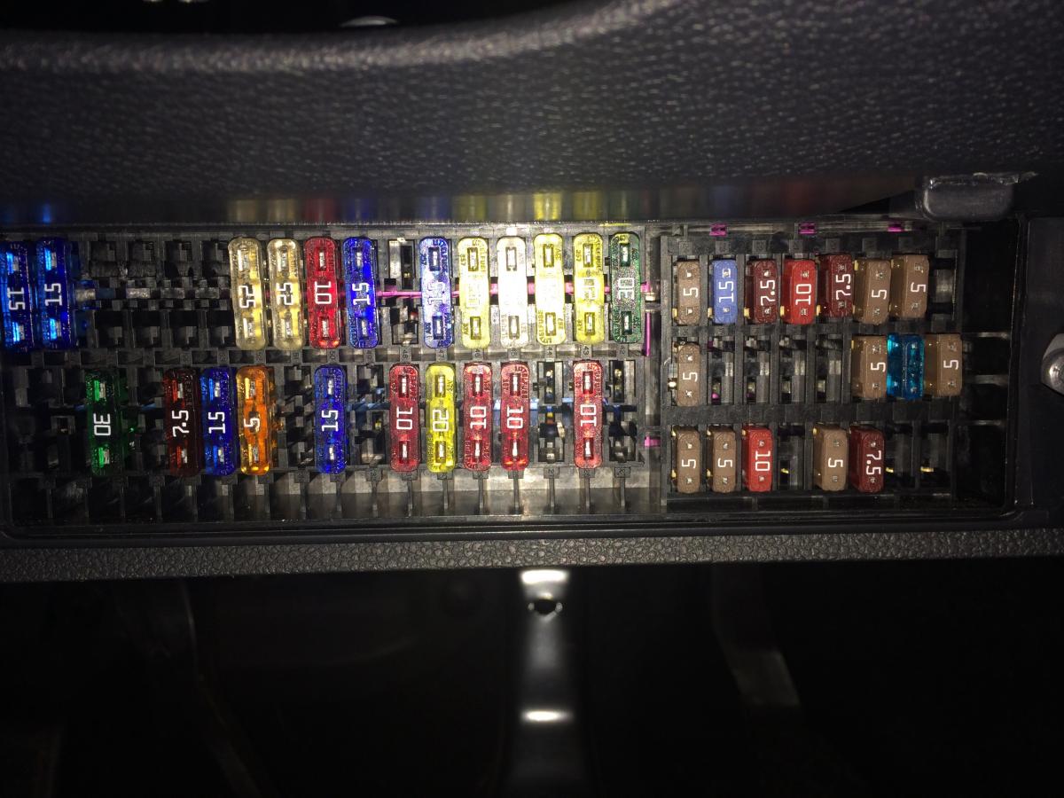

Here you go mate.
Middle row, second from the right.
Mini 15a
the one on the pic that doesnt have a number on it, as i blew it whilst replacing the boot bulb. So thats the only new one. The rest are original
Thank you very much will have a look in the morning, and I'm so glad to be out if that C2. French cars [emoji40][emoji40][emoji40]. Oh and if it's middle row 2nd from right that mean it's the blue one between the two brown #5?

Yes blue one between the 1 browns.

Ive opens my fuses up and I don't have that blue fuse at all so it's not that one :/. This is what I've got

Done it was only a fuse on the right hand side 2nd one at the top bloody things but I don't understand why it popped. But that fuse runs: rear lights/side lights and number plate lights.
Wonder why its different to mine then :s.
Would of thought itd be the same? What years your car?
Differences because the vRS has Sidelight / DRL units as one.  DRL Inhibit switch.
