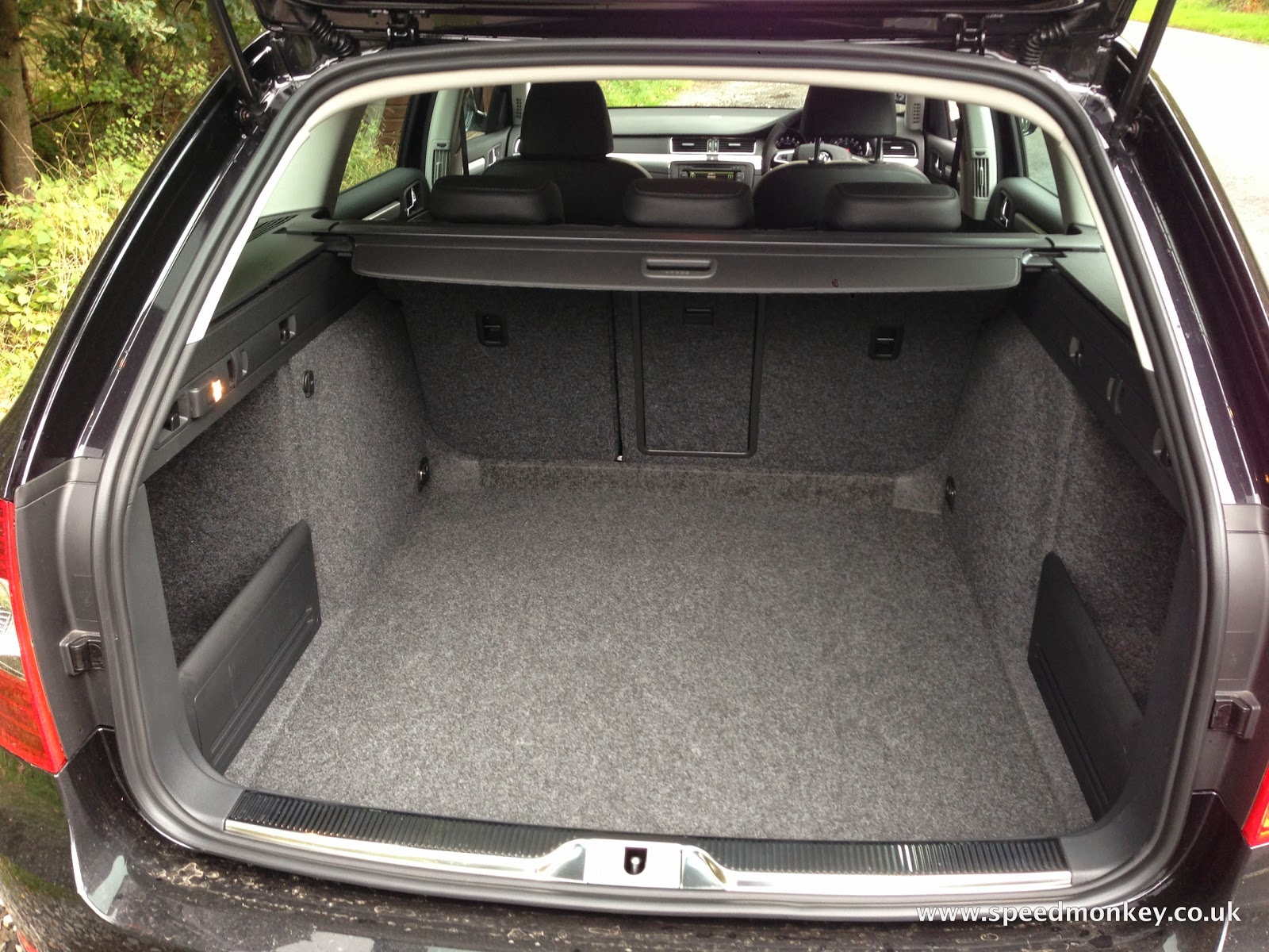

What I would like to acheive is something like in this picture. Are you saying that there are rails for this too?
Edited by josj
This is what the standard boot with rails looks like
Edited by JakeBlade
How much lower than the opening is that floor?
The width of one iPhone 5 - about 6cm.
