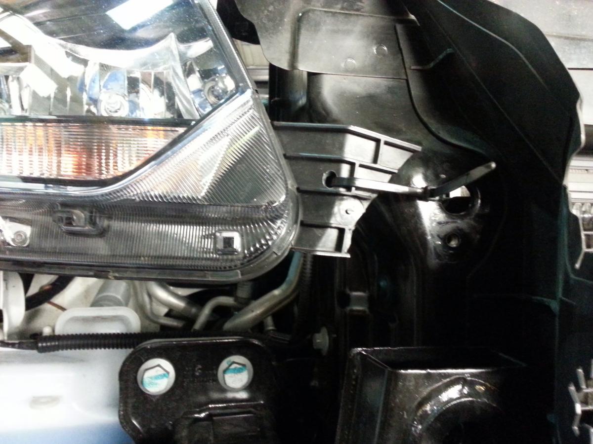

While at Shark today we made a discovery, the dealership had broken my headlight!!
Let me explain, a couple of weeks ago i had to go in as id lost a bulb inside the headlight unit, it was a bumper off job to get it out and as it was my fault left me £80 worse off, expensive mistake.
While washing the car the other day i had noticed that the headlight they had removed wasn't lining up properly with the bonnet, i just assumed something hadn't been screwed back properly and was going to call them up.

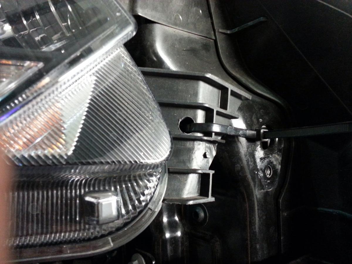

Today the guys found that the bracket holding the headlight had been snapped and they had attempted to secure it in place with tie wraps!! and hadn't replaced one of the bolts on the other side. The only thing left holding it in place was one bolt and a tie wrap!
Ive called the dealership who were very apologetic and are picking the car up tonight to sort it out, problem is, I'm not sure i trust them with the car anymore!

100% contact Skoda UK, not only should the dealer be refunding you the £80 to remove the loose bulb they should be replacing the headlight FOC and of course be offering some sort of goodwill gesture, a free service for example.
For allowing a car to be bodged in that way should see disciplinary action taken against either the technician or the service manager.
Something has gone very wrong here, either the technician has been too afraid to tell the service manager of his mistake, or the service manager was trying to avoid the cost of a new headlight.
No wonder the service manager was so keen to collect the car in person, his corner cutting has been discovered. Make sure you speak to the dealer principle and let him know what his workshop is up to.

Bracket failure is very common on some models of VAG car, there is a repair kit for virtually every model and therefore no need to replace the light. I fitted the repair kit to my previous Audi and all was good again.
Replacing the light can have a negative impact at resale as it looks like the car may have had a frontal impact because of the difference between the two.

http://workshop-manuals.com/skoda/fabia-mk1/vehicle_electrics/electrical_system/lights_lamps_switches_outside/headlight_xenon_light/replace_headlight_fixing_brackets/
No part numbers there but the beasts exist! At least for the Fabia Mk1. Unexpectedly pragmatic and helpful.

The service manager waited outside my house last night for an hour, I was late getting back due to witnessing an accident (truck pinned a Fiat 500), he was very appolagetic and left me with a Skoda Rapid 1.6tdi.
I had emailed the owner with the pictures who went straight into action and even called me up at 11:30pm last night to check I was OK and appolagise again.
By 12:30 today I had a call to say that the technician responsible had been confronted and confessed to everything. The headlight has been replaced, car valeted, filled up with diesel and the money I had paid out has been refunded.
Mark Mitchell (the owner) had the technician bring the car back to me at 3:30pm and apologise in person to me for his actions. He simply said that they were inexcusable and had brought himself and the company into disrepute, he is facing disciplinary action at work also.
I really felt for the guy, we all make mistakes, some easy, some hard, unfortunately for him this is one of the hard ones he won't forget.
I'm happy with the outcome and the way the dealership has delt with the situation and the technician responsible.
Due to the way this has been handled it hasn't put me off Mitchell Skoda at all, in fact it has shown me that they are open and transparent when issues with their staff are brought to light.
