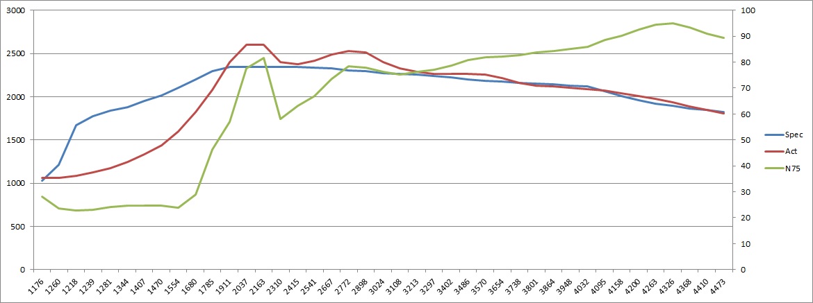

2.0 140 feels underpowered, help please
For what it's worth your boost looks ok at least.  I think it might be a tiny bit less than I've seen. I will compare your values this evening (dont have my logs on me) and report back.
I think I remember seeing a boost value of 2601 at peak.

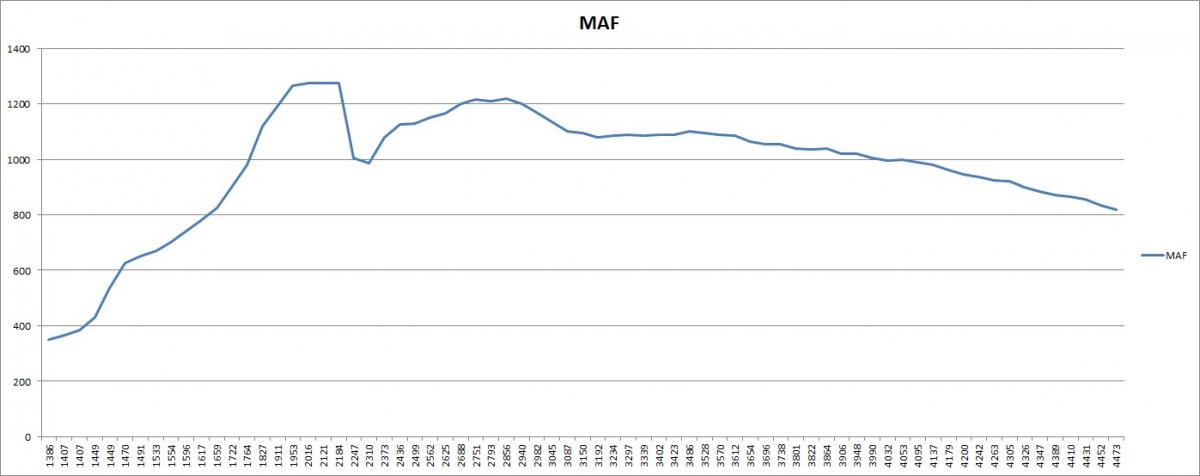

Your MAF values look ok to me from what I remember, 1275 peak.
Thanks for the logs, they do look very similar to me, although it is a bit strange that the peeks are on both logs the same (2601 and 1275)...

I have just reviewed the whole thread and your logs.  Your turbo min and max values seem fine although there is some significant variation in requested and actual boost (could indicate sticky turbine vanes (I am aware you have cleaned them) or a leak in the pipe work / lazy valve or turbo actuator). MAF and coolant temperature sensor look ok too. Although I would be tempted to disconnect the MAF and try it out for a while to see if there is any improvement (now you have access to VCDS you can easily clear the fault it will generate).

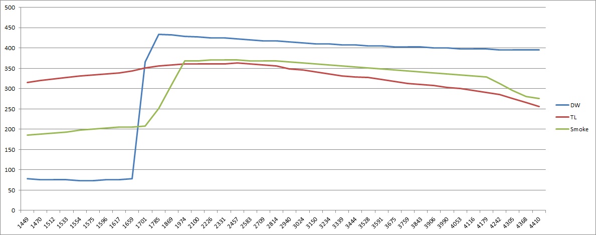

Well, have done the logs as per Johns instruction but screwed up MAF as I just tested how exactly logging works and forgot to select rewrite file on hot run so the log is from the test drive (and not saying much). Will log it again on Sunday. Don't understand group 8, 9 and what group 13 suppose to do but 11 (boost?) looks good to me which suggest turbo is fine?
Anyway have a look please. Thanks in advance.
Sorry for the delay. Been very busy.
All looks good to me. Nothing is restricting the fuel. Torque limiter is the lowest fuelling request which is by design. Boost is a little wavey but then follows requested.
Right so did second run to log group 3 properly, please see the results and comment.
Again fine. Its peaks and then dipped at the beginning which is due to the boost over boost. This isn't normal really but it wouldn't restrict fuelling/power.
