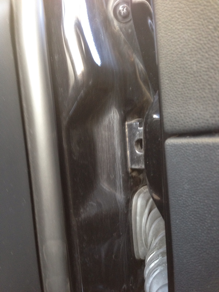

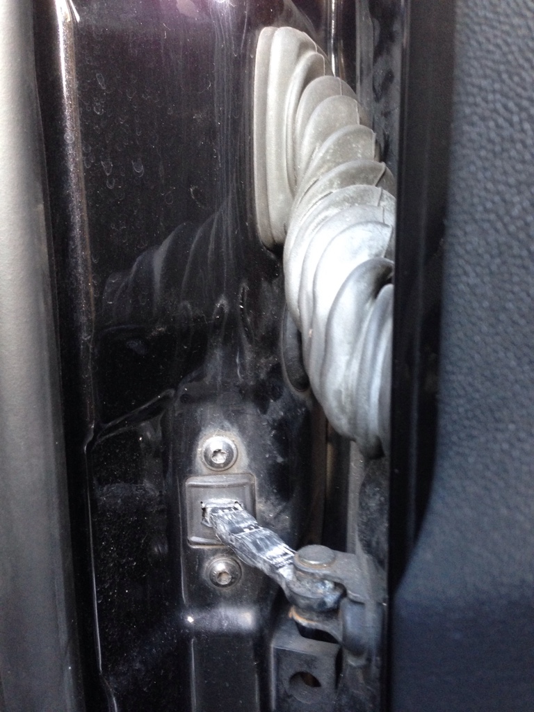

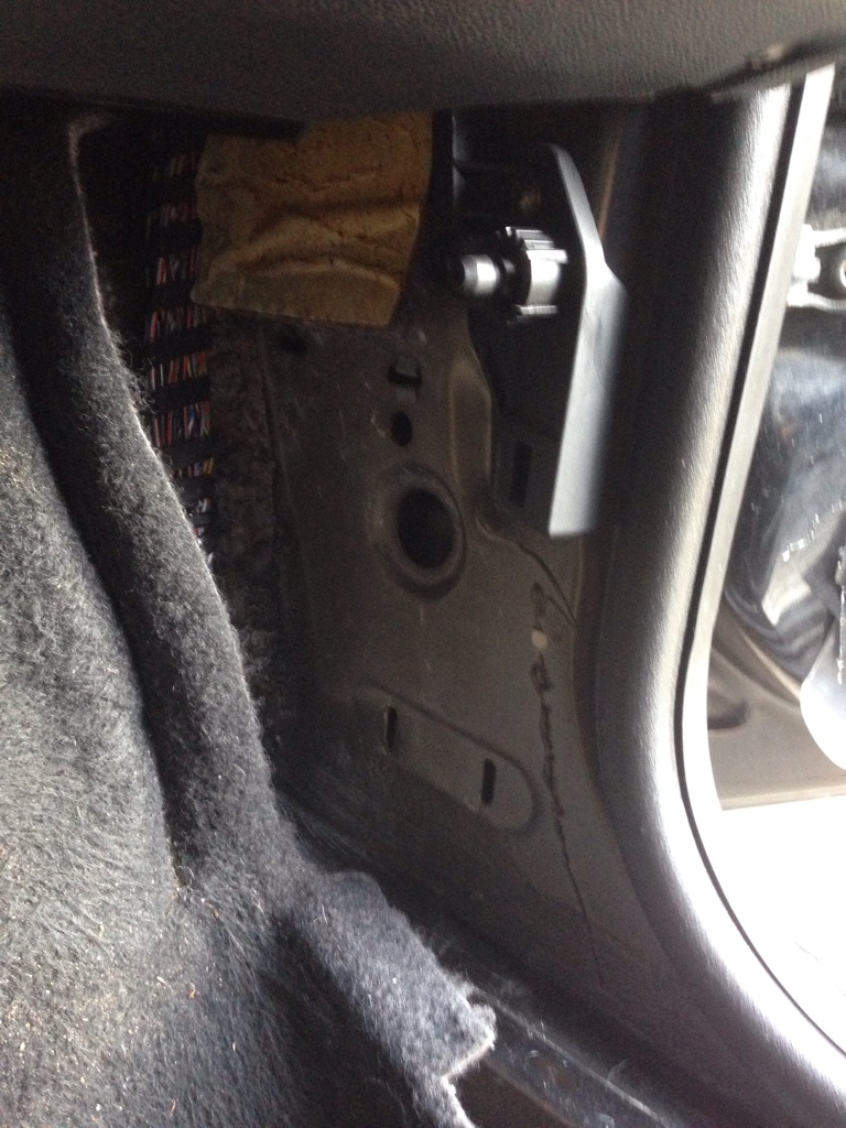

In my quest to discover why my drivers front carpet is ALWAYS soaking i decided to take the kick panel off (where the bonnet release handle is). My doors are 100% dry so its not the usual thing. Upon removing the kick panel here.....
And pulling the rubber bung out i noticed this.....
For those of you who are eagle eyed enough that is a god damn pool of water trapped between my inner and outter wing or door shut of what ever you want to call it. What i want to know is A. Where is it coming from and B. If it is supposed to do this where are the drain holes so i can check for blockage.

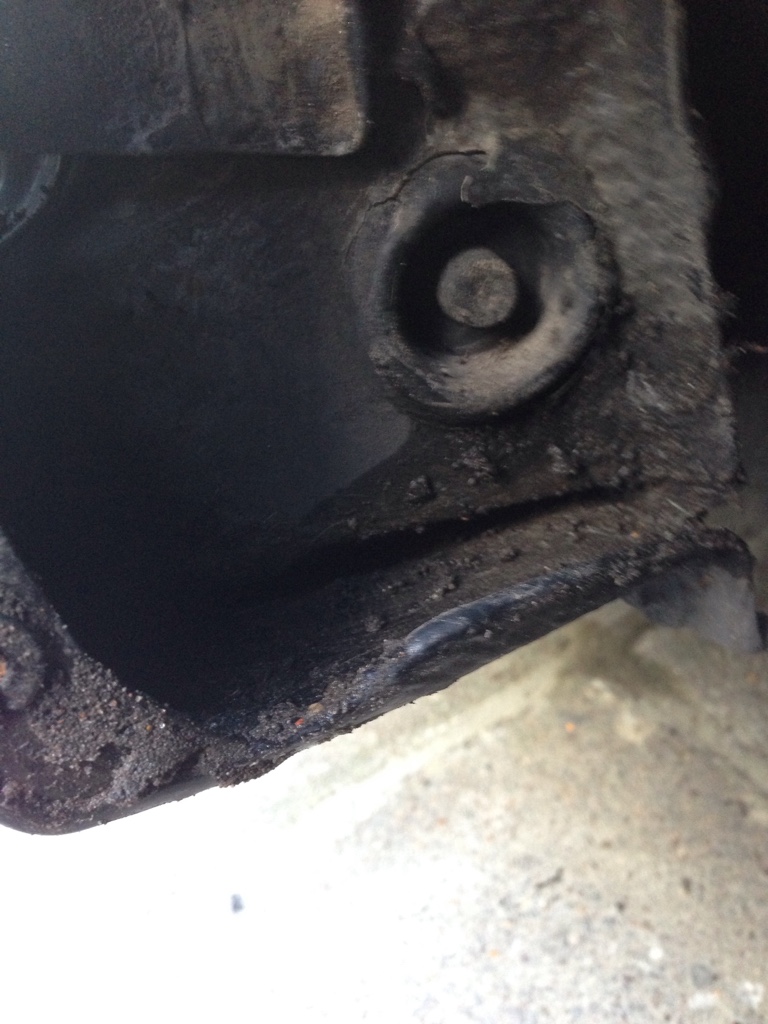

And some more...
The wheel arch is all clear too....
Any ideas guys.

I read all DJR's stuff before posting as i had this problem a year ago. No one seems to have the same problem as me either. Ppl are getting a little bit of water in and its tracking down, i have a lot of water pooled between the inner and outter skins. I had to get a straw earlier to suck the water out. 5 big mouthfulls before it emptied. If the car is designed to take water in here (which it may be hence the need for rubber bungs) then how is it supposed to flow out.
I would say water is not supposed to be there. Grommets and seals around cables and switches would be my bet as to the cause.

Isn't that grommet supposed to be covered by the plastic wheel arch liner? Mine has no exposed grommets like that. The wheel will throw water at that grommet and it will get past it as I know they are a pretty sloppy fit.
Or maybe you just pulled the liner away for the pic?
its pulled away for the photo. I needed to see if there were supposed to be any drainage channels in there.
Ah OK.
That grommet in the wheel arch looks "wet" underneath and then towards the bottom of the arch area. Coincidence? Or is it leaking out through it?
I'd check under the wippers grill. I've always had in there a mini ecosystem. The water was/is coming through the polen filter.
It is wet, i sprayed water in the arch to ensure there was no big chunks of silt clogging up drainage holes.

I stripped the passenger side out tonight to see if that side was dry or wet. That side is so dry i actually had dust on my finger, i pulled the carpet back a little and its damp to the touch which I'm not worried about too much as the amount of heat thats been aimed at the floor its bound to cause a bit of condensation between the sauna that is my car and the arctic conditions that we have in the South Wales Valleys.
So now I'm convinced that its a top down leak as opposed to a blocked drain. Question is where....

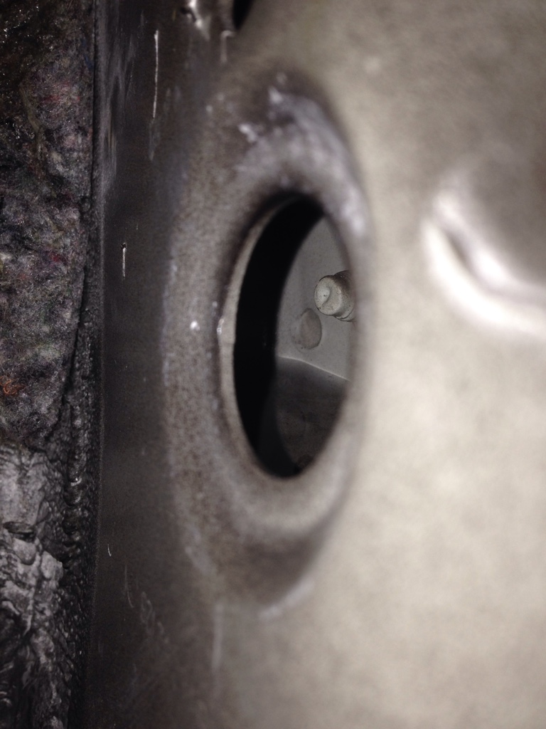

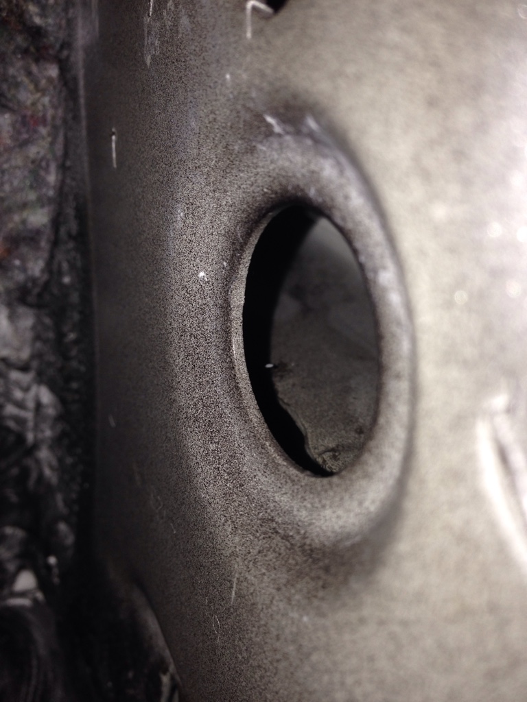

I pulled the bung out that's half way up the A piller and had a feel around and all appears to be dry (as much as i can feel) so the water may be coming in through the door stay, or may be coming form higher up i.e a weak seam somewhere thats perforated. Im just at a bit of a loss.

If it was me I would have checked with a mirror on a stick in the hole to see if I could see any blockages, shine a bright light up there and see if any light shines out, see if u can poke the drain hole out - or put one back in (if its missing)
