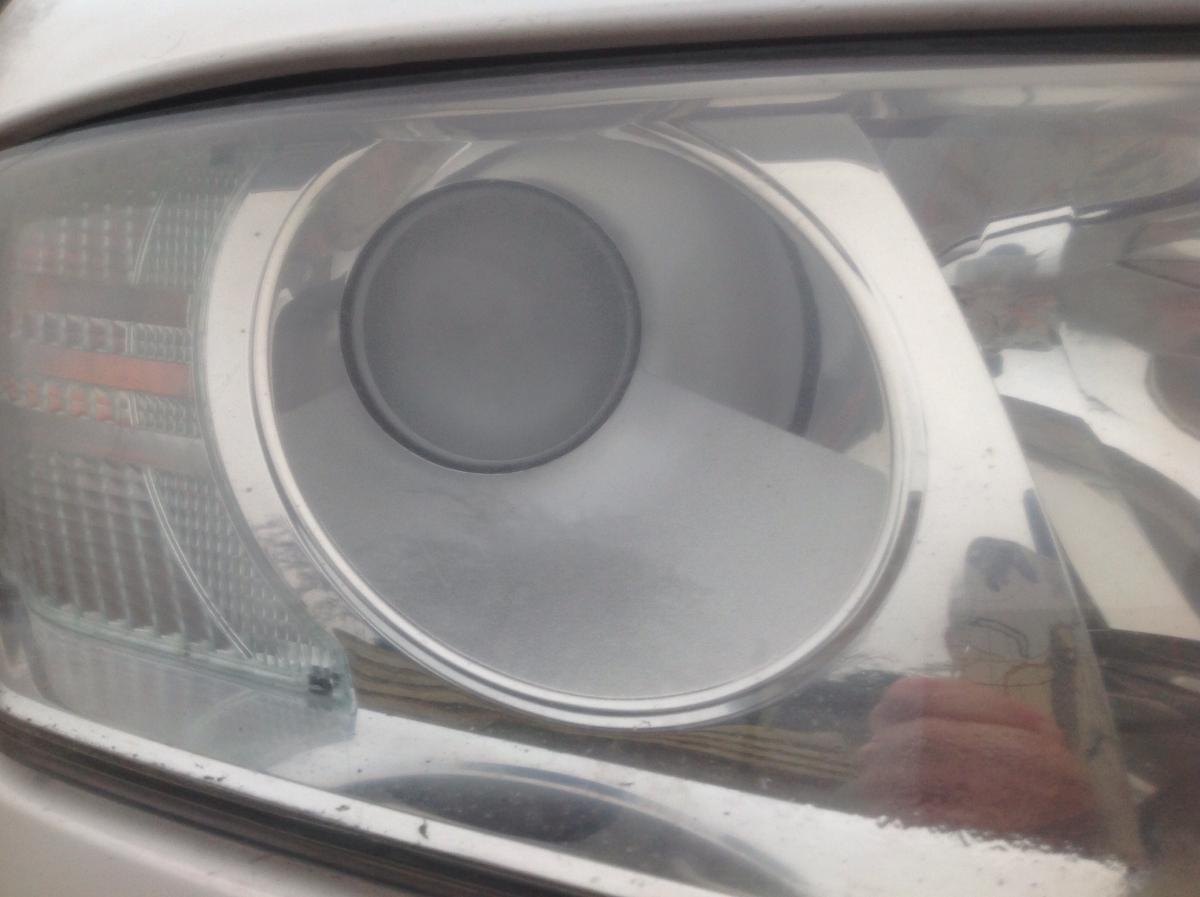

Sorry chaps, I forgot to say, yes it's an 05 mk2 octy
Soft scoop...I know there's that black cap on bulbs for glare, it's the chrome dome/cap thing in front of the bulb (dip), I know it'll probably be to do with glare but my other car's didn't have it, you just saw the bulb with nothing covering it.
I had hid in a mondy mk3, pug 306 and rover 75 and was fine, and tempted with this but it's this cap/dome thing that's putting me off
Does your headlight look like pic1 or pic2 below?
1:
2:

Ooh that shield. Im with you now :).
I somewhat misunderstood the first post haha.
Anyway, i wouldnt bother with hids. Its horrible to everybody else on the road
Softscoop....pic 2 and the bulb on the left ie dip, that chrome dome cover thing, I know it's for glare but honestly, the light is bloody terrible I was out last night for the first time with ordinary halogens and wondered if they were on, seriously, it's crap. The lens and reflectors are good and clear so it's not them
Ok I'm lost.
The light for dipped beam comes projecting out of the lens and has no "chrome dome". Behind the lense is a cut out that creates the defined beam cut off to avoid blinding other drivers.
The silver plastic infront of the projector lense is purely there to catch the light so it's easier for others to see your headlights, otherwise you'd just have a lense that looking at from anything other than beam area wouldn't show anything.
You can put HIDs in the projector type lights in a mk2 Octavia and vastly improve the light output without blinding others.

That dome is the projector part of the light, you cant remove it
This.
Thats a projector light that you have.
I know, but I feel it's not letting enough light out, but I know it's the design, I just hope that if I put hid in, it'll be better, because it's seriously dangous on country rds, especially when car come towards you as you have the high beam on. I've honestly never had a car with such bad lights, well dip anyway
Hids will improve it and its okay to put HIDs in projectors.
