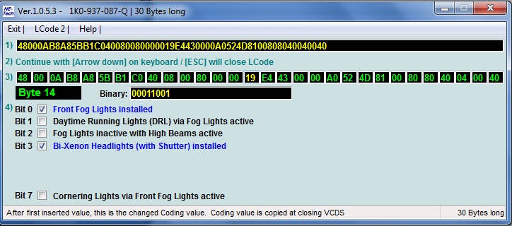

In byte 14 there is an option for bi-xenon (with shutter) installed - bit 3.
When ticked the car reports no bulb failure of any kind :sun: with the old ballasts installed.
Unfortunately, whilst this works, gives no errors and the headlights work perfectly it renders the LED DRL / SIDE LIGHT unit on the vRS inoperative for DRL or side light function :bandit:
BUT.... if you manually change bit 4 from off to on (from a 0 to 1) instead, then the LED DRL / SIDE returns to normal operation and the car does not show a bulb error at all!!!!!!!
With this coding i have tested operation of all lights and all is good, old ballasts that showed up an error instantly without the need to be switched on work perfectly with no bulb failure.
^^ So, In fact they do work

What we need on VCDS is this (note new bit 4 and modified bit 3) best thing to do is list your model year, ECU number, and whether it has been successful. i
If we get a few different people who fit ballasts and get errors, then perform the coding change and are error free we can send the info to ross tech who can look and research into adding the label to VCDS.
Mine first
Build date = 06/2012, ECU = 1K0-937-087-AD, Byte 14 - bit 4 CONFIRMED WORKING

BUT.... if you manually change bit 4 from off to on (from a 0 to 1) instead, then the LED DRL / SIDE returns to normal operation and the car does not show a bulb error at all!!!!!!! (Xpower)
By manually change, do you mean change the binary code directly? (Change 10000001 to 10010001 in that actual box? I'm also assuming each digit represents each bit) Also your 2nd screenshot, did you change that with VCDS?
Correct when the Bit tick box is not present you change the Binary code itself (just remember Binary is written from right to left, so Bit 0 is the furthest digit on the right)
Ah! that makes more sense, right to left :doh:

Yeah, just to confirm this screenshot is a mockup and not real, just made with paintbrush :-)
As its been said, you can just manually change the binary code next to the byte number
Mine was changed from 10000001 to 10010001
