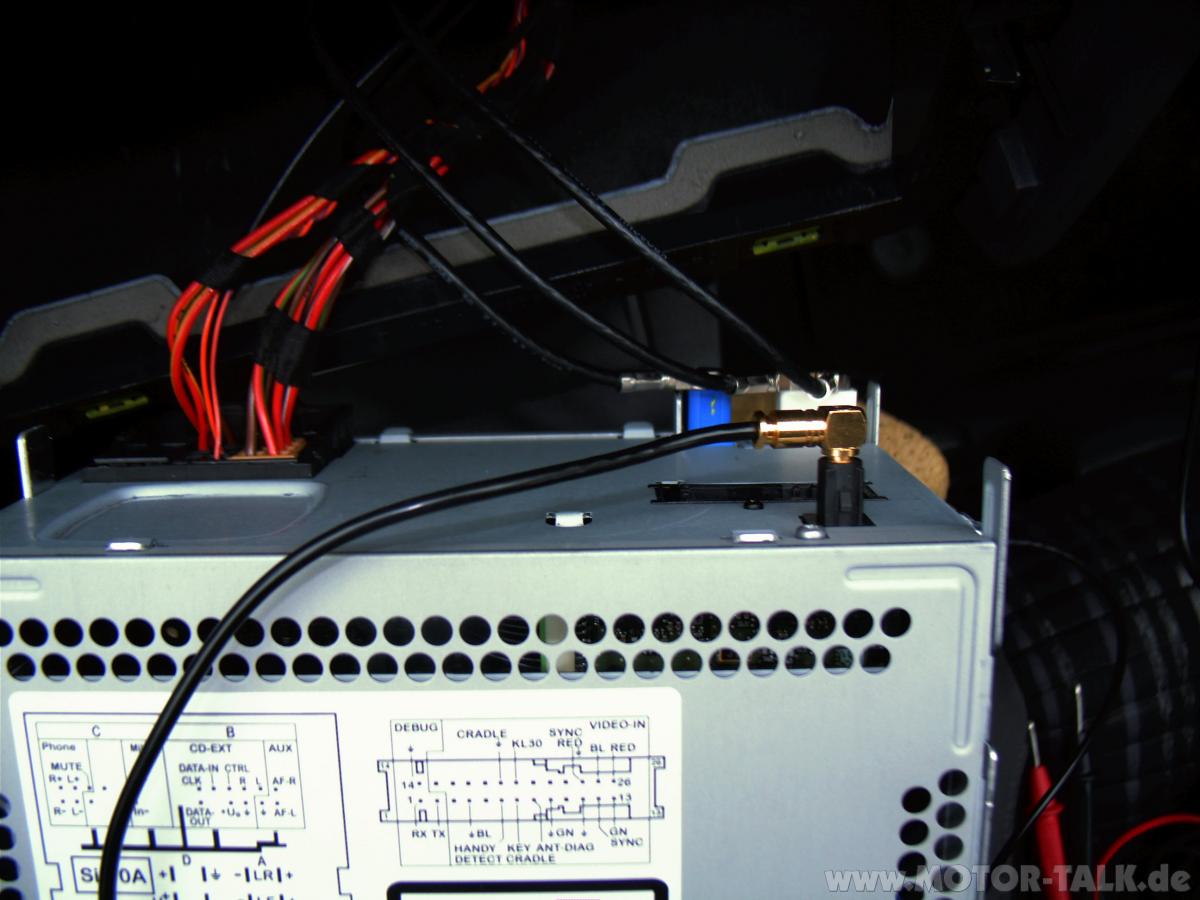

For the DAB take an extension with two female fakra connectors. But try to get a SMB one on the side of the radio.
Like this one (it is a short extension, because my 6m extension had a female (antenna side) and male one on the radio side).
You will probably need the 90° version (the SMB is 90° and will fit into the radio without any problems. The only difference is the plastic housing of the fakra ones)
In the Roomster I did the same conversion (having DAB/BT now) and the straight connector would touch the rear of the radio housing in the car, bending the cable.

​The same seller also has the extension cables, just try fakra gsm (the one you dont need, unless you also get an active cradle with antenna connection), fakra dab, fakra gps.

So it seems that fakra connectors are the same as SMB, and there may be a need for a 90 degree angled connector at the radio end. Has anyone found that to be the case in an Octavia, mines a FL Adam, so hopefully the existing FM is fakra.

It is the upper connector that causes a little problems when placing the head unit back into place.
At least it is in the Roomster.
