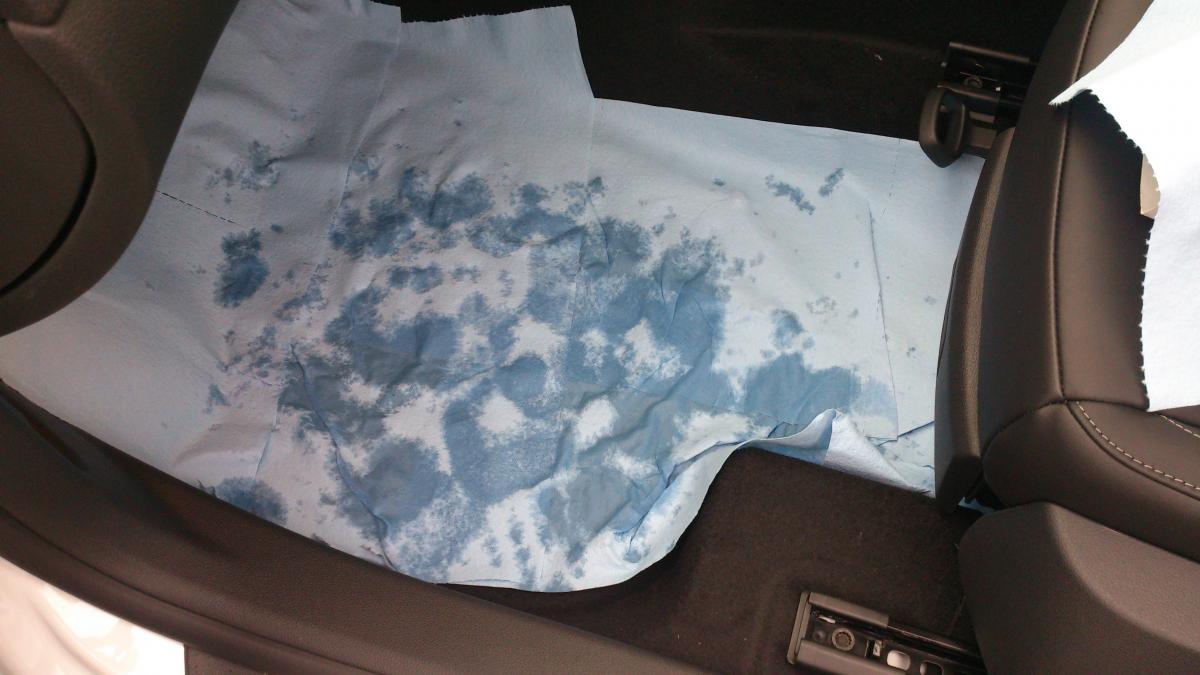

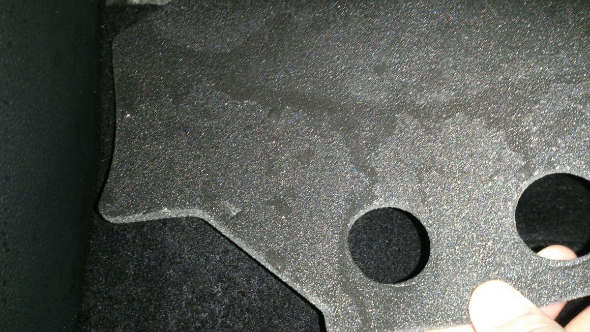

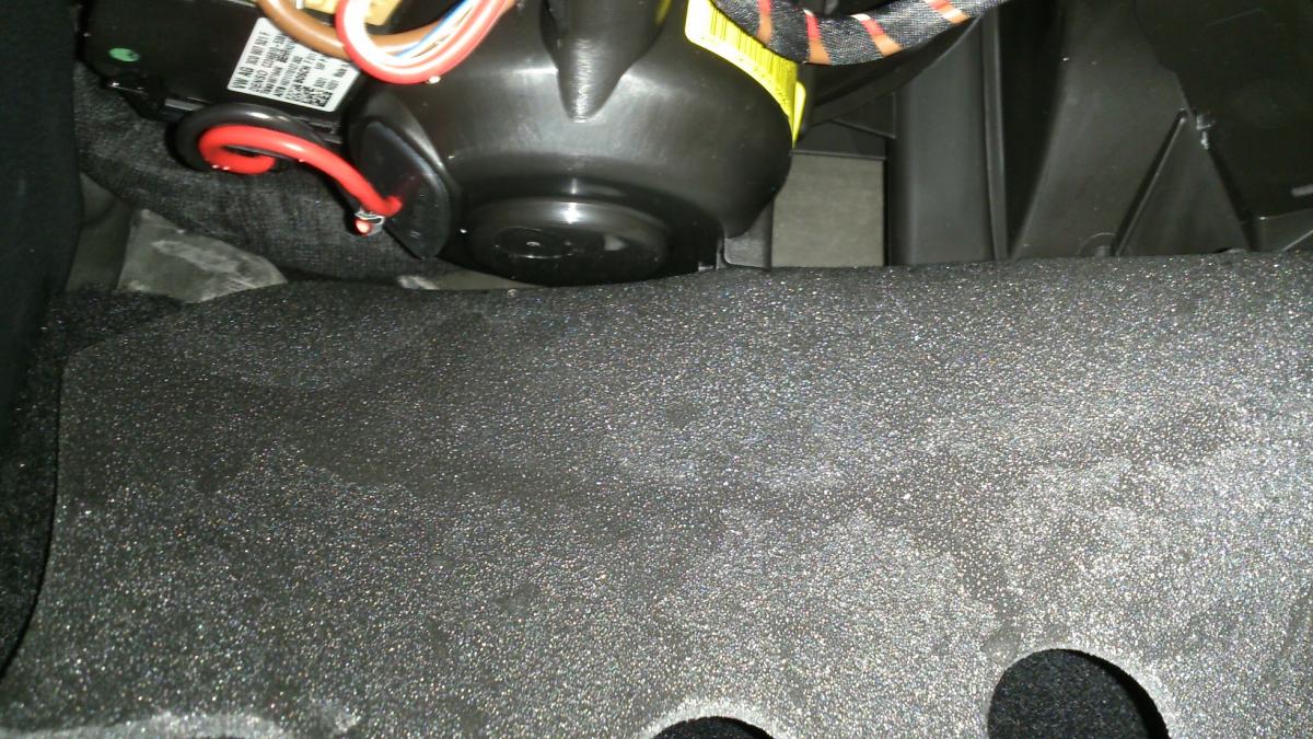

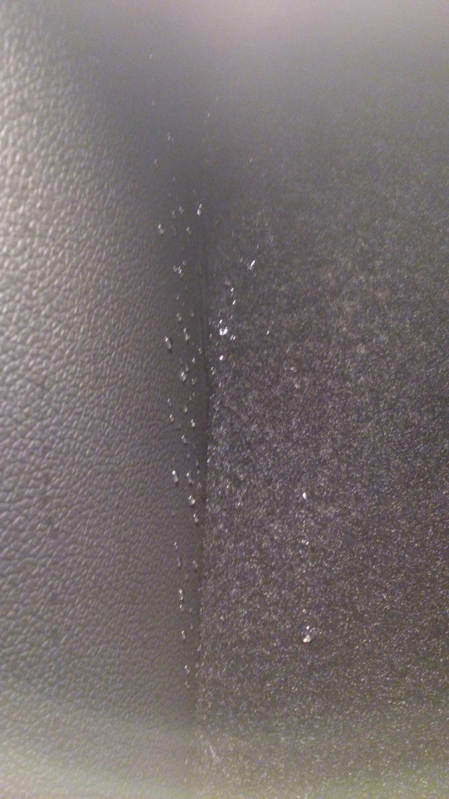

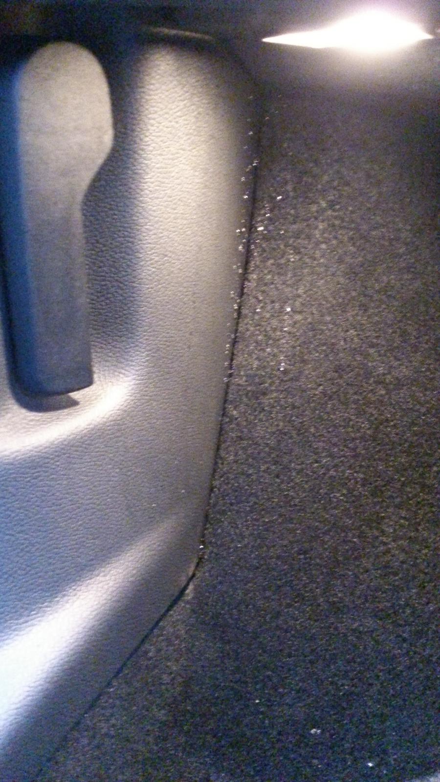

Like the title says, last Sunday I took delivery of my new car, Skoda Superb, from Vindis Skoda Cambridge. Yesterday morning I've noticed water drops coming from underneath the glove compartment and checked the carpets and turned out to be completely soaked. So I immediately went to my local dealer in Southampton (Sparshattsgroup Botley) to book it for diagnosis.
I've asked them if this is a common problem with Superb or is just my luck and I've been told that this is just my LUCK. I also asked if it's OK to drive as there seems to be water near electrical wiring and I've been told that there are no risks.

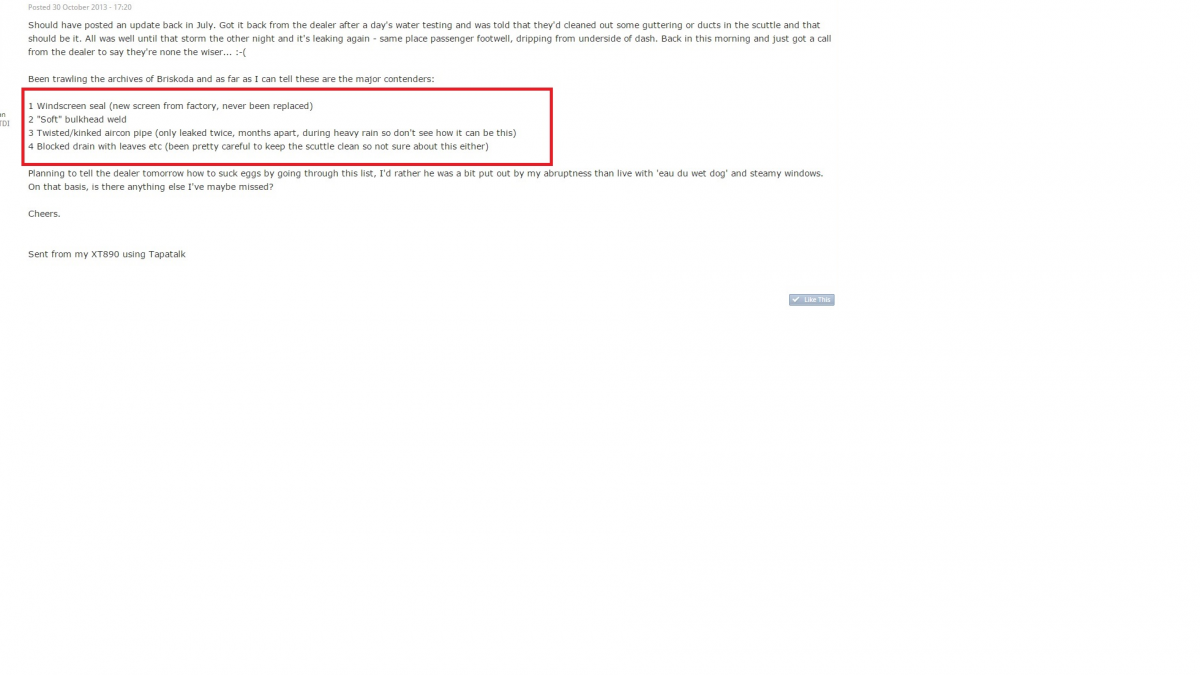

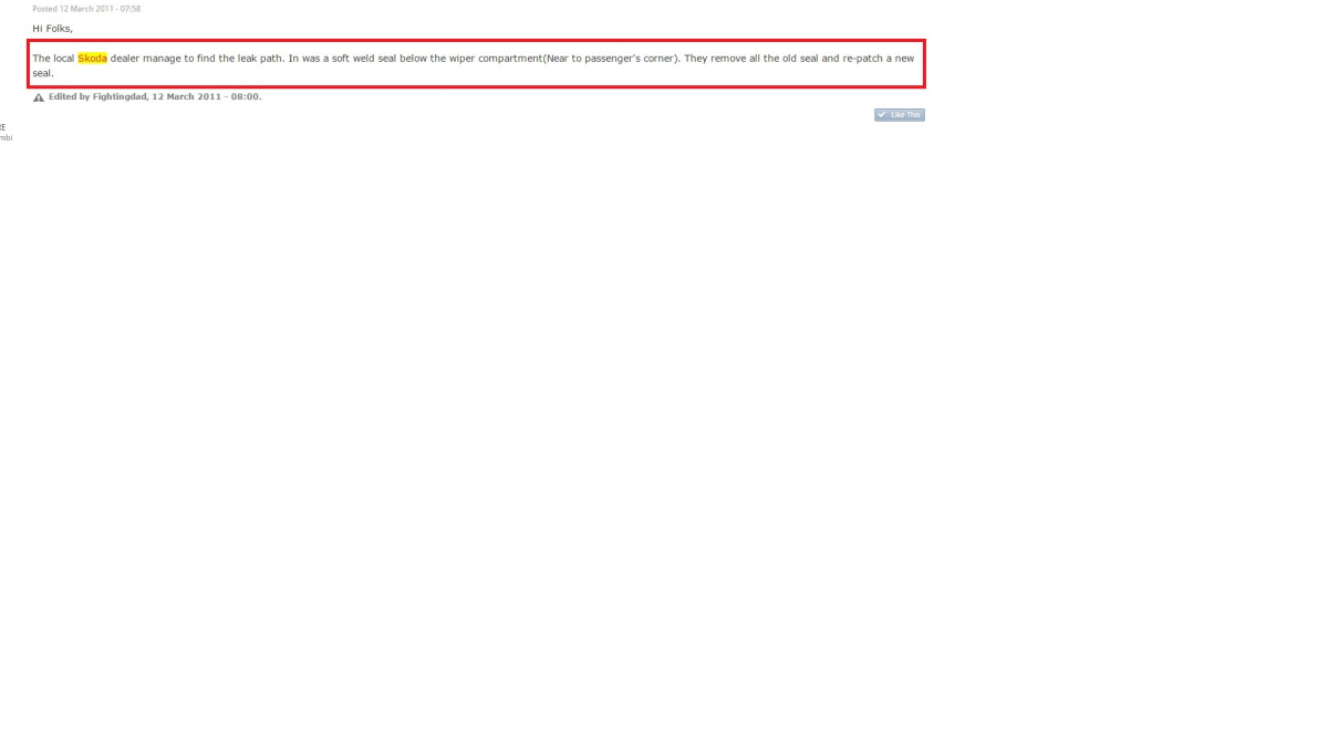

I booked in for Monday morning came home and I did a bit of research on Briskoda about this issue. As you can imagine it turned out that this quite a common issue with the Superb II as well as with the previous model. Also mailed Vindis Skoda about this and they sent me the following email:

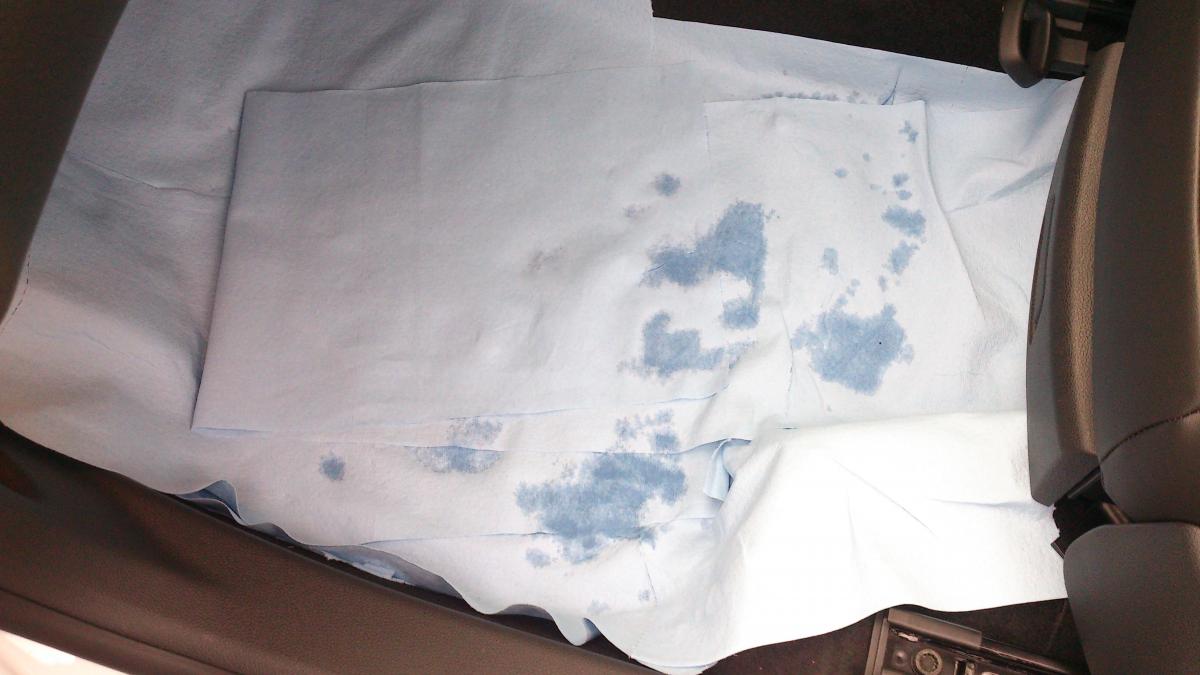

Having previous experienced unpleasant relationships  with car dealers I know that I have to document and record everything, from phone call conversations, emails to pictures and video footage in case if things go really bad.  So here are some pics and video to show the extent of the problem.

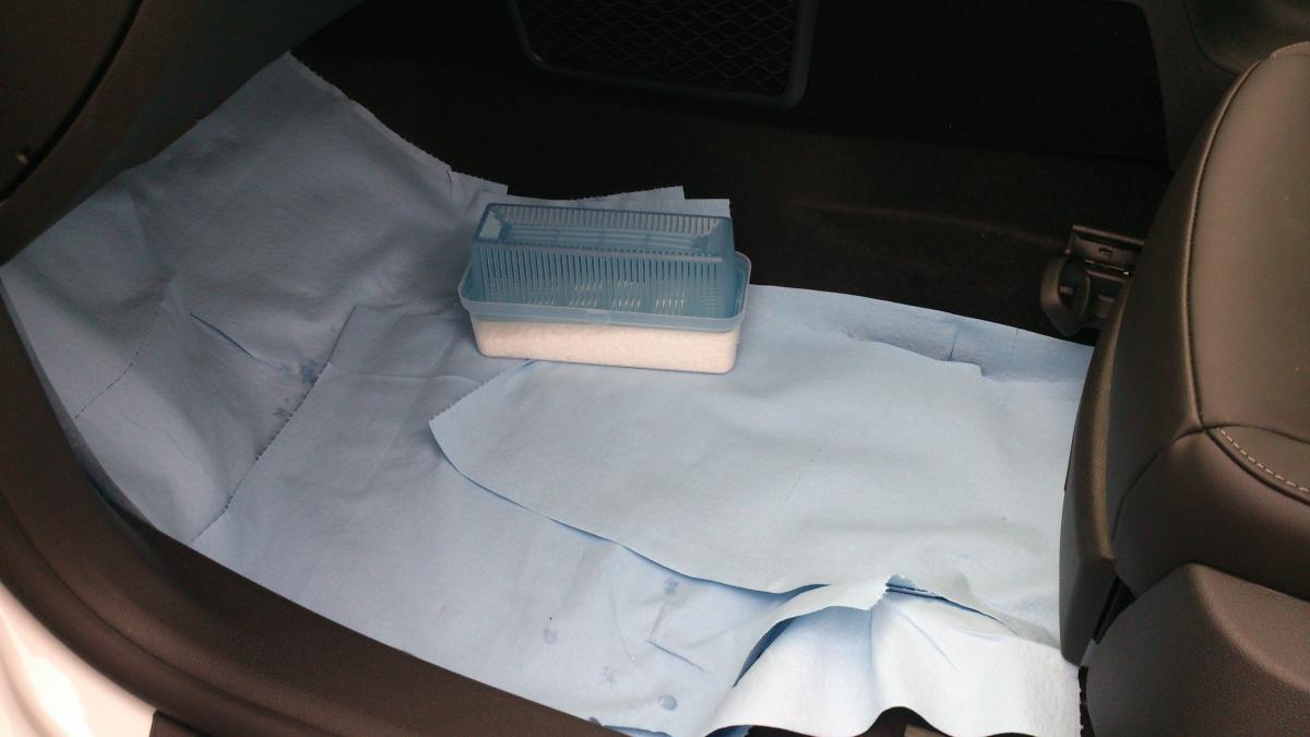

I also decided to limit any possible damage:

Do you have access to a dehumidifier? If so, whack that in there and leave it on for a few hours (if you can safely of course).

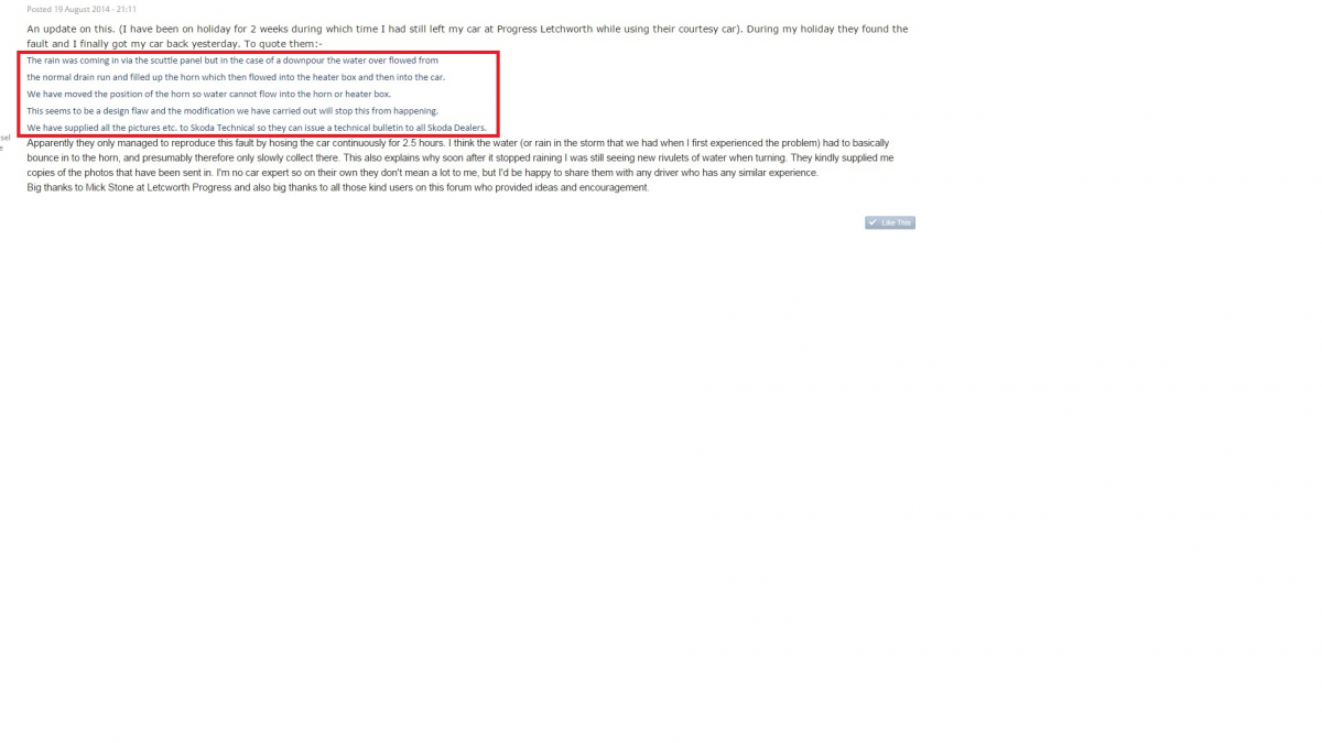

As for your water ingress issue, I had the same water leak area on a 2009 Superb, took it to my local garage who 'have never had that before sir and cannot seem to replicate it with testing'  There is a problem with some cars, not all, just the luck of the draw. But I feel your pain and would be well and truly annoyed.
My theory as to how the water gets into the car is through the air intake for the heater, this is higher than the scuttle plate and if water sits or the car is parked on certain angles it will run into the car.

I don't have access to a dehumidifier, that's why I bought a moisture trap. I just hope there won't be any funny smells because of soaked carpets.

I have no idea is behind the glove-box. I'll check tomorrow what exactly is there, I suspect there is the fan blower or something like air conditioning unit.

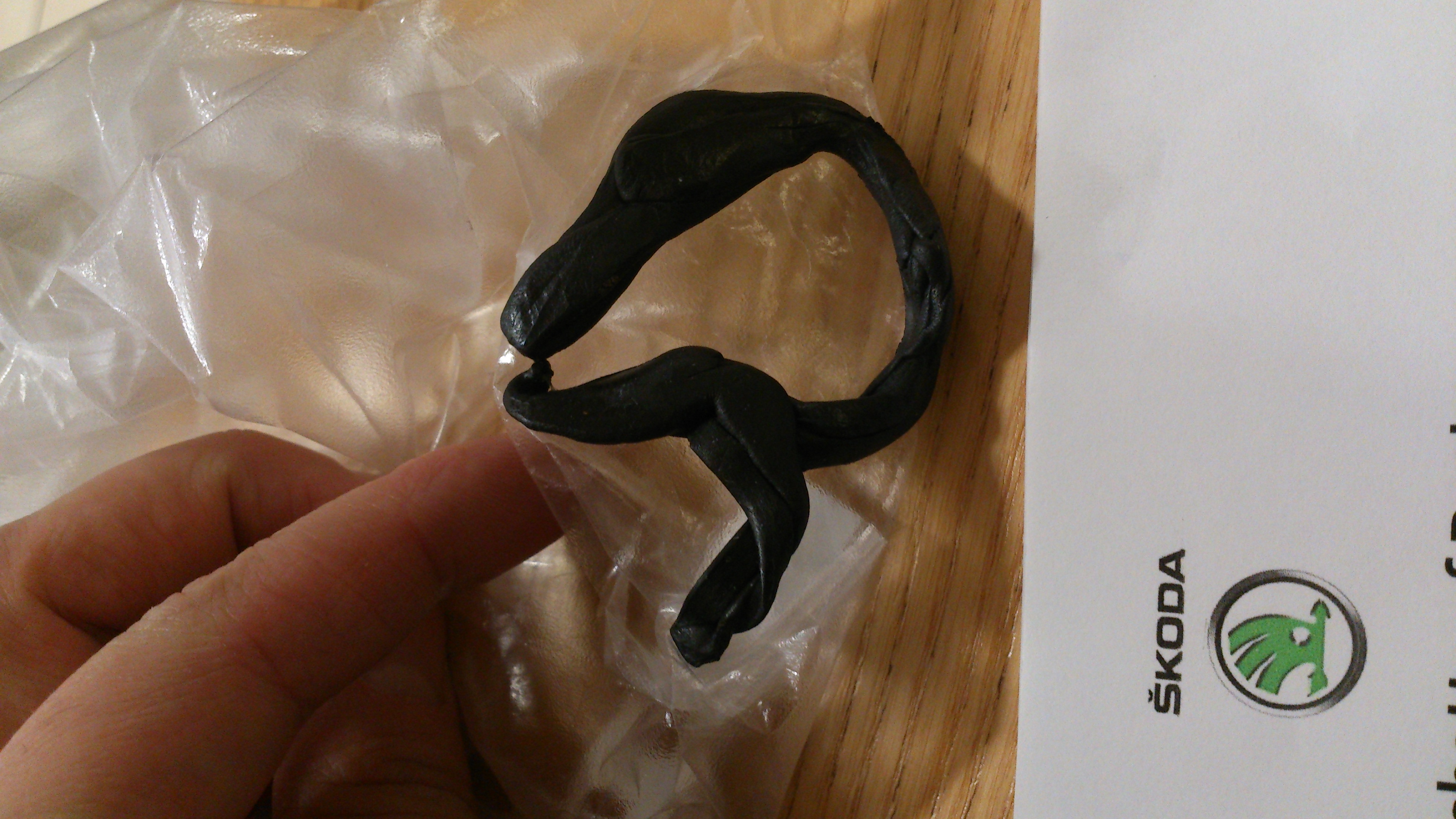

Just been called back by one of the technicians and asked if I had been caring out any sorts works to fix this problem, as he noticed that there is a piece of 15 cm of windshield sealing hanging. I've asked him to take some pictures and he has agreed. Once I have those pics I will post them here, most likely tomorrow.

Just been called back by one of the technicians and asked if I had been caring out any sorts works to fix this problem, as he noticed that there is a piece of 15 cm of windshield sealing hanging.....
Yeah, that's right, I do that sort of thing to try and fix a windscreen leak in a brand-new car....

I attach a picture if the hanging sealant. The garage didn't wanted to give it to me as he has to send it back to Skoda.
