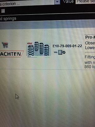

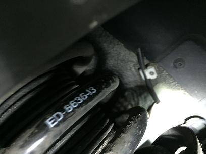

If it's the 1.2tsi that kit is wrong I'm afraid just like mine. I've been onto Skoda since May about this and my dealer too. They're hardwork. The kit that Skoda supply is only for the 1.4dsg and 1.6tdi as they have a front axle weight of 960kgs. The 1.2 has a weight of 880kgs. The rear springs are the same. I've been on to Eibach UK and they have confirmed the same and told me they supply the kit to Skoda who then re number it. I gave him the number off my front springs and he confirmed they're wrong for the 1.2.

All of my records and case is logged with Skoda Customer satisfaction,Parts Technical and there Warranty dept.I have nothing in writing but my dealer has all relelvant information and photos showing its difference in measurements.
I have the photos i took with the part numbers i found on the front springs which are Eibach numbers.If your numbers are the same then they are wrong.I also have the correct part number from Eibach which is correct for the 1.2tsi.
This is Skodas kit part number which is incorrect: ZGB 5JA071676
Eibachs correct kit part number: E10-79-009-01-22

As far as Skoda are concerned there is no mistake. I'm awaiting the outcome hopefully next month when it has its first service. The Eibach kit is £199.
Mine was done as a bribery goodwill gesture from Skoda as I rejected the car a few months ago (long story). They have to re number the kit as obviously they can't use an Eibach number if they're offering it as a Skoda part. There Parts Tech dept are saying it covers all models ranging from 880 to 960 kgs weight. Shows how little they know when Eibach list 2. I've been trying to drum this into there thick skulls for months and also Bickerton Skoda who run Skodaparts.com have had lots of problems with this kit too. He now orders direct from Eibach. The more people that complain the better as far as I'm concerned. I'll be onto them tomorrow again about this until I get an answer. I have told them I will take it further if need be. They simply don't care.
