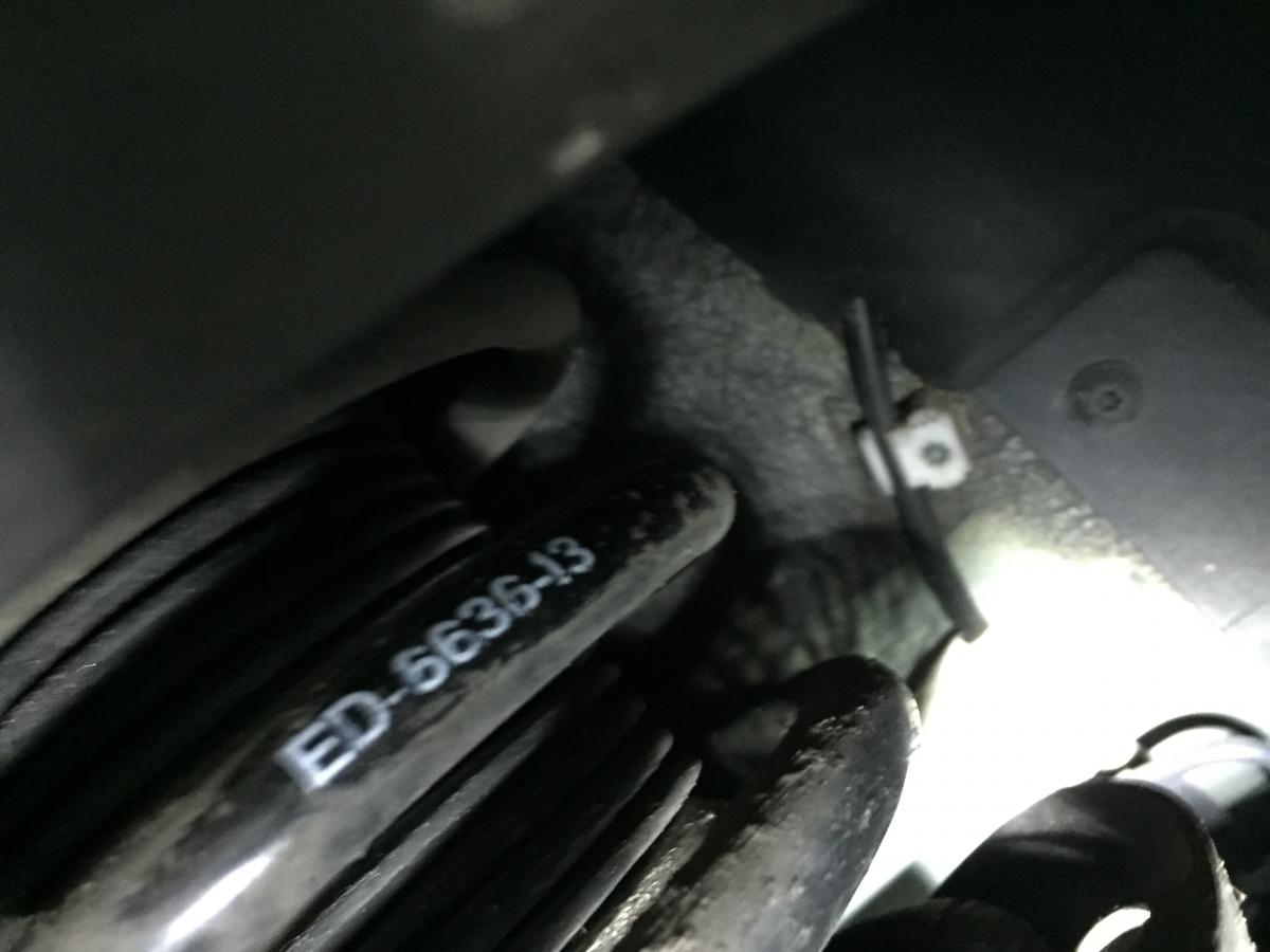

If you got this number on your front springs for a 1.2tsi then they're wrong.
I'm going to check mine now you say it's wrong, but can you explain why it's wrong and why Skoda fit the wrong springs? What problems if any will come of fitting these springs. My car sits nicely front and back, it doesn't look too high at the front, it drives better than it did and Skoda honour the cars manufacturers warranty and a warranty on the springs they fitted.
I've been investigating this with Eibach and Skoda.
The part number in the picture is a recognised number that Eibach supply to Skoda for there spring kit. This part number is for the 1.4dsg and 1.6 diesel models and not for the 1.2tsi. It's a stiffer spring due to the weight of the 1.4 dsg and 1.6 engines being heavier (960) and the 1.2tsi being only 880. The rears are all the same listed. The front springs for the 1.2tsi are softer because the engine is lighter. Like mine I have measured the rear arch gap after fitting and it's 40 mm whereas the front gap is 60mm. It's quite noticeable at certain angles. The rear of mine is pretty planted on the road but the front feels vague and unstable. This is what I'm trying to drum into Skoda UK thick skulls at the moment. There kit is wrong and Eibach are correct. If you have a 1.4 or 1.6 it doesn't matter as the kit will be right. Mine were fitted as a goodwill gesture so I'm trying to get them to fit the right ones. It looks stupid tbh.
