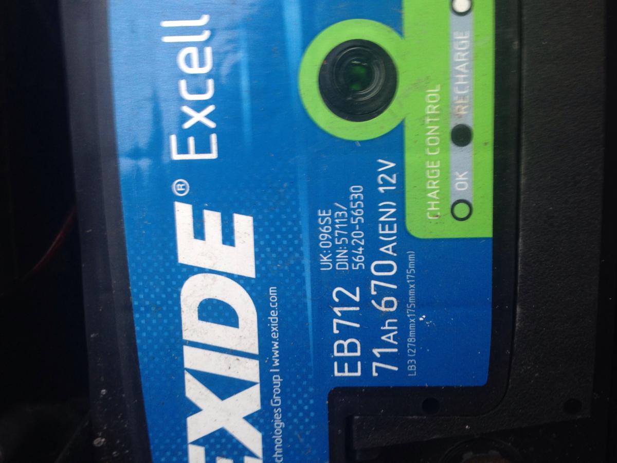

Just while I'm waiting for new temp sensor to arrive and what not. I thought I'd retrace my steps as its better than just sitting and wondering.
I assume this is the correct battery for the car.
Also I don't know if it is a fuel issue as when the car starts load of grey/black smoke comes out the exhaust. If it was petrol I'd say spark plugs hands down.
